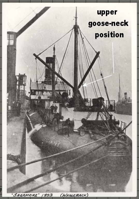

still steadily working forwards....
when the Sagamore was alongside -- discharging Cargo--the cargo-booms
were located to the ' upper' hinged gooseneck fittings

When the ship was at sea .the whaleback rounded main deck was often awash--especially when fully loaded,
hence the cargo booms were stowed in the 'lower ' position so as to form a Catwalk,( as per Windjammer Sailing ships)
in order for the crew to be able to move between the ' turret' structures without being washed overboard
the cargo booms were set up as twin booms had stanchions-and-cable railings to facilitate
a degree of safe transit
