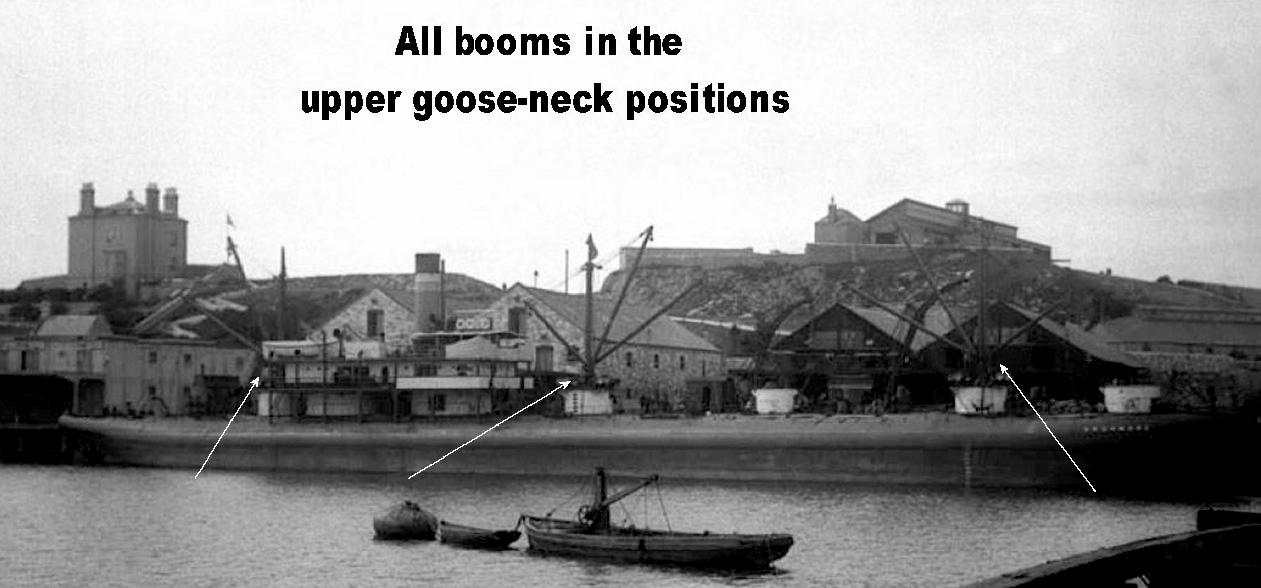

still steadily working forwards....
when the Sagamore was alongside -- discharging Cargo--the cargo-booms
were located to the ' upper' hinged gooseneck fittings

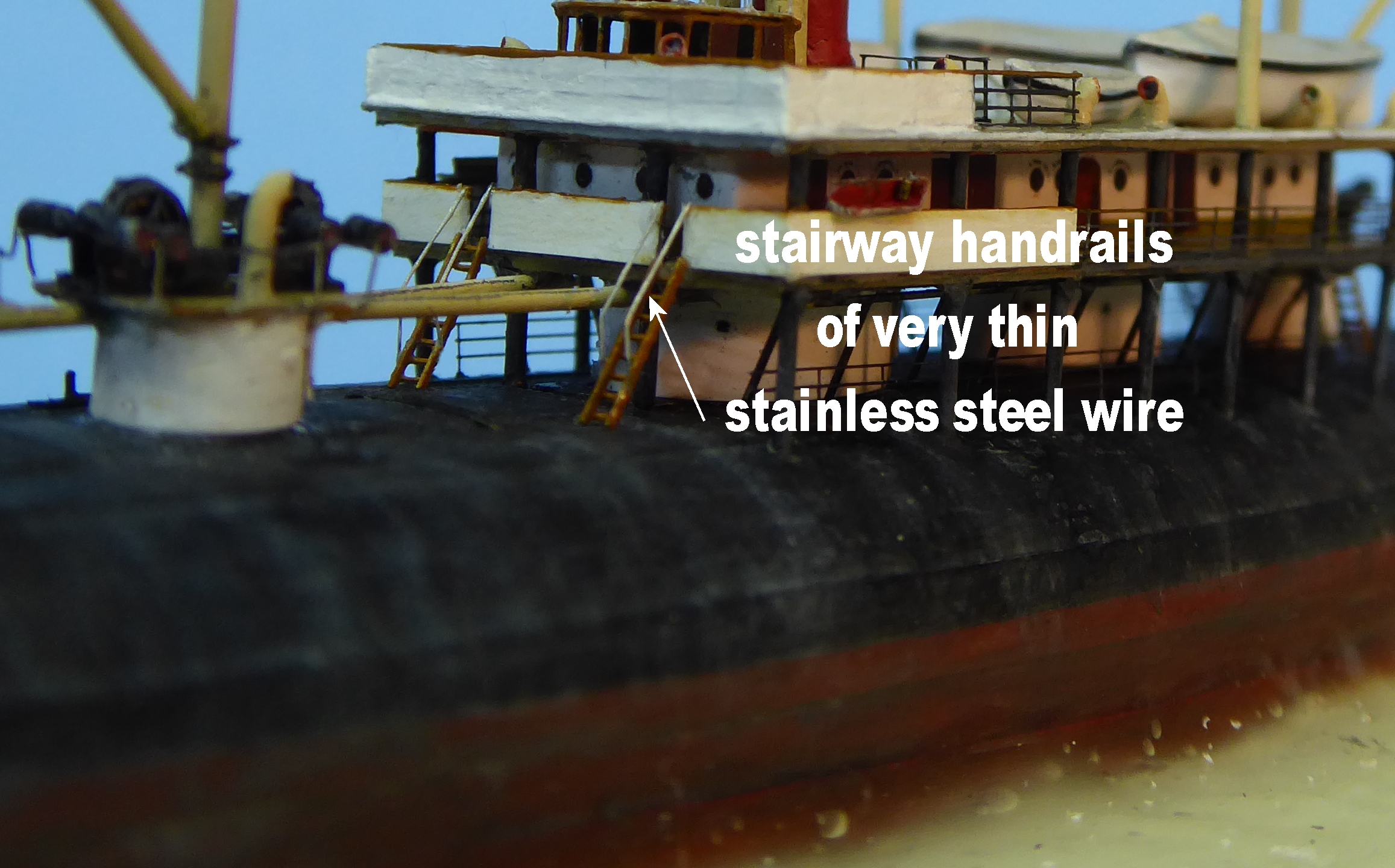

The stair railings were made individually of very thin stainless wire-- much thinner that usual stair PE handrails

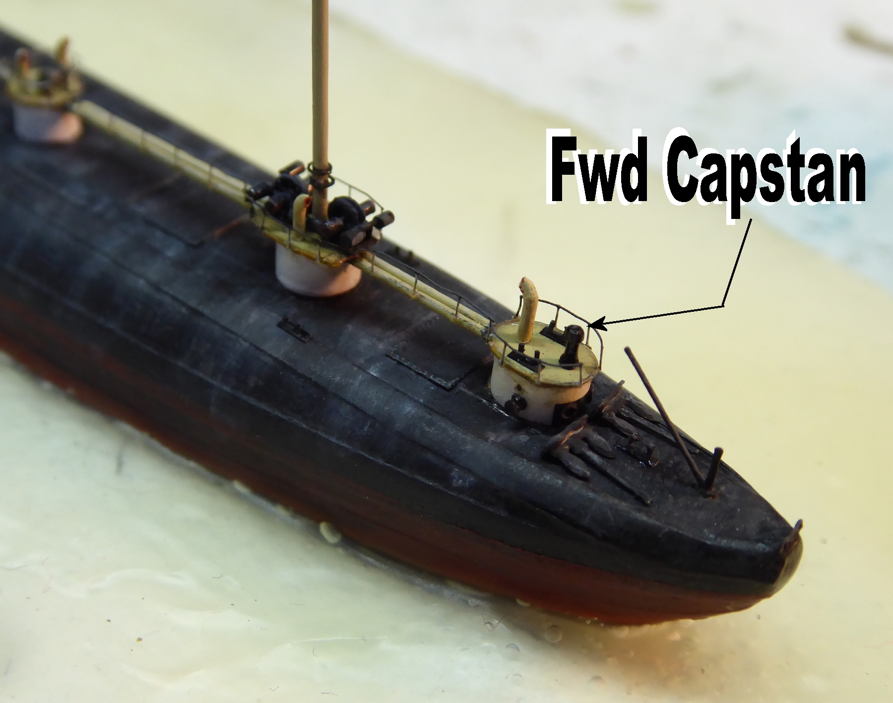

The ship carried two capstans-- one fwd and one aft
the fwd one was taller these were made of tube and very small circles of wire

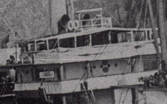

I must say that on the real ship the ' set' of railing dodgers
seems somewhat lackadaisical ...!!
I think the ' tattiness' it is because the corners had triangular panels that could be raised--and are often dropped
in addition....the entire panel could be raised it seems ( alas not a great deal of visibility or elegant! )

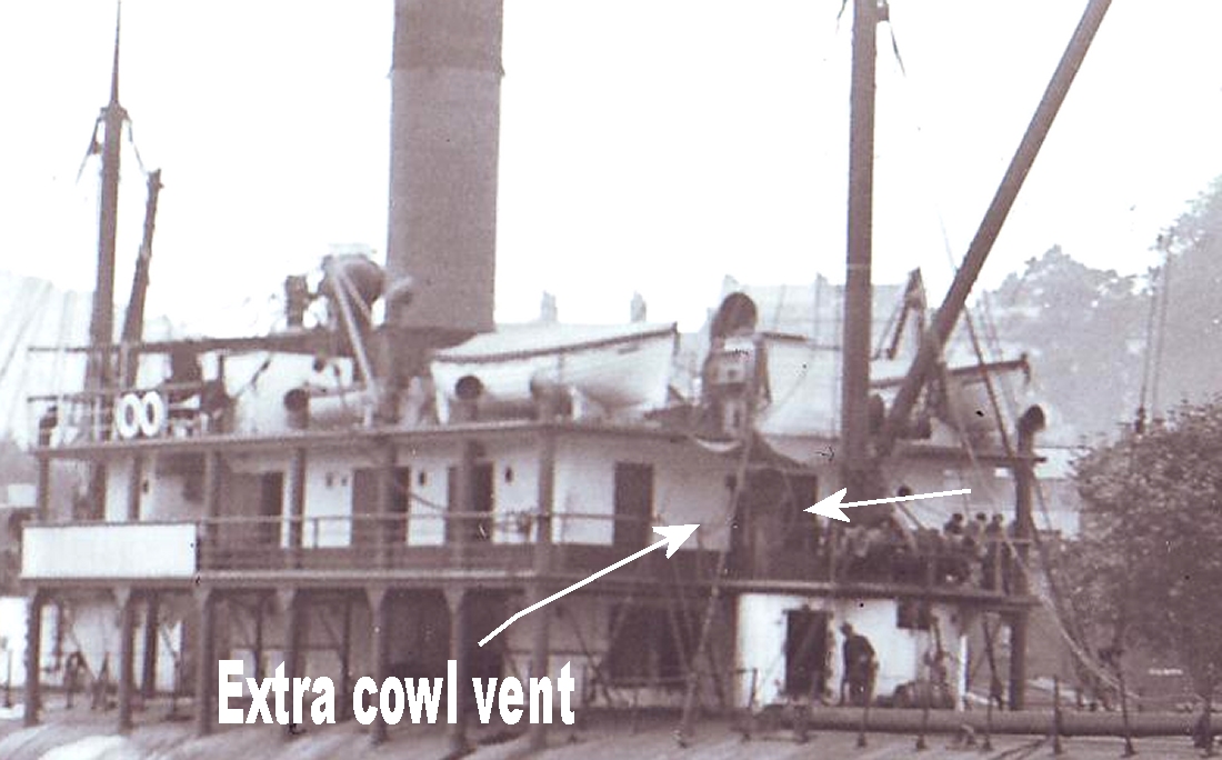

whilst studious of the aft end...
I discovered and extra cowl vent !!

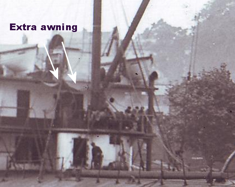

whilst at the aft end I noticed this little awning
which I think I shall add as it will brighten up the aft end a little
