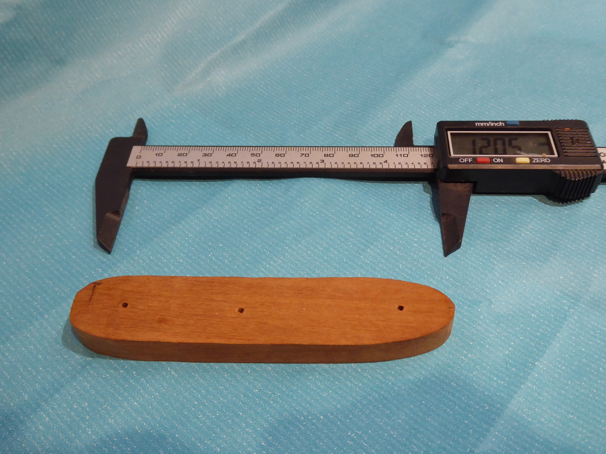

.... Sooo.... where to start...?
Fortunately there are some EXCELLENT plan resources on the internet-- giving reproductions of the original drawings, sail plan and deck layouts etc
I have the drawings at near full size... 15000 pix across
and now also and scaled to 1/700! == giving an ON-DECK length of 12 cm = 120 mm or 4.74 inches :big_grin:

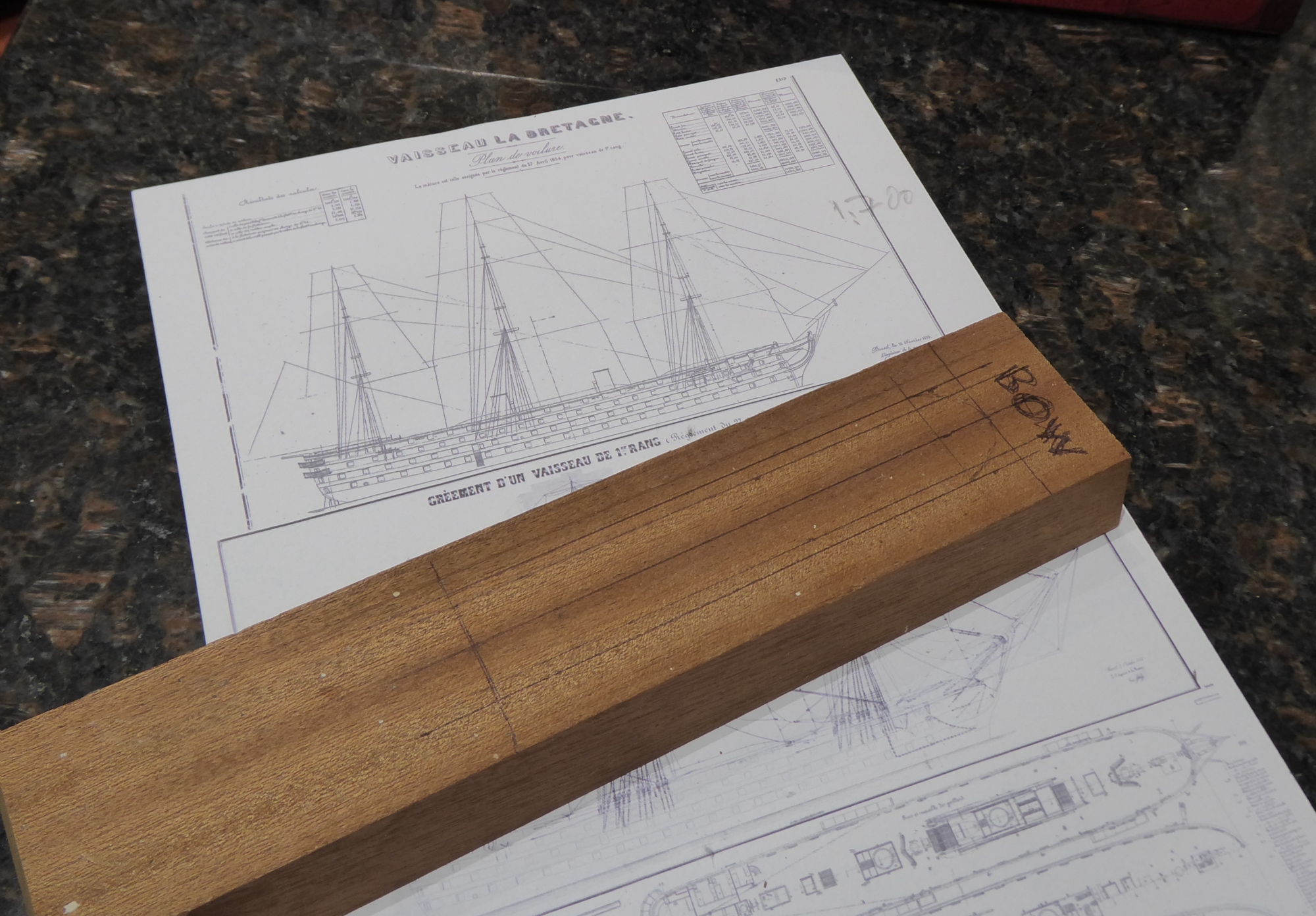

So my plan of construction is outlined below... please comment if you see a flaw in my thinking! :wave_1:
cut hull blank in Jarrah , fore and aft , sheerline to weather deck & waterline width only
Bretagne dimensions are given as WATERLINE length-- ergo
120 mm on deck( allow extra 0 .5 mm for additional sanding )
Sstick on ( Pritt!) printed scale side elevations ( as per plan and flipped)
Centre-mark/prick all the gunport centres on the ( near parallel ) sides
(but not yet extrapolate around the curves bow and stern! )
Drill through 5mm DEEP with a thin pilot drill. ( I bought a fine miniaturised Pillar drill
and adjustable machining table clamp to place the model under the drill ( more ) PRECISELY!
Create the tumble homed hull and undercut bow using negative athwart-ships templates
Form the bow and stern - and extrapolate the positions of the apertures fore and aft using photos and plans
Drill open the small pilot holes to the diameter of the gunport OUTER frame sizes 1.5 mm deep
( each row is different size gunport! )
Cut and form square-ish corners with a No 11p scalpel -- insert brass squares cut from my huge stocks of
old-overscale-square-aperture-ladders PE glue in and secure with CA
( as done before on 1/700 Jeanne d'Arc--except this time it will be much better! )
Run automotive stopper ( ultrafine filler as used on classic cars! ) over the gunport rows
Fine-sand until the brass , wood and filler are uniformly smooth
Form decks, bulwarks , gratings , Fore and aft raised decks, hammock stores funnels, bridges, stern walks, masts, spars and sails
this should see me through to March.... :big_grin: :big_grin: :big_grin: :big_grin: :big_grin:
