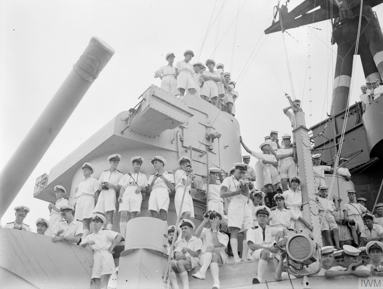

Another question:
What is the accepted deck colour for around the conning tower? the level where the 40mm Single Pompoms, later the 12,7mm MG's were located pre-AA refit?
Is it just darker grey metal or some wood or even Linoleum?
This photo shows that level I think it was called the Conning Tower Platform:

TZoli wrote:Another question:
16_inch_gun_turrets_and_Unrotated_Projectile_launchers_on_HMS_Nelson_1940_IWM_A_1994.jpg
If you ask me: I would say Dark Grey painted metal. No Linoleum (Corticene!) for sure, then you would see brass strips to hold these down.
In theory also Semtex could be used, but I never read anything about Semtex on Rodney or Nelson.
Roger Whittaker +9/13/2023
TZoli
Posts: 209
Location: Hajd�szoboszl�, Hungary
Re: Calling all HMS Nelson & Rodney fans
Post by TZoli »
Thank you, I will fix my drawing than.

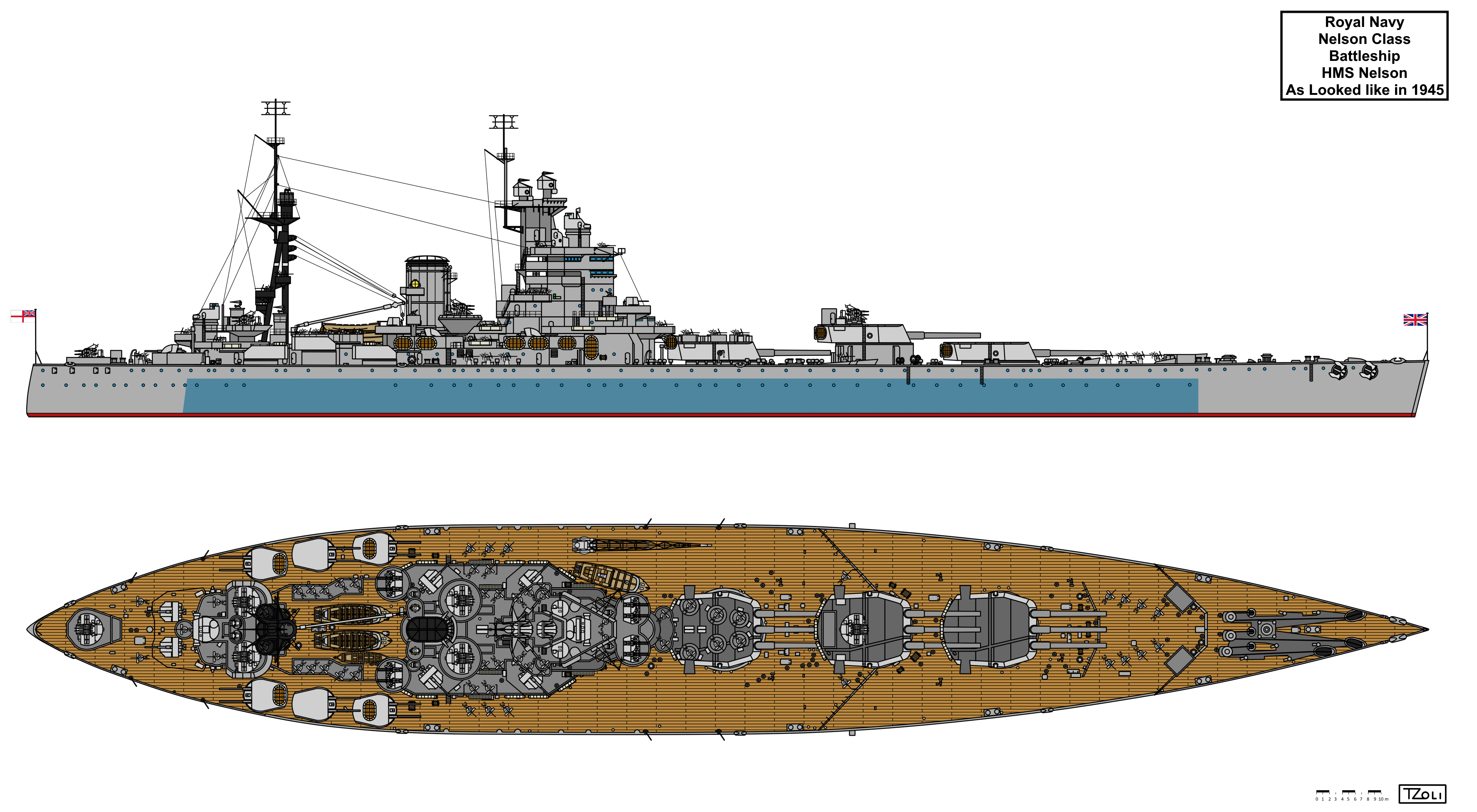

I think I've found the missing Pom-Pom director positions:
In 1933-34 two octuple Pom-Poms were fitted in place of the Torpedo Director Towers abreast the funnels.
It does not state where did directors for these mounts were placed but I think it was on top of the bridge behind the 6" Director Control Towers
In 1940 an octuple Pom-Pom mounting was installed on the quartedeck and two in place of the aft 6" Director Control Towers. Again no statement for their directors placement
In 1941-42, an octuple Pom-Pom mounting was fitted on top of B turret
3 Mark III directors were also fitted: two on the mainmast and one on the aft end of the shelter deck I presume either on the platform just aft of the main director where the later aft 20mm Oerlikon will be. Also apparently 4 barrage directors were also added at the aft end of the superstructure, abreast and abaft of the mainmast, I think this was the location on top of boat storage structure and the aft platforms on the mainmast.
In 1944-45 refit at the Philadelphia Naval Yard, Pom-Pom directors were removed to provide space for Oerlikons so I presume the bridge superstructure ones the centreline aft one and the ones on the mainmast
Also I've made drawings of Nelson's 1945 and 1942 state I hope the colour scheme is correct:
1942:
1945:

Post by EJFoeth »
For the camouflage pattern I'd like to refer you to the latest versions using the paints available at that time.
Now, both Hood and Nelson were originally fitted with two Mk I pompom directors and these are very small; Hood's director was high up in the main structure and nearly impossible to spot in any photograph, so early photographs are not of much help. One source also mentioned Nelson was later fitted with 5 Mk IIs, however, my radar book in indicates that 4 type 282's were fitted in March 1942 (and these are fitted on pompom directors).
This image (April 1942) shows two of these radars, just in front and just aft of the main mast?
I find two just aft of the main mast, in front of the aft DCT, see type 282 antenna
For Rodney: in the main superstructure
It's not uncommon that a pompom did not have a director; for the KGV-class the logical location for the fwd pompom in B turret was between the fwd HACS directors but were not always placed.

I've made new drawings and updated the previous ones:
Nelson class as finished in 1927:
In 1936:
Nelson in 1940:
Nelson in 1942:
Nelson in 1945:
