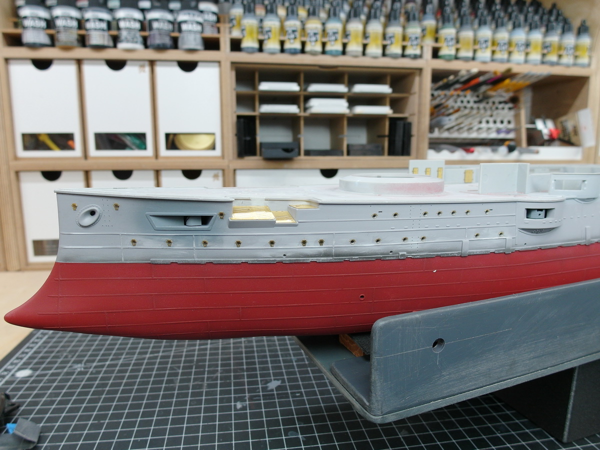

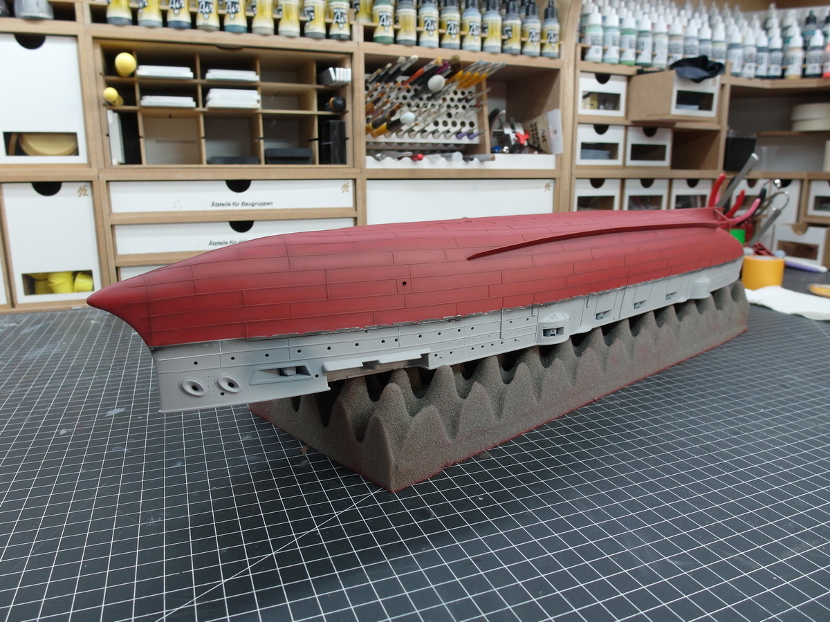

Let's start by painting the lower hull. First the preshading.
And then tape it off. I’m doing this relatively precisely, even though I’m only in the basic color.
Of course I could spray the red without masking it off, but then too many layers would overlap afterwards and the whole thing would be too thick for me.
And now the antifouling paint is on the underwater hull.
The waterline is running great. Profiles attached at the correct height. I really like the structure I made from the styrene profiles, and the preshading also comes into its own.

Then I built a dry dock for the Mikasa.
This means it can be safely laid on its side, for example to work on the portholes.
I can also attach sheet pile walls of different heights to further increase the protection at the top.

I finished all the rough work on the fuselage and was finally able to finish painting it.
After a proper preshading the whole thing now looks like this.
What followed was an accentuation. Which means nothing other than that I painted fine details in a lighter gray.
Which was a real fiddly job. The dry decals from Pontos are really impressive. The depth marks are razor sharp.
Here too, water-soluble acrylic paints have a big advantage. Small slips can be removed immediately with water without leaving any residue.
This gives a decent contrast to the preshading areas.

I’m a little further along.
The first round of aging is complete.
There are three filters on the underwater hull.
On the gray two.
Also a first washing.
Above and below.
I’m quite happy with it.
Greetings from Germany.
Jörg
