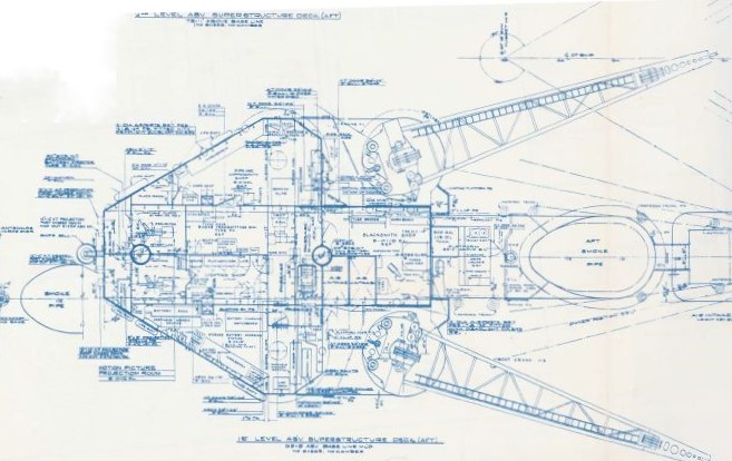

I can't answer that, but the equipment LOCATION was flip-flopped symmetrically - here's an overhead view of the cranes:
As you can see, equipment outboard on the stbd crane is reversed and outboard on the port crane, etc. Whether the winches/motors operated in reverse fashion I can't say. The cable drums on the two machinery levels below each crane are located on the outboard side of the kingpost, so I would think that probably the operation of the winches was indeed reversed from one crane to the other.
