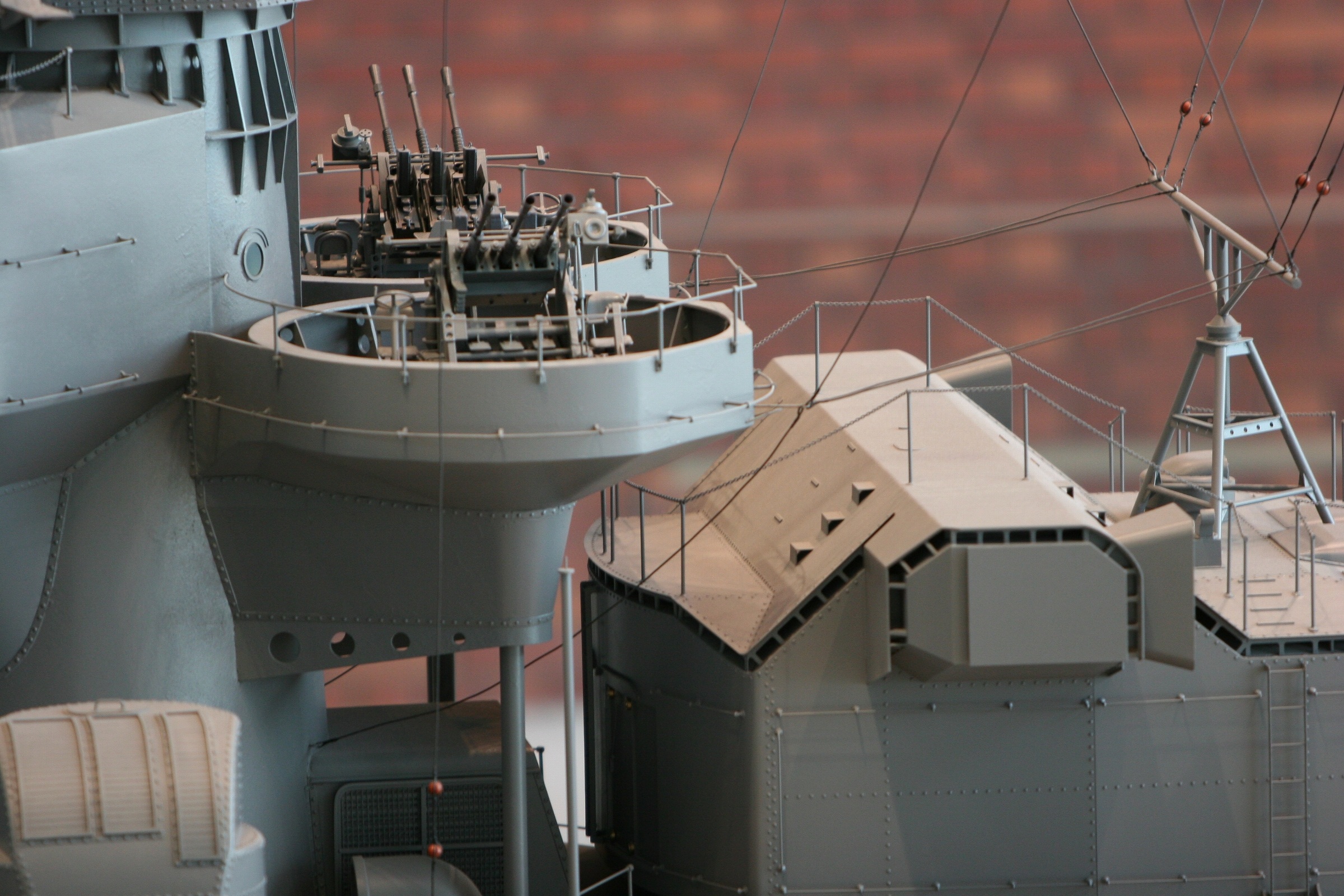

CHAPTER 05. AFT SHIP
Step 05.03. Cables to AAA Platform Front Railing Brackets
Gentlemen,
Today we will talk about the cables that arrive in the 2 AAA Platform Front Railing Brackets.
For clarity : the front railing of the AAA platform faces the Aft side of the ship. Good to know when you study the rigging of a ship…
Let’s take a look at the pictures list:
Pic Nr 001: This is the schematic reference picture that will be used in all the rigging steps of the Aft Ship. The elements of todays rigging step are : cables D&E, Branches Nr 2&3, Joint Nr 4, cable F, cables” J”&”K“and joint Nr 5 on the Front Bracket.
And of course : all these items on port and on starboard side.
Pic Nr 002: Side view of AAA platform with detail view of the incoming cables on the port side front bracket.Pay attention for the port side bracket Nr 5: the green arrows mark the Bracket Lugs where cables” F-J-K” are attached. Also clearly visible: the length of the rod between the platform wall and the lug-eye. Quite long!
Pic Nr 003: Upper Side view of port & starboard AAA platform, also with detail of front brackets. In this picture also, the big length of the bracket rod is prominently shown.
Pic Nr 004: Close Head-on view with incoming cables and detail of the 2 front brackets.
Green arrows: bracket Lugs where cables “F-J-K” are attached. Yellow arrows: attachment points ( 2 per bracket) where the triangular shaped support rod is welded to the Platform Wall.
Please note the 4 Brown Ball Insulators near Antenna Brackets 2&3 on port and starboard side of the antenna.
Cable “F” comes from joint Nr 4 that merges the 2 short cables coming from branches Nr 2&3 on cables “D&E”. See also Pic 001 for detail.
Pic Nr 005: Upper aft view of the starboard platform with cables and bracket.
Pic Nr 006: Starboard view of platform & cables.
Pic Nr 007: Close -up of Pic 006 : Front-side view of platform & cables.
Pic Nr 008: Front view with detail of incoming cables. Please note the angles with which both Cables “ F” arrive on the front bracket lugs.
Let’s start the rigging procedure :
The Aft AAA platform is located between the Rear Range Finder and the Aft 155mm Gun. See Pic 005. The platform floor is slightly higher than the top of the 155mm Gun roof and it is surrounded by a metal wall. See Pic 002. The metal wall is only the lower half part of the railing because above, on the outside of the metal wall, a vertical railing is attached. See Pic 002.
Caution : the front railing bracket which we will discuss in todays rigging step is no part of that vertical wall-railing!
Outside on the platform wall, a smaller, horizontal railing is attached, much lower than the original railing.
At the underside of that horizontal railing, the 2 front brackets are welded to the metal platform wall. See Pic 002-003-004-005-006-007 for detail.
The platform bracket:
This is a solid long rod (see Pic 002 for detail) with a lug-eye on one end. The other end, the flat side, is welded to the platform metal wall. A second solid rod, bent in a triangular shape serves as bracket support and is welded with its tip to the underside of the long rod and with its 2 flat ends to the platform wall. (see Pic 004 for detail).
The location of the 2 brackets is at the front side of the platforms, but not in the middle. (see Pic 004 for detail).
When you look at Pic 003, you will notice that the 2 brackets are installed rather on the front Outer side, than on the middle of both platform walls. The 2 brackets are facing the stern side of the ship.
The incoming cables :
Each platform front bracket Nr 5 receives 3 cables: See Pic 001-002-003-004-005-006-007 for detail.
First cable ”F” : (see Pic 001 for detail). Above on the Aft Ship, rigging cables “D&E” are split at Branch Nr 2&3 into 2 short cables. Little further, these 2 short cables are immediately brought back together in joint Nr 4, where cable “F” (blue tag on port side and yellow tag on starboard side) emerges and lead to the port & starboard lug-eye of the 2 front brackets Nr 5.
Second cable “J”: from the 155mm Gun Antenna bracket Nr 2 (red & green tag), cable J leads to the lug-eye on port & starboard front brackets Nr 5.
Third cable “K”: from the 155mm Gun Antenna bracket Nr 3 (red & green tag), cable K leads to the lug-eye on port & starboard front brackets Nr 5.
Insulator Count
In this rigging step, no Insulators were used.
This is the end of step 05.03. Cables to AAA Platform Front Railing Brackets
Next Rigging Step : 05.04. Rigging Loose Cable from AAA platform Front Brackets Nr 5 to Structure Wall Lug Rings Nr 6.
Gentlemen,
have a nice day.
Step 05.04. Rigging Loose Cable from AAA platform bracket Nr 5 to Structure Wall Lug Ring Nr 6
Gentlemen,
Today we will talk about about the 2 single, loose cables that run from the port and starboard AAA platform Brackets Nr 5 to Lug Ring Nr 6 that is attached to the vertical structure wall under each AAA Platform.
Take a look at the pictures : they give you details from different angles.
Pic 001: this is the schematic drawing used in all previous rigging steps of the Aft Ship. For this rigging step the next items are of interest : Cable “F”&”G” , bracket Nr 5 and lug Ring Nr 6. All on port and on starboard side.
Pic 002: Is a Port Side detail view of the loose wire trajectory from Bracket Nr 5 to the ring Lug Nr 6, in the structure wall, under the port and starboard AAA platforms.
Pic 003: Starboard side view with detail of the starboard trajectory of the loose cable.
Pic 004: General starboard view that gives you a good idea about dimensions and proportions of the cables and AAA platforms.
Pic 005: Angle-view with starboard detail of the loose cable.
Pic 006: Port side view with detail of the loose cable trajectory.
Pic 007: Close -up of the starboard loose cable.
Pic 008: Port side view with detail of the loose cable trajectory
Pic 009: Starboard side view with detail of the starboard trajectory of the loose cable.
Rigging procedure
This rigging step will be a simple one.
On both Brackets nr 5, cable “G” is attached and from there it goes under the port and starboard platforms where it is attached with a Lug Ring Nr 6 to a ring on the vertical structure wall.
The lug ring is located quite high above a vent. See Pic 007 for detail and the other pictures for general view.
Although Cable “F”, coming from the Side Mast tips is present on all pictures I would like to note that Cable “G” is certainly not an extension from Cable “F”. Bracket Nr 5 is the end station of Cable “F” and also the place where the new Cable “G” starts.
This chapter received its name because the 2 cables in this rigging step are really hanging “ loose”.
When you observe these cables you will see that they are not attached to any other station on the aft ship and they have no insulators installed. One may wonder what the added value is to install a short, loose cable without insulators and which makes no contact with any other rigging device.
Another subject for the long list of Yamato’s rigging mysteries….
Insulator Count
All the pictures show you clearly that in this rigging step, no insulators are used.
This is the end of step 05.04. Rigging LOOSE Cable from AAA platform bracket to lug in Structure Wall
Next Rigging Step : 05.05. Rigging 2 Cables from Side Mast tips to Second Level deck
Gentlemen,
have a nice day.
Step 05.05. Rigging Cable from Side Mast tips to Second Level Deck
Gentlemen,
Today we will talk about Cable”C” that comes down from the port and starboard Side Mast tip Lugs Nr 0 to the attachment Lug Nr 7 on the second level deck of the Aft-Ship.
Let’s take a look at the pictures :
Pic 001 : this is the schematic drawing used in all the rigging steps of the Aft Ship. In this step, the next items are of interest : Startpoint Nr 0 at the Side Mast tip Lugs, Cable “C” and lug Ring Nr 7 on the second level Deck. All on port and on starboard side.
Pic 002 : this is a general overview of starboard Cable “C”( yellow arrows), from startpoint Nr 0 ( blue arrow) at the Side Mast tip Lug, almost vertically down to the second level Deck, where it’s attached to Lug Ring Nr 6 ( light blue oval) with a bottlescrew. Also note the 2 black ovals near the Side Mast Tips and near the second level Deck. They each contain 2 Brown Ball Insulators that are installed on Cable “C”.
Pic 003 : Detail picture of Cable “C” where it arrives on the second level deck. Please note the detail of the bottlescrew and the 2 Brown Ball Insulators.
Pic 004 : View of the same area on Port side.
Pic 005 : general overview on starboard side of a big part of the rigging cables of the Aft Ship. Not only Cable “C” with the Bottlescrew and Insulators is visible but also the 155mm Gun antenna Brackets with all their incoming cables, the connection cables to the AAA Front Brackets and the “Loose Cable G “ that ends on the vertical wall under the starboard AAA platform.
Pic 006 : Detail view of the same area. Please note the location of the 2 Brown Ball Insulators and the Bottlescrew that is attached to Lug Ring Nr 2 on the second level Deck.
Rigging procedure .
Let’s start. Take Pic 002 as a reference.
At startpoint Nr 0, Cable “C” departs from the 2 Side Mast tip Lugs. A little bit further on the cable, we meet 2 Brown Ball Insulators. From there, cable “C” proceeds towards the second level Deck. Before it arrives there, we meet another 2 Brown Ball Insulators. Little after the Insulators, Cable “C” is attached with a Bottlescrew to the Lug Ring on the second level Deck.
Details of the Starboard Bottlescrew and the Lower Brown Ball Insulators are emphasized in Pic 003.
Insulator Count
In Pic 002, you notice there are qty = 4 Brown Ball Insulators installed on the starboard Cable “C”.
This means that on the Port Side Cable C there are also qty = 4 Brown Ball Insulators installed.
Total of insulators used in this rigging step : qty = 8 Brown Ball Insulators.
This is the end of step 05.05. Rigging Cable from Side Mast tips to Second Level Deck
This is also the end of Main Chapter 05. AFT SHIP
Next Main Chapter : 06.STERN
Next Rigging Step : 06.00. Rigging MC1&4 above the Stern, up to the Ensign Staff.
Gentlemen,
have a nice day.

CHAPTER 06. STERN
Step 06.00. Rigging MC 1&4 above Stern up to the Ensign Staff
Gentlemen,
Today we will talk about the rigging of MC1&4 above the Stern, all to way up to Yamato’s Ensign Staff.
Before we take a look, it is useful to know that in all different pictures, the names, numbers and colour codes (when present) always refer to the same items. Much easier to understand this rigging chapter :
Blue arrows: MC1 trajectory up to Black arrow Nr 11.
yellow arrows: MC4 trajectory up to Black arrowNr 11.
Blue- or yellow ovals : Brown Ball Insulators.
Black arrow: Joint nr 11 where MC1&4 are merged into 1 single cable “L”.
Red arrow: Stern Crane tip with 2 separate rigging stations : the Upper Lug Ring and Lower Aft Lug Ring.
White arrow: Ensign Staff Lug Ring Nr 13 where Cable “M” is attached with a loop.
Pic 001: This is a schematic overview of the Stern Rigging area. It shows the trajectory of MC1&4 that run from the red-striped rigging area line to the Crane-tip.
Joint Nr 11 = where MC1&4 are brought together and form a new Cable “L”.
Cable “L” is attached with a bottlescrew to the Upper Lug Ring on Crane -tip Nr 12. In the aft-lower Lug Ring on the crane tip, Cable “M" emerges from another bottlescrew and runs towards the Lug Ring on the Esign Staff.
Pic 002: As a little reminder, this picture shows the rigging area of the Aft -Ship but most off all, at its left side , the red-striped line shows the end limit where the Stern rigging area starts.
Pic 003: this is a general Upper view where you can see the complete Stern Rigging Area.
Pic 004: Aft-Side view with all the items of the Stern rigging area.
Pic 005: Side view with all the rigging details in perspective.In this picture you get a good idea where the Stern rigging starts , left of the yellow striped line.
Pic 006: View of the Aft Stern area. Please note that in this picture all the Brown Ball Insulators are visible.
Pic 007: Detail view of the Ensign Staff. Prominent in this picture: Lug Ring Nr 13 to which cable “M” is attached with a simple loop.
Pic 008: Second detail view of Lug Ring Nr 13, but this time with the 2 last Brown Ball Insulators on cable “M”.
Pic 009: Aft view of the Stern rigging area with all its protagonists.
Pic 010: Detail of Crane tip Nr 12, Joint Nr 11 and Cables “M” and “L”.
Yellow arrow: Bottlescrew in Upper Lug Ring on Crane tip where cable “L” ends.
Blue arrow : Bottlescrew in Lower Aft Lug Ring on Crane tip where cable “M” starts.
Rigging procedure.
Let’s start and please use all pictures as a reference.
One should forget, but actually we only keep following the trajectory of the double Main Cables Nr 1 & 4 that transformed back into single cables in port & starboard joints Nr 10 of the Aft-Ship rigging (previous Main Chapter).
In many pictures, the red/ yellow striped line shows the border between the Aft-Ship and the Stern rigging area. Main cables MC1&4 come from beyond that line and go towards the Crane-tip on the Stern.
In Joint Nr 11, MC1&4 are merged into 1 new single cable : Cable “L”. Cable “L” contains 2 Brown Ball Insulators and it ends with a bottlescrew in the Upper Lug Ring of Crane-tip Nr 12.
In the other station of Crane tip Nr 12, the Lower Aft Lug Ring, Cable “M” emerges, also with a bottlescrew and goes down towards the Ensign Staff. On Cable “M”, 2 Brown Ball Insulators are installed near the Crane-tip and another 2 near the Ensign Staff.
The special lay-out of Crane tip Nr 12 : See Pic 010.
A. The Upper Lug Ring:
From the moment MC1&4 left the Side Mast tips, and travelled the entire trajectory up to the Stern Crane-tip, not one single rigging device was used to put tension on these cables.
That’s why in the Upper Lug Ring of the Crane-tip, a bottlescrew (Pic 010, yellow arrow) is installed on Cable “L”.
Remember: Cable “L” is the joint of the 2 Main Cables Nr1&4, so any tension applied on Cable “L” by a bottlescrew will be transferred on MC1&4 all the way to the port & starboard Side Mast Lugs.
What a considerable distance between the Crane-tip and the Side Mast tips, don’t you think ?
B. The Lower Aft Lug Ring:
This device is located on the aft side and a little bit lower than the Crane-tip. In this Lug Ring, another big bottlescrew (Pic 010, blue arrow) is attached with one end. The other end is attached to Cable “M” which goes down to the Ensign Staff Lug Ring where it is attached with a simple loop.
The bottlescrew in the Lower Aft Lug Ring puts tension on Cable “M, and by doing this, it also relieves the tension of MC1&4 on the Crane Mast in Crane-tip Nr 12.
Insulator Count
Take a look at the 5 different locations where Brown Ball Insulator-pairs are installed in Pic 001-003-004-005 and certainly in Pic 006.
Total amount of Insulators used in this Rigging step : 10 Brown Ball Insulators
This is the end of step 06.00. Rigging MC1&4 above the Stern up to the Ensign Staff.
