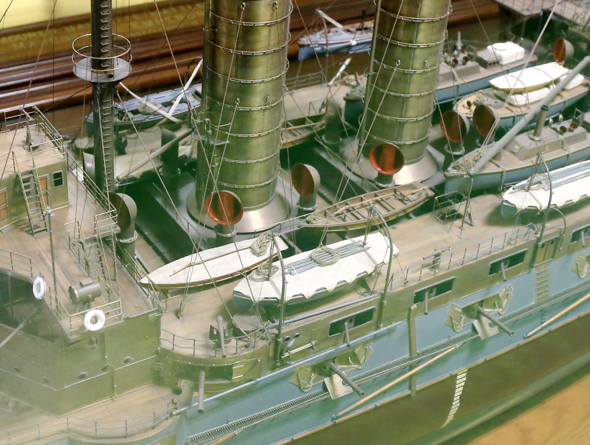

Aboard Mikasa there is a very nice 1/50 scale model of Mikasa. This model probably better represents her original state than the upper parts of the ship today.
Mike
