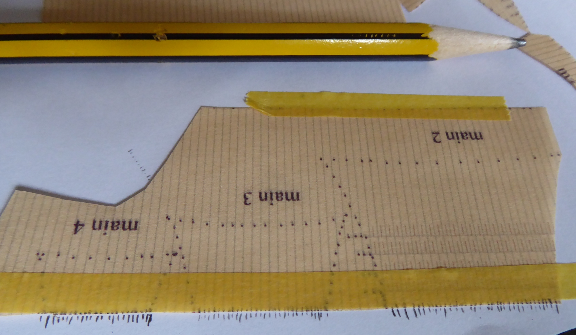

Getting the RPR level was achieved by the simple and quick means of having a piece of paper taped to the screen (!)

Really fantastic and realistic sails Jim - in 1:700, I must keep reminding myself!

At this scale it is a good idea to fix the sail to the stay first and then the whole to the ship.
Ninitinol as a metal will not 'react' to any paint ...
