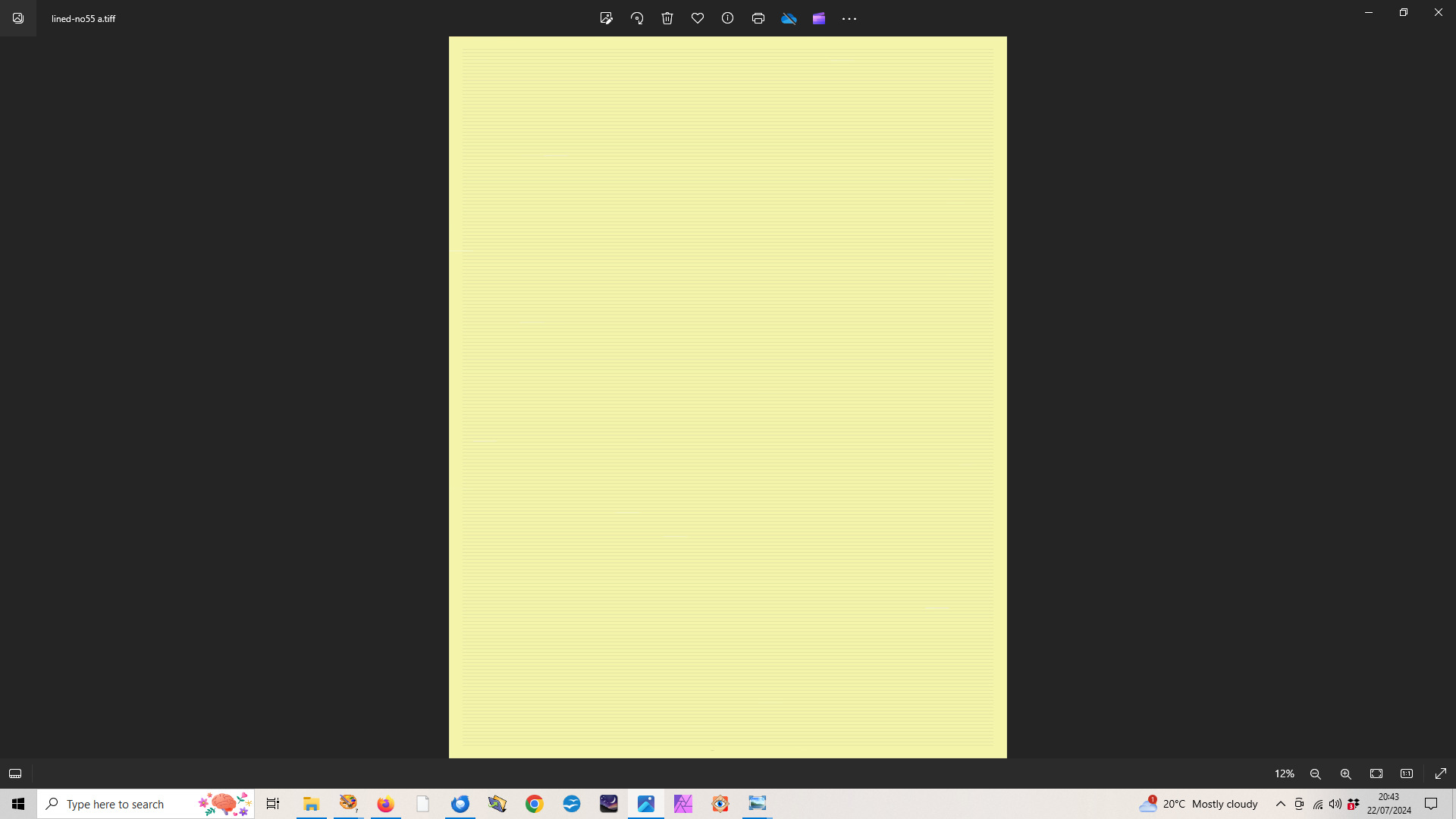

I started by creating the ' new' the sail paper lines in much higher res

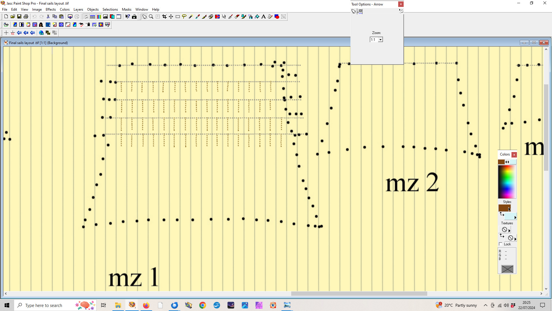

Keeping in mind the small size--I wanted the reef pennant ropes ( RPR ) to be capable of being handles by my 1/700 crew
This means they are only just visible when printed....
The reef bands and RPR have been drawn in as a series dots rather than lines
When printed it removes the ' weight ' of line to the observers eye

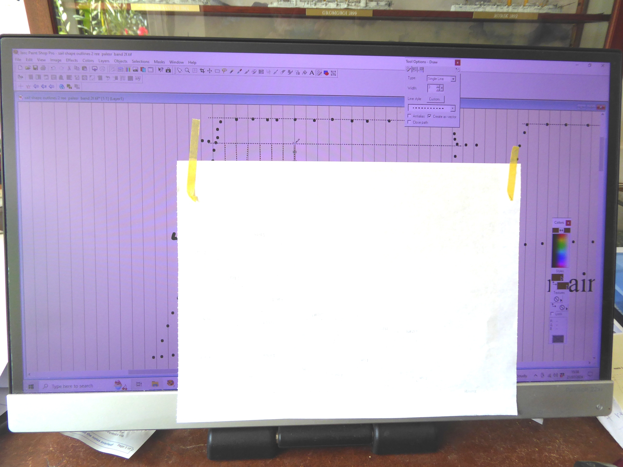

Getting the RPR level was achieved by the simple and quick means of having a piece of paper taped to the screen (!)
