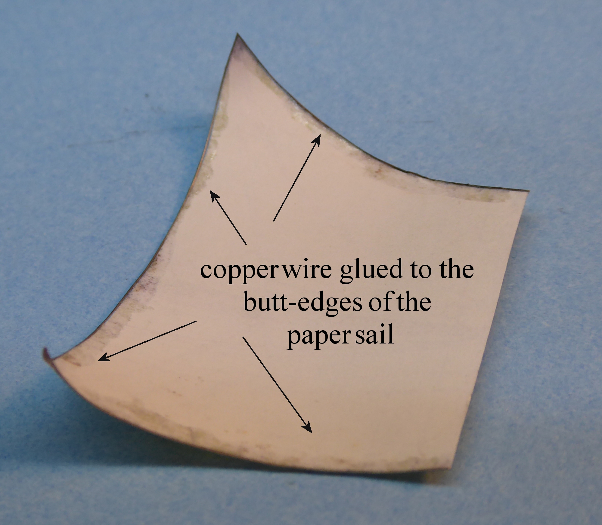

the sail templates are cut out from a 1/700 scaled pdf drawing paper printout
This was slightly enlarged by 3-4% so that sails have enough (over) size for me to create the ' belly' and fullness shape
( as when its a 3 D shape takes up length in each direction hence making it slightly bigger compensates for this
as well as the narrow but full return curve at the leeches (vertical sides) caused by the 'bolt-ropes
( rope sewn in around the edges of the sails )
being tighter than the fabric
I simulate the bolt-ropes with 0.05 tinned copper wire glued onto the butt edge of the paper while the sail is flat ( fiddly! )
=> I do this on ' baking ' paper as the CA glue does not sticky that!"...
Then the sail is shaped firstly by rolling a round headed large paint brush handle to stretch the paper on a Post it note pad ,
then a small round headed paintbrush handle to create the 3D effect at the leech
The the copper wired sail edges are formed between fingers--the wire makes it hold its shape perfectly
( You can see the messy glue on this experimental unvarnished paper sail )

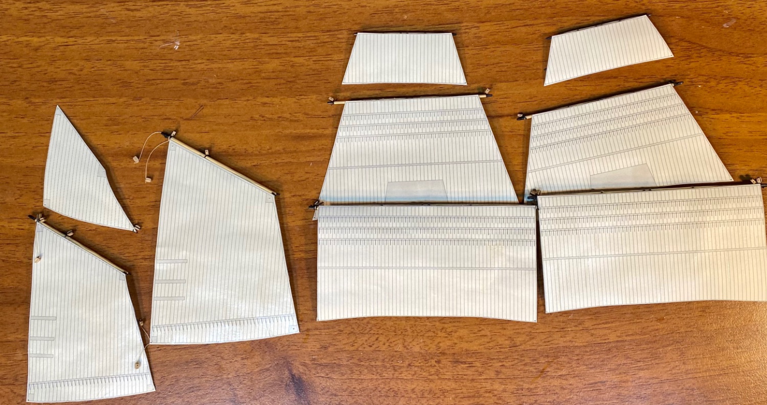

I have made some progress--with all sails cut out and now starting the process of adding boltropes all round in 0.07 mm wire
It is quite a tedious process--but doing the gluing on grease-proof baking paper has simplified the arduos-but-almost -fun process....
The round ended plastic body of the old Parker fountain pen (with the spoon )
makes a good shaping tool when shaping sails on a post-it-note
With the pen I can apply point loadings to curl the paper slightly at the edges ( and not overdo it!)
Once all the sails have been wired and shaped
-- I will paint the boltropes-- and paint in the platform patches
and then attach them to their spars and yard arms in readiness for mounting and masting the ship to her sea-base !

At this scale it is a good idea to fix the sail to the stay first and then the whole to the ship.
Ninitinol as a metal will not 'react' to any paint ...
Eberhard
