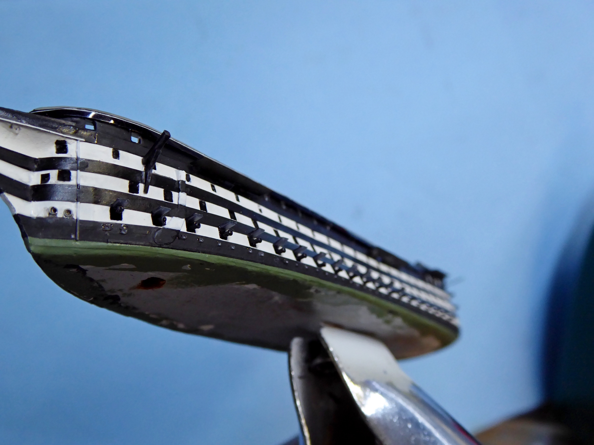

A trial install of a unpainted gun barrel into a selection of the apertures in the hull....
was encouraging in appearance !
It did also however reveal that all my initial drilling into the hull for the gun-ports......
( thread page 1 and 2) was not all of an entirely uniform depth... necessitating a test fit-and cutting to length of each barrel.
( ....up to 0.4 mm variation :scratch: -which does not sound much-
- but would equal to 280 mm in real-life 1-1 scale)
though its nothing that a quick swipe with a sanding stick cannot change! :cool_1:

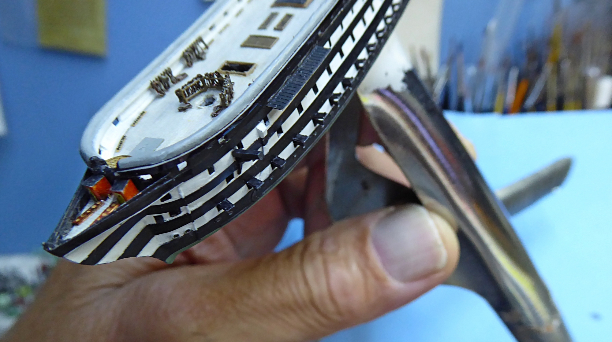

The barrels that have been installed so far were bedded on to a dollop of white glue at the inboard end to give a cushion==> and an even and strong grab.
The white glue slower setting time also allowed tuning of the angle and heights of the barrels for some time! ( wiggle room time)
The gunport lids were installed using the handy and ( much! ) aforementioned glue tongues.... :cool_2:
.......and using a good dollop of white glue to obtain a secure joint
( the glue dollop ends up going up behind the inside edge of the PE brass square in the side of the hull--giving secure adhesion
Early days still-- but the look and effect is increasingly promising !
The lids--once set and tuned--will receive a slight wash and very very light drybrush
onwards on to more lids ... and then the 2 rows of 30 pdrs will be next !

Jim, why did you set the guns at the lower edge of the gunports, for practical reasons? Normally, when the barrel is horizontal, they should be about in the middle of the gunport.
Eberhard
Image Image Image Image
PostPosted: Thu Sep 26, 2024 3:28 am
Posts: 5568
Well--it looks I will be pulling some guns.... shell shell
My guns are indeed not dead centre--it was intentional
( I reckoned that whilst not in action but under sail the guns would not be elevated
the position of the guns is in within lower third-- based on what's local to me... :big_grin:
do you ( all) think they need pulling > adjusting?
see Victory below
