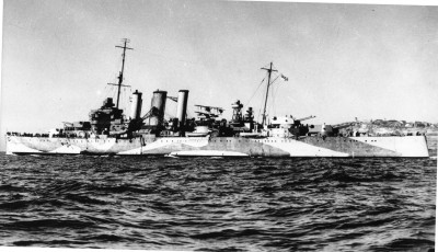

Lars, IMHO if you wish to have a reasonably accurrate model, forget about the Kombrig Australia (and Canberra). They´re not a good starting point, too inaccurate and too basic - and too expensive considering how many parts are really useful :cool_1: The only reason why to use the Kombrig hull in case of Canberra these days would be that missing torpedo belt.
I found it quite interesting that there are still no other Australia kits on the market than the old Kombrig. Why would she be so uninteresting? Perhaps because of her “boring” one-tone camouflage variants she wore most of her Pacific war career? But isn´t there that sexy “lady leg” two-tone camo she carried since fall 1940 in the Atlantic for some 20 months and then at Coral Sea? How I regret she didn´t retain it until Savo Island :heh:
19410500 HMAS Australia departing Sydney NHSC136.jpg [ 283.29 KiB | Viewed 2815 times ]
Or are there no better kits because too much research would be needed?

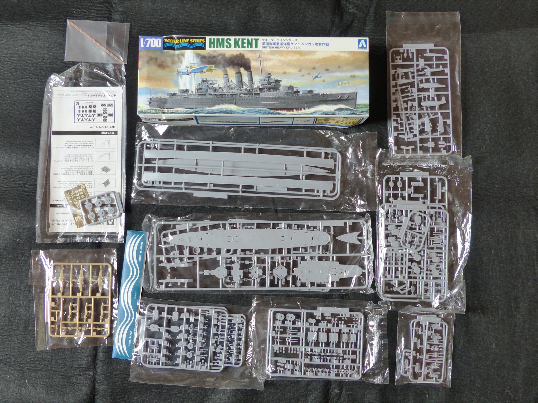

It took several painful weeks until my Aoshima Kent was delivered due to all those Covid restrains. Besides working on the Chicago and Kinugasa I spent them by continuing to catalogue modifications that will be necessary for the Australia conversion. As often, many more turned up than first anticipated.
Then the kit finally arrived! It was contained in a rather small but tall box packed tight with heaps of plastic parts. Sorry to say that, but most of it was not as good as I would have expected, some parts appeared almost toy-like and apparently were not much usable for me :( Overall, compared to the recent 1/700 kits produced by e.g. Flyhawk or Fujimi - but also to 15 years old Hasegawa Aoba and Furutaka classes! – it´s below standard these days. The good news though was that the hull and deck were clearly the best of the kit, nicely and crisply molded. It´s really a pity Aoshima didn´t do a better job, and the 1/700 Kent by Trumpeter (that did not exist at that time) would have been a better starting point in many respects.
In short, I ended up using only the hull, the main deck, the forecastle deck and the aft superstructure parts from the kit in the end anyway :smallsmile:

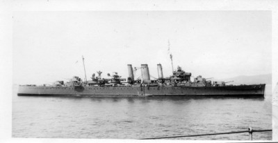

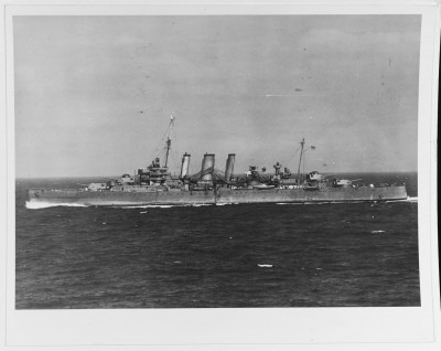

I´m no big expert in RN/RAN ships so I turned again to Brett Morrow who already greatly contributed to my HMAS Canberra build back then. Brett is a top expert with a vast knowledge about the Royal Australian Navy and also owner of a great collection of photographs and other documents. I was very happy when he agreed to participate in my project and his contribution was indeed crucial.
Although we found no worthy plans of Australia in her wartime fit available, wartime photos were really abundant – we collected well over 200 of them after her 1938-39 refit. Some show excellent, rarely seen detail of life on a capital ship and others well document her overall fit, but there are still serious gaps if it comes to individual details in 1942.
Most importantly there are two awesome side view shots showing her port and starboard sides in August 1942:
19420830 HMAS Australia port Solomons 80-G-12107.jpg [ 293.56 KiB | Viewed 2732 times ]
19420800 HMAS Australia Guadalcanal no exact date NHSC013.jpg [ 159.63 KiB | Viewed 2732 times ]
The somewhat blurred starboard side view is complemented by slightly later view of the same side taken after her late 1942 refit and installation of an SG radar in 1943:

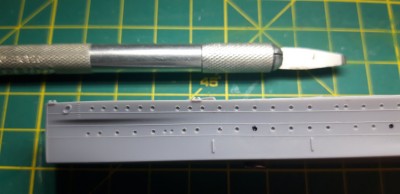

I mentioned that the Aoshima Kent hull was quite nice and crisp, especially the porthole brims looked really good. I like how the hull was constructed with internal bracing, more like hulls in 1/350. Also the waterline plate fits inside the hull so no seams can be seen from sides, really wise! Still it has some problems to correct – most importantly the overscale and unrealistic hull plating. I checked some completed Aoshima Counties on the internet and found this hull plating really ugly, so I hesitated no more to remove those lines. I modified a Proedge blade to scrape them off, followed by sanding with 1000 and 2000 grade sandpaper. I wished to protect the upper row of porthole brims so I covered them with masking tape while sanding.
The next step – easier to correct – were the portholes. Australia had almost all of her lower row of portholes and some of the upper row plated over, altogether about 120 of them. I filled those with acrylic putty at first intending to plate them over with PE later.
Note: the vertical molds near the waterline should have been removed as well - I noticed that Australia did not have these covers over the water outlets only at a very late stage and it´s been very cumersome to correct at that time!
Then it was the main deck. It fitted nicely into the hull, very easy to install and with no seams. The deck planking is overscale as usual but I decided to leave it as in the kit to reduce the size of the PE set (I regreted this decision at a later stage but then it was too late). I also liked how the turrets were attached with separate barbettes so there´s no dilemma about how to postpone their installation while still being able to attach the deck and superstructure first. Very clever. So it´s only needed to remove all the representations of unneeded deck vents, reels, breakwater and anchor chains, all those to be replaced with PE or 3D parts later.
