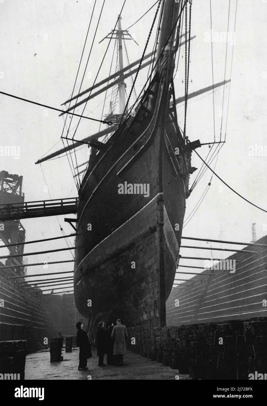

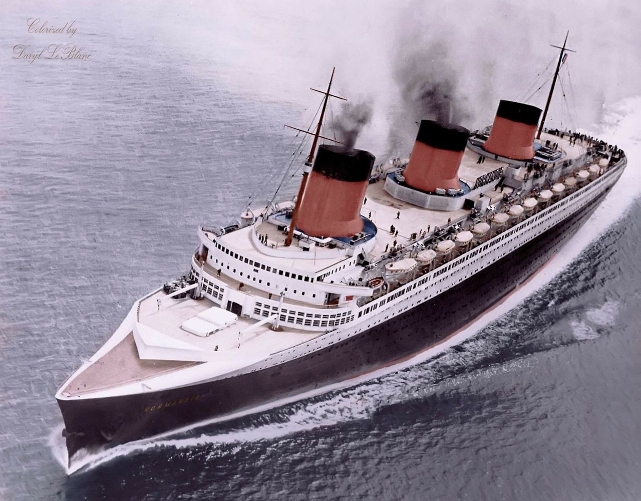

A ship with a fine entry, ( such as a Destroyer, 'crack Ocean liner or Clipper )
with their very fine lines causes little fuss at the ' cutwater 'when at speed ,

Normandie at 30 knots
Clipper bow

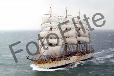

These 2 images below are of the 4-masted Barque Sedov, ploughing down the English channel at some speed,
( I estimate 15 knots or more ) in a 'capful' of breeze ( I estimate windspeed around 35 knots )
she has a bone in teeth and the wake is clean ...
in this image she seems to have overtaken the wave and has 'dipped into the next wave-- hence the " bone " is massive !
Now Sedov, along with all her contemporaries, were large, fast and weatherly steel hulled cargo vessels
and had relatively fine lines
( not quite a Clipper... but fine ! ) which gives a clean wake.

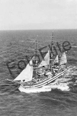

Bretagne for all her good sailing qualities was no 'Clipper... or a Sedov...
so a fairer comparison / inspiration would be the large Italian 1930 sail training ship Amerigo Vespucci.
Bretagne was slightly shorter but a 1000 tonnes more displacement-- so near enough !
Images below show the 'Vespucci in much more wind but carrying far less canvas, -I estimate her speed at 6-8 knots,
==> note the amount of disturbed water ahead, alongside and astern!

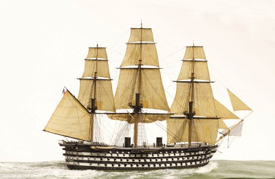

Thank you gents!
Herewith some all over distance images on a plain background
for the interim ,....
" proper " ... proper ! images will be in gallery in due course
when I have worked how best to shoot with the new camera ! :scratch:
