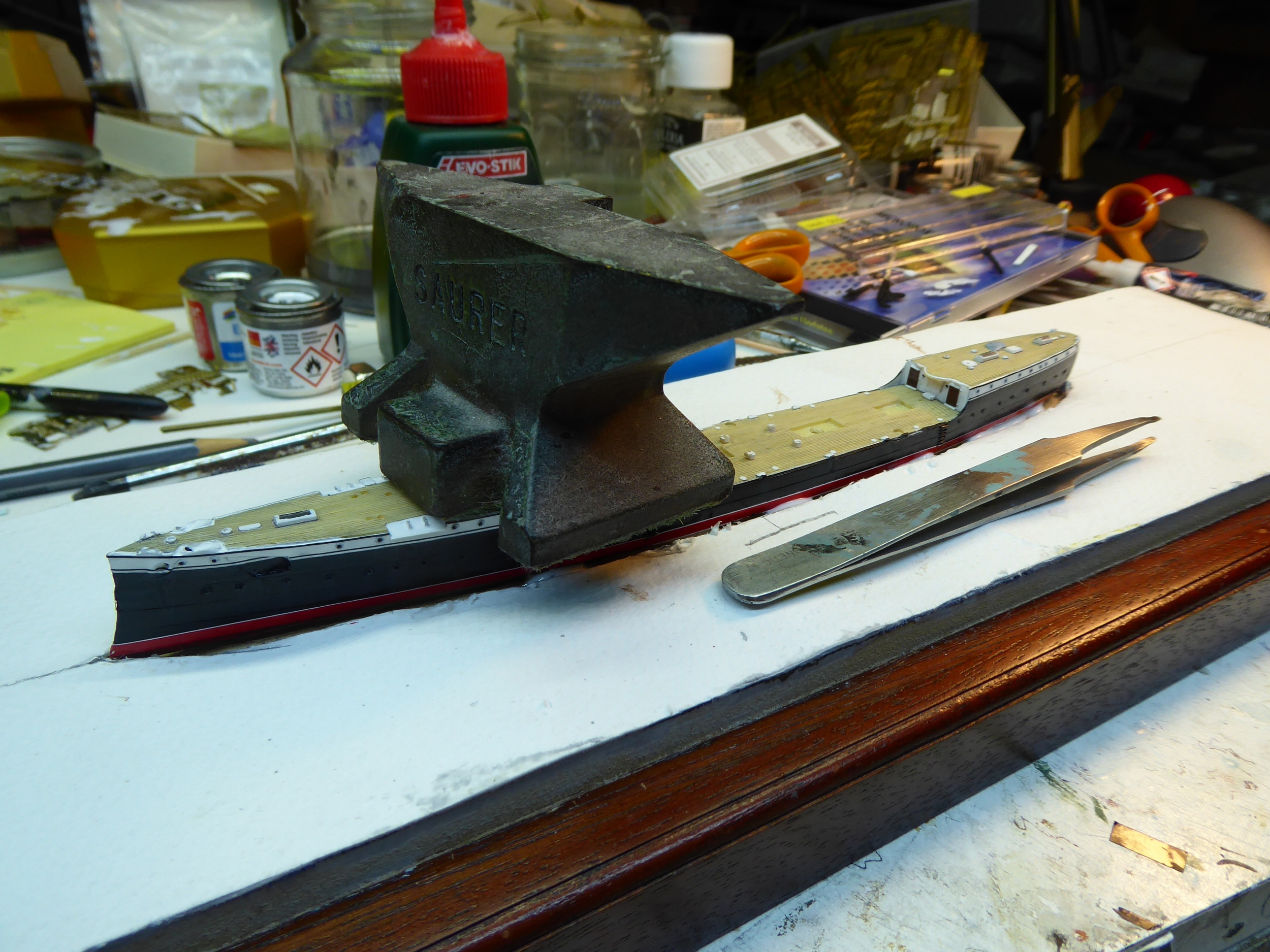

Progress is steady-... ( but 1/350 is soooo big ! ).... :big_grin:
after plating the hull--I needed to think how to replicate the sharpness of the colour demarcation lines
I used the same method as I did as on my 1/700 Normandie
http://www.modelwarships.com/reviews/sh ... /index.htm
Both ships have a black hull / white upper ) and the sharpness of demarcation is important
I have found that ( for me- !!) masking tape is not always successful when there are curves and uneven surfaces

The ship is now mounted on her base and I awaiting the ( Evostick green )white glue to set ....( 2 days till hard!)
