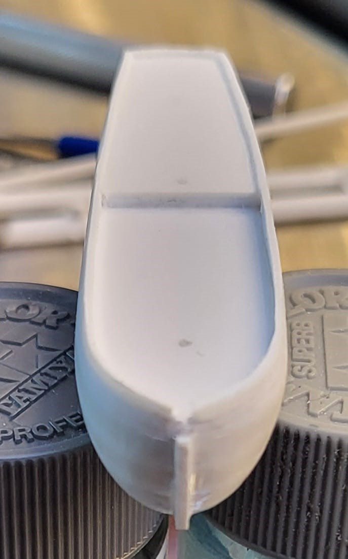

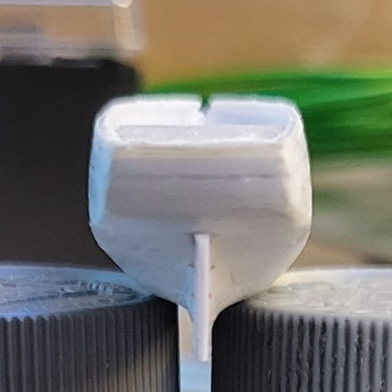

back in the warf.... was doing some details... had to do some research to be sure to do things right.... an idea came to me... and so I started something extra... can someone tell me what I'm gonna make to ad to my NS Savannah Vitrine, and as it doesn't exist in that same scale... I'll have to make it scratch
and with a bit more done

Could it be the first Savannah? A galley if I'm correct?

Good thinking Neptune... but it will be the 1819 SS Savannah, the Hybride pioneer ship being the first steampowerd ship to cross the Atlantic and the reason NS Savannah got her name

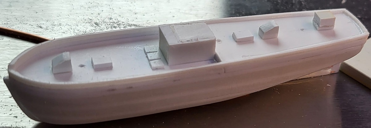

some more done... on both ships

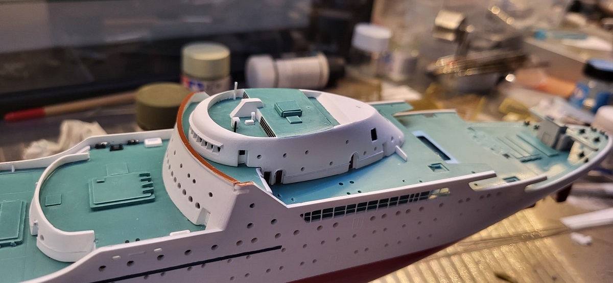

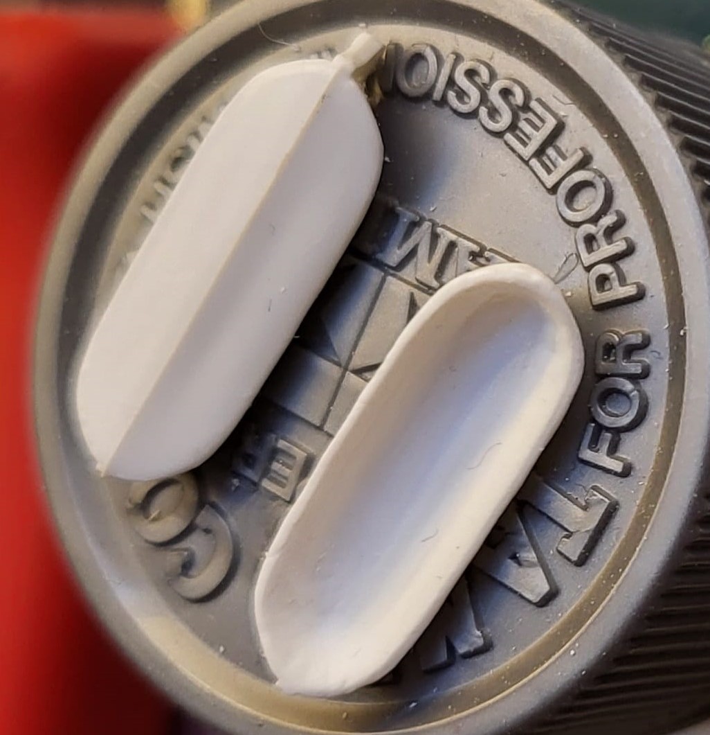

As the lifeboats are without cover on all pictures I've seen... I had to scrap the kits lifeboats out
worked also on bow and rear
with a little paint it looks like a wooden hold... gives it something extra
also some more done on SS savannah

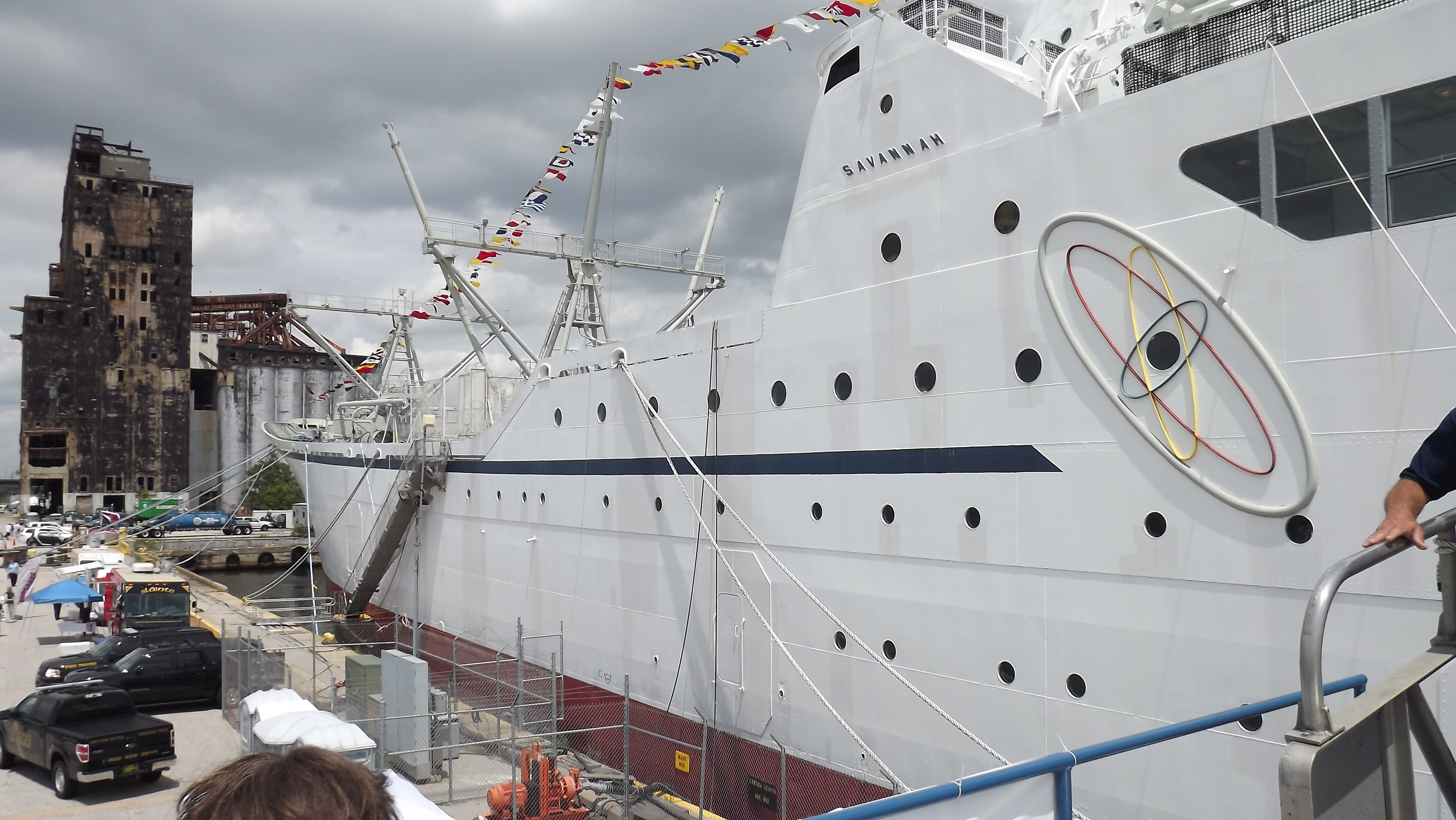

Some Savannah/National Maritime Day, Baltimore related pictures
My Constellation and schooner Son of Erin as seen FROM on board NS Savannah  ;)
Savannah from the gangway

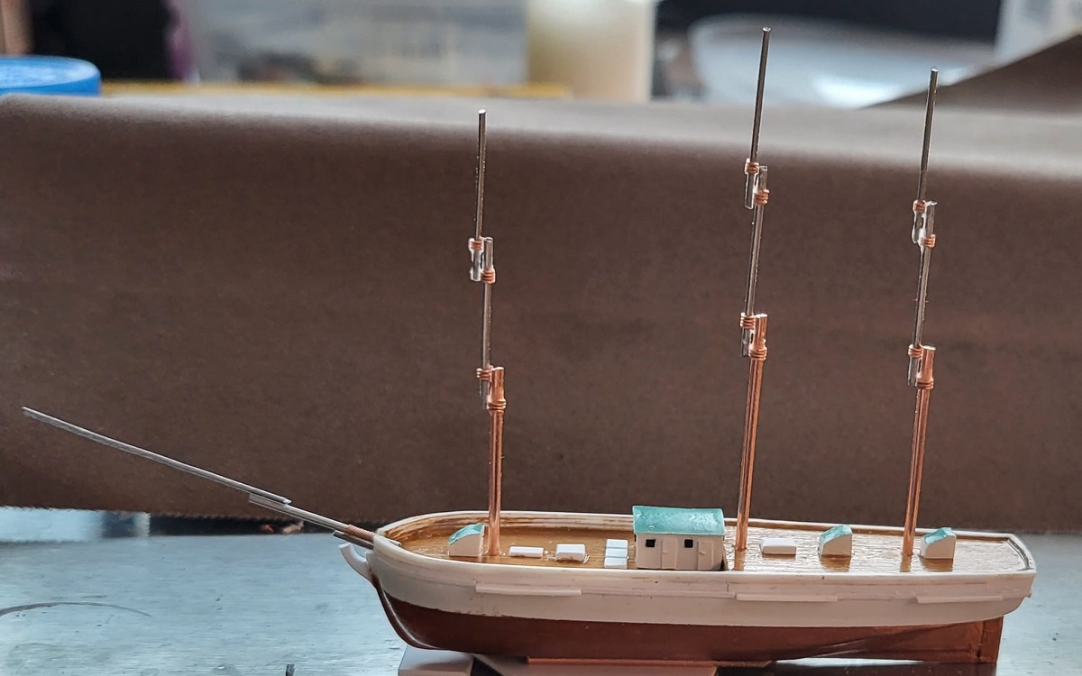

put last color on hull, thought it a good idea to place a batterie, and so giving a reference for size
Triumph68
Posts: 1125
Re: 1/380 Revell NS Savannah and 1/380 Scratch SS Savannah
Post by Triumph68 »
the lines are made of 0.1mm Cu, I decided to use Cu and not stretched sprue to give extra strenght
Neptune
Posts: 2455
Post by Neptune »
Looks good, however, for future reference I'd recommend Fly-tying thread for fly fishing (different thicknesses) . They are thinner than the copper, but more importantly, easier to get tight.
I once used copper wire for mooring lines and you always seem to get some twist/bend in it. It's never 100% straight.
After using fly tying thread for bottle builds, I regret not using it for those mooring lines.
Difficult to see, but the crane wire on this one is done with fly tying thread.
In any case, a remarkable and unique build. Where did you find plans or drawings of the old Savannah?

yes, true Cu wire is always difficult to straiten, but in this case I used it to give extra strenght to the bowsprite making it a little more stabile on its own and also for futur wiring to masts.
