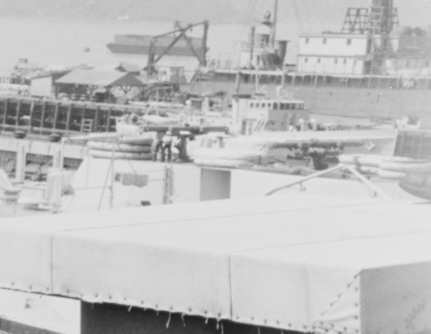

PostPosted: Fri Aug 02, 2024 10:33 pm
Posts: 1611
Location: The beautiful PNW
So the quest to understand the Utah in her final fit continues. Clearly visible in her August 1941 refit image, we see a canvas covered object on the roof of former Turret #3. I have seen several references to her carrying a "gun director" amidships. The image looks to be about the shape and size of a 12ft Rangefinder that Utah and many other USN BB's of her vintage carried, but my question is why? These directors were used to help guide the main battery and if used for secondary batteries, it would have been the 5/51 guns for surface action. Utah at this stage in life was a AA training ship, she mounted a MK19 AA director (Older 2 part type) and a MK33 director. Why would she carry a director for which none of the AA guns she carried utilized? I began to wonder if perhaps it was a MK44 since the Utah carried 1.1's, but I don't feel it quite fits the profile we are seeing. Anyone have any thoughts? It has been recently installed as she did not have it there in 1940, so it wasn't just a hold over?

PostPosted: Fri Aug 02, 2024 11:38 pm
Posts: 512
it is a 12' range finder & she has 2x 5"/30 cal gun mounts on the stern so range finder maybe used for them.
PostPosted: Fri Aug 02, 2024 11:48 pm
Posts: 1611
She had 4-5/38's, 2 in enclosed mounts on old Turrets 4&5 and 2 open on the Port side amidships opposite of the 5/25's. While I do suppose the 12ft rangefinder could be used, seems an odd pairing as it would not be one found on other ships I am aware of. The MK33 on the Port Bridge wing would have served the purpose of both Surface and Aerial ranging and direction for those mounts.

PostPosted: Sat Aug 03, 2024 2:45 pm
Posts: 1975
You are overlooking the possibility that she was also training men to use the rangefinder, not just the guns.
PostPosted: Wed Aug 07, 2024 12:50 am
Posts: 1611
Dick,
I thought of it, absolutely a very real possibility. Just with her focus being on the AA training, felt a lone antiquated(but yes in 1941 still very in use) surface Rangefinder seemed out of place.
However-
It appears I need to take back my previous comment about the Rangefinder not being there earlier than this refit. I located an image that shows the Utah being prepared for her final refit in June of 1941, and much to my surprise she sports not one but two Rangefinders. It does not show the Rangefinder in question as the former #3 turret can't be seen, but on former Turret #4 and #5 there are clearly two types mounted. So very real possibility that she was being employed in training or equipment evaluation and one of these could have been relocated amidships or another one was already there and just can't be seen.
