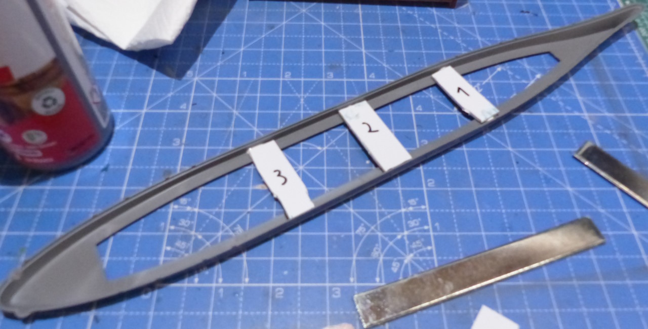

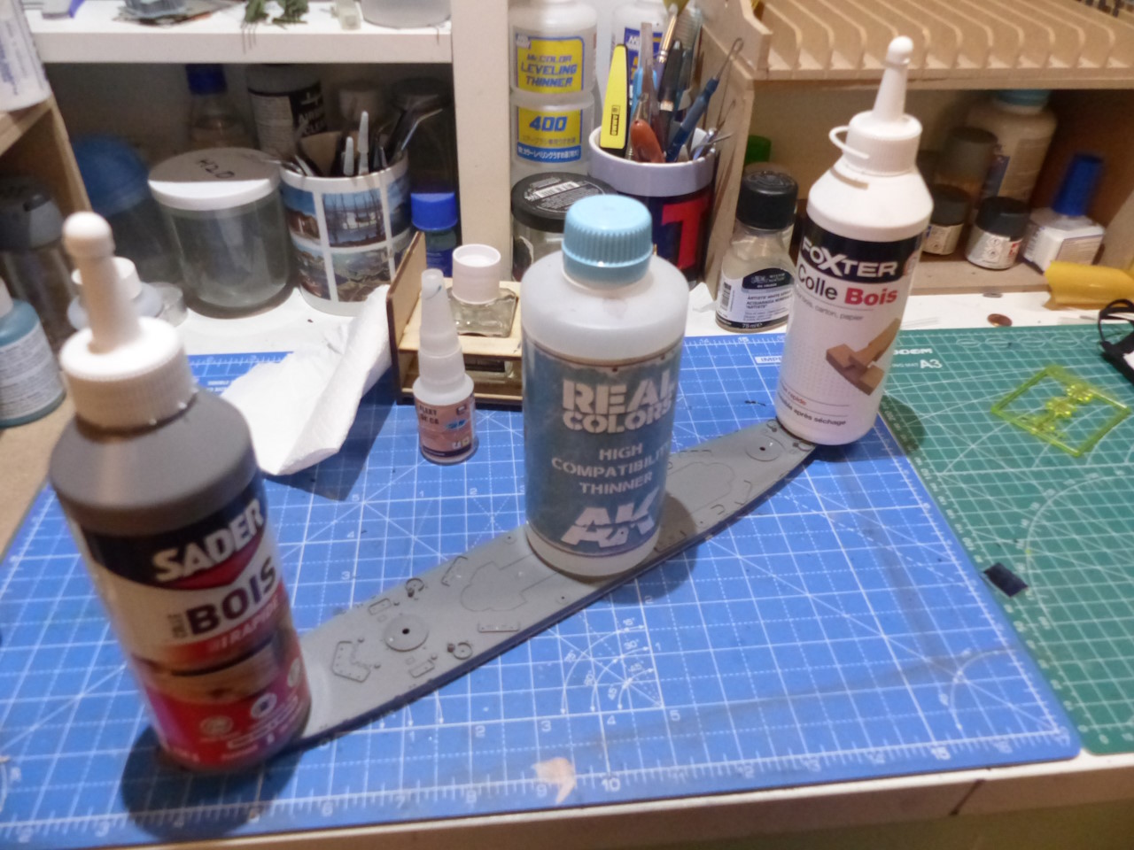

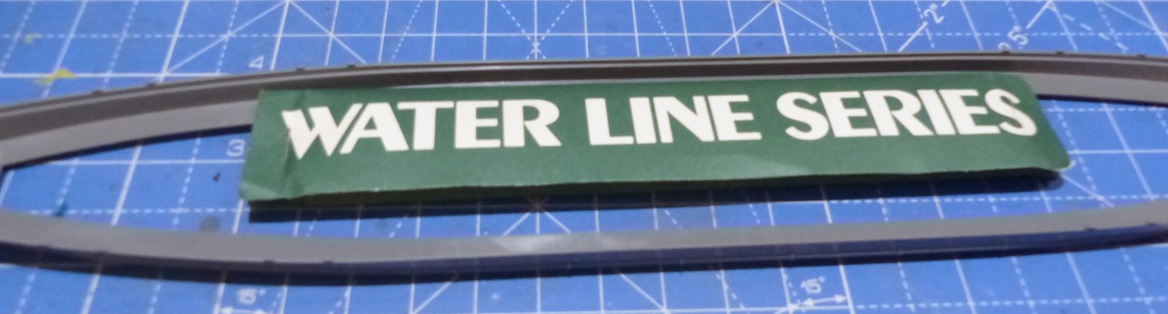

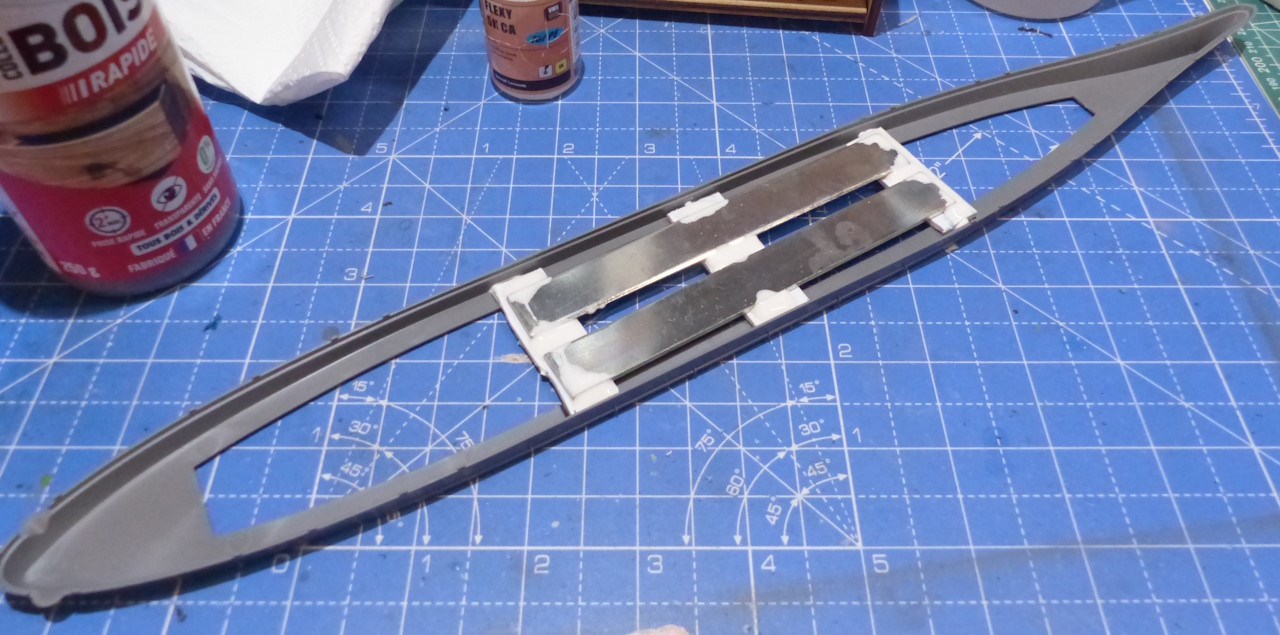

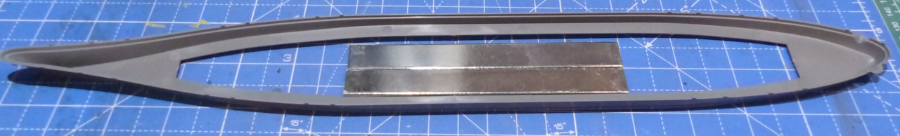

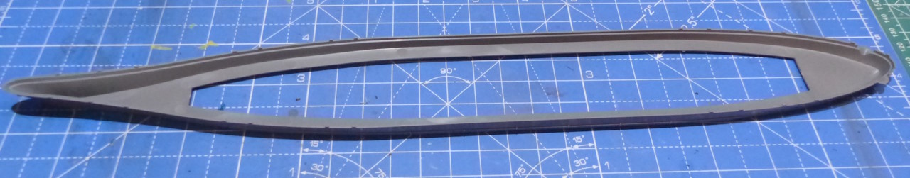

Let's get down to business with this great little kit.
I hesitated for a long time about doing it in waterline, but in the end the full hull option was chosen.
With the waterline in mind, I had taken some weights out of the rod box, which must have come from an old Yamato.
The main bridge is installed:
and we weight it down so that nothing moves

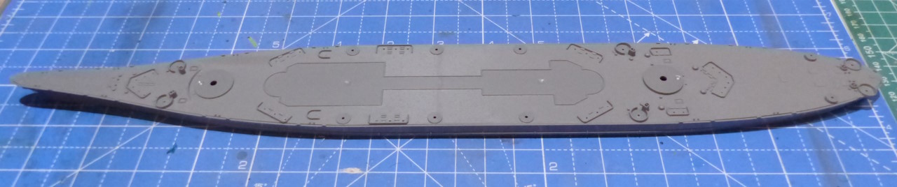

Puttying the hull joints
And after a big sanding session, we apply the black primer.

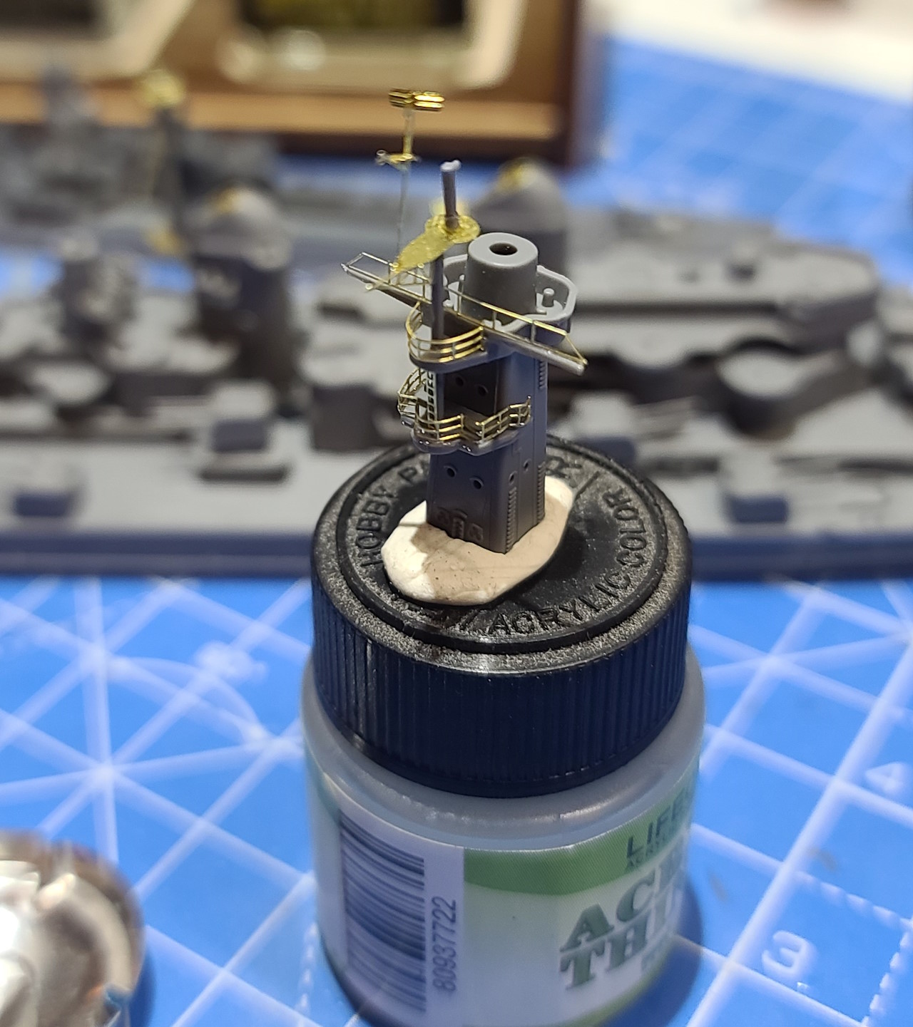

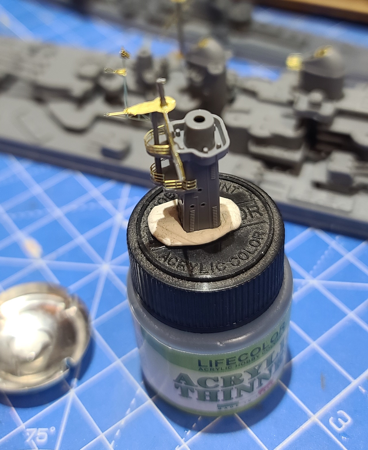

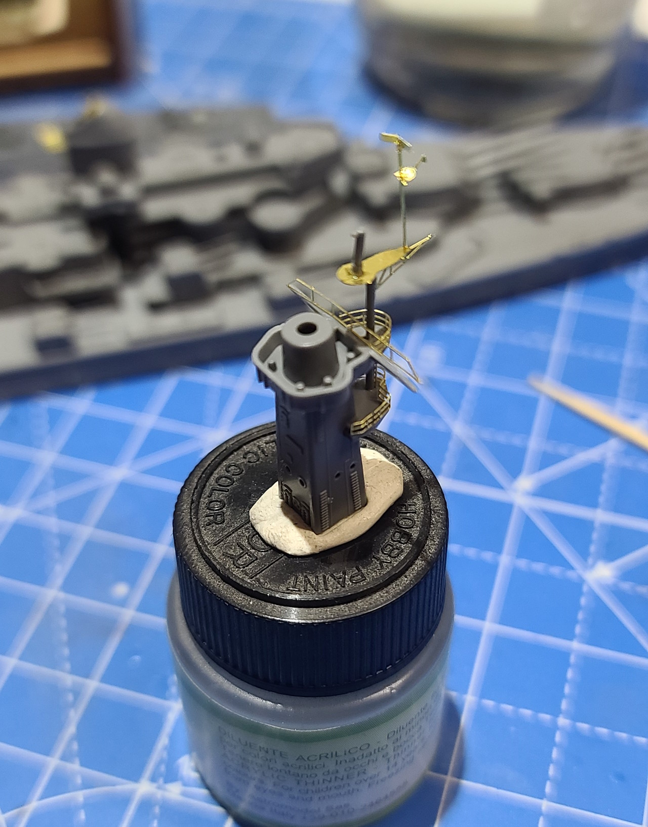

We're concentrating on the main tower, adding the last PE railings and a few other knick-knacks.
Next up is the radar... 12 PE coins for this one...
Let's move on to the directors, there are 4 to do, but it takes time to fold all this...
Taking shape
