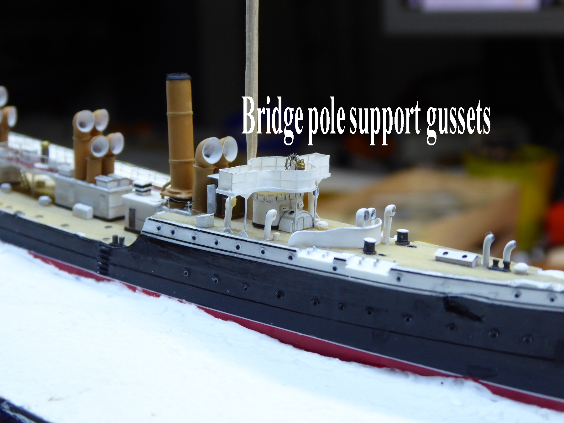

some new progress has been made

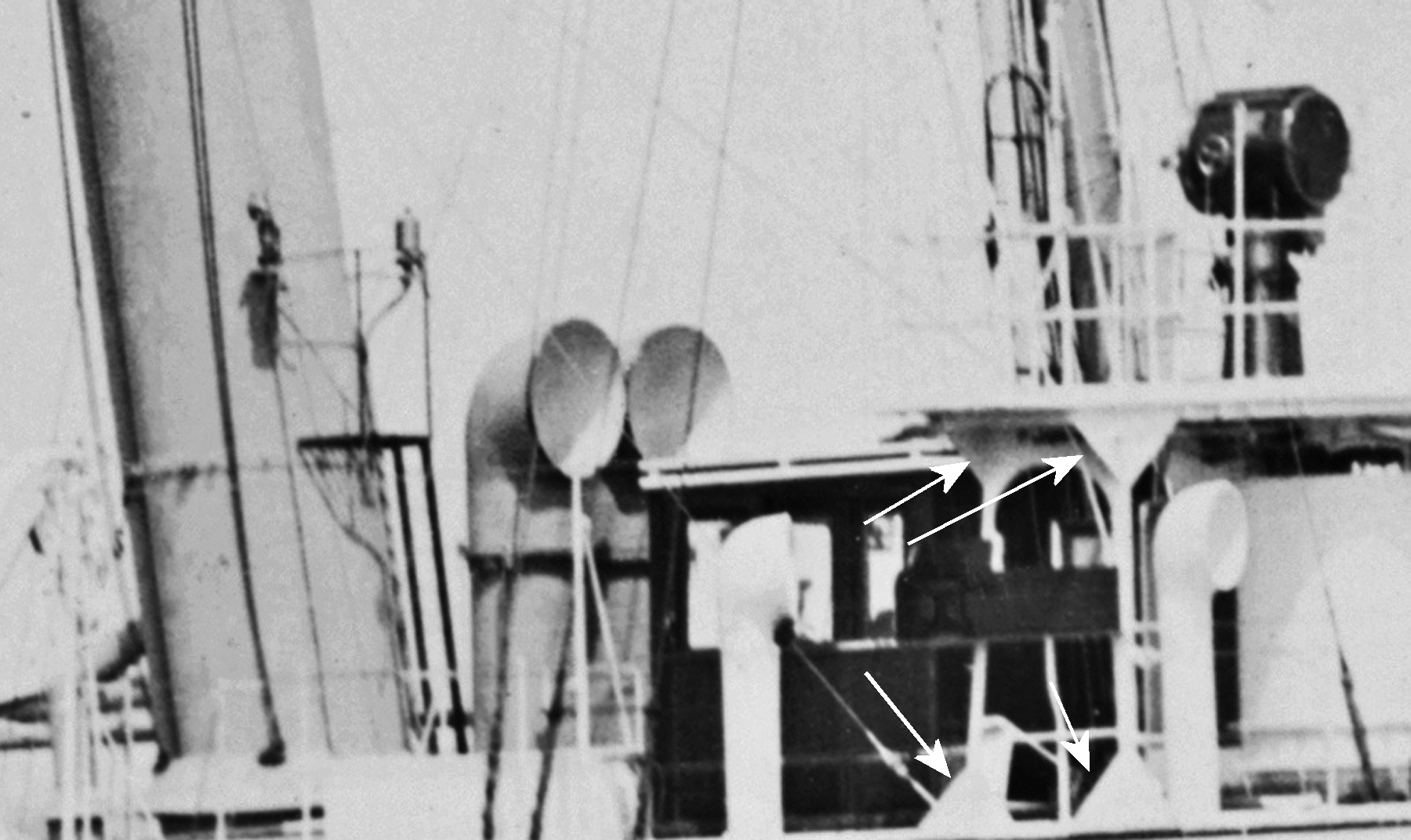

The cantilevered bridge could not stay up with willpower alone...
in the real ship-- it was supported fwd and at the sides
All ships of the class had detail differences in their bridge supports
some were cross-braced as is ' usual '
On Halcyon they were rather different
the uprights had triangular gussets top and bottom
these were orientated
lower; fore and aft
upper; athwart-ships
here they are on the model--the braces were cu of white paper
and installed with matt tacky varnish

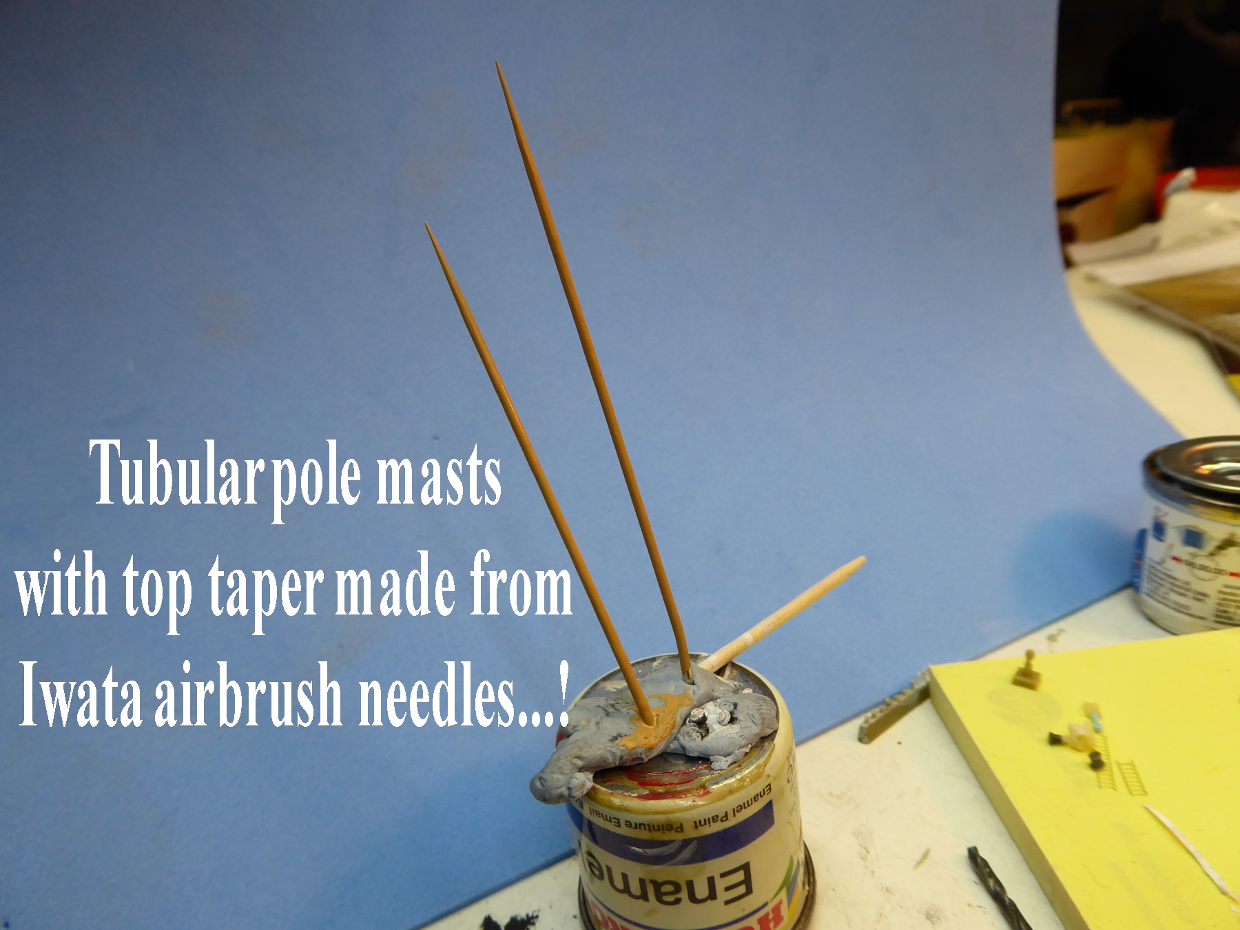

I was at the same time checking mast angles and clearances--I used a cocktail stick
( oversize to the masts but to ensure even gaps
The masts on the ship were parallel tube type with a sweeping taper at the top only rather then being conical

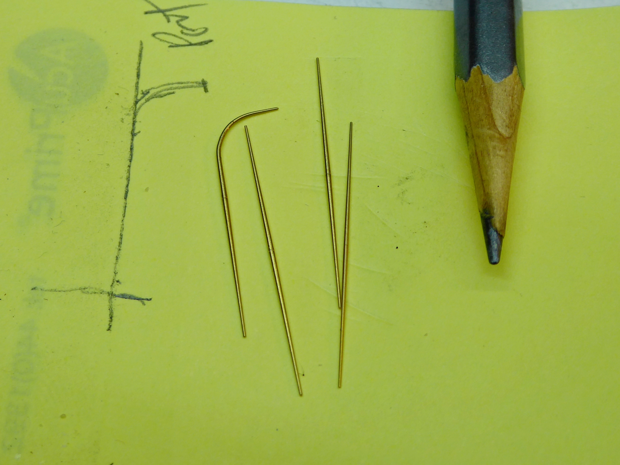

I made some masts out of stainless steel welding rod ...
but failed to get the positive curve taper....- numerous times!!
I searched for something I could use....
all knitting needles to large
and then .... found it --though this may appear sacrilegious.., !!!
but.... when on a mission...
I eyed up my spare Iwata airbrush needle hanging on the wall on its nice new packet...
and then-- after ordering an ( expensive) replacement... removed also the needle out of my airbrush !!
They needle diameter scaled up and measured beautifully...
Once I had nipped off the top of the pointy bit and made the cuts ...
there was no going back.... :whistle: :eyebrows:

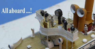

On any model-ship build -
some of the biggest time consumers are the ships boats...( still to come)
and the human aspect--the crew...
I actually actively dislike doing them both--
and nevertheless I go a little overboard on both :cool_2:
but with organic shapes in place its coming to life

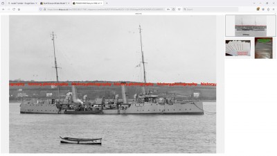

and amazingly....( hard to find in my time period )
another overall view from port=-- with ship at mooring
whilst not ever so sharp or clear--it does illustrate well the considerable height of the Aft ensign staff
-with my model ship being ship underway...
==> contrary to usual familiar RN practice ( flown from the gaff of mainmast ...)
My Ensign staff will be adorned with a White ensign!
