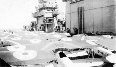

Here are some photos that may be helpful, taken about 1934-1936.
No vertical ladders are visible in the photos but photo quality might obscure any that are present. General arrangement drawings for Lexington show one vertical ladder on the port side of her flag bridge. Perhaps Sara had one there, too.
The object on the roof of the flag bridge is actually a 20' rangefinder. Saratoga was not fit with radar in 1936. In late 1941, she received her first radar set, a CXAM-1. At bottom is a good photo of sistership Lexington's 20' rangefinder.
Hope this helps.

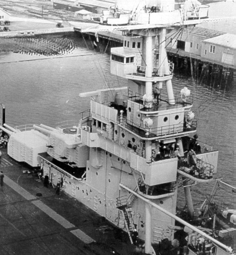

Continuing on the bridge: can anyone shed light on the two boxes on the aft end of the Nav bridge? These flank the small platform that juts out aft. Some sort of trunking? There is nothing on the underside of the deck, or connecting bits.
I also see the windows frames are quite thinner then depicted by the kit parts, at least in '37- '38.
PostPosted: Tue Jul 15, 2025 11:13 pm
Posts: 3103
Location: Mocksville, NC
That's an easy one (if you're asking about the bottom photo just above your question. Those are flag boxes for signal flags.
Hope that helps!

Thank you! They are mirror imaged, top/bottom, so I was not sure about them. The kit part should probably be cut off flash with underside of the deck. The wee platform is for signal flags then. Makes sense.
