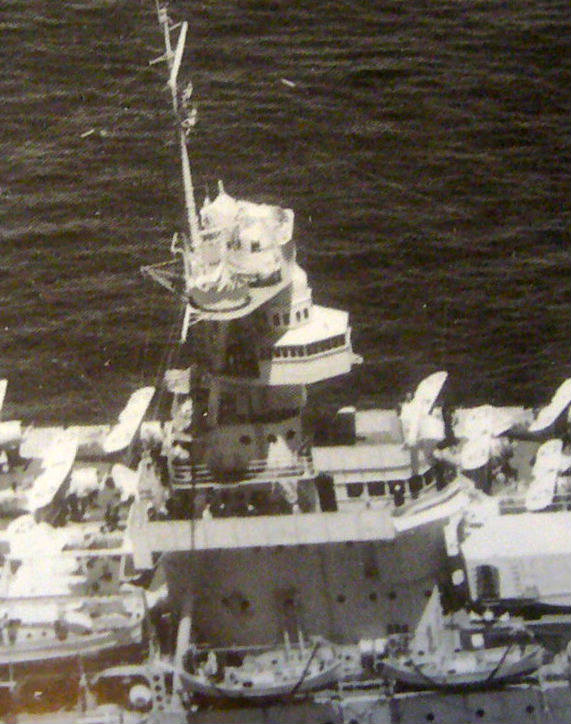

Yet another question. At the top of the bridge stucture is a
Platform with two round structures, one to either side. Depending on the photo, they look solid or have railings. My guess is canvas wind cheaters. I'm not even sure what they were for in 1938. Photos are not clear and NavSource seems down. Any help appreciated.

Early photos of Lexington appear to show the station with the most clarity.
The circular platforms in those photos appear to be surrounded with 2-bar rail covered in canvas. The rails appear to flare outwards slightly at the top. The structures on Saratoga in 1936 appear to be similar if not identical.
The photos suggest that the circular platforms could rotate since the opening in the railings appears at different clock positions in different photos.

If you are talking about the objects on the very top of the tripod, the circular areas held the "altimeter" portion of the MK-19 AA director system. A photo of one is at the bottom of page 99 in Stern's Lexington Class Carriers book. Each was paired with a main director element and these were located on that same foretop between the altimeters. Another set of directors was on the upper platform at the back of the stack. MK-19 directors on the Pensacola and Northampton class cruisers, as well those on many of the pre-war battleships, had been combined into a rotating structure more in line with how we now would expect a director to look prior to the outbreak of war.
Here are some MK-19's on Northampton. https://www.navsource.net/archives/04/026/0402626.jpg The circular extensions aft of the directors were for the altimeters, which have obviously not yet been installed.

The altimeter parts look at leat a bit like ship parts. I can't find any photos of the ranging parts that go in the center of the platform. The kit parts seem sadly lacking.
On rechecking the posted photos of the tops, all the ranging oarts are either shrouded, or censored.
- Dick J
- Posts: 1992
Re: Calling all USS Saratoga CV-3 fans
As I said above, the objects in the center of the foretop were the main parts of the MK-19 directors, seen here on Northampton. https://www.navsource.net/archives/04/026/0402626.jpg When the directors were later mounted in a combined structure, the part seen in this Northampton photo was bolted on the front of the rotating platform, a rangefinder bolted aft of it, and the whole thing was then enclosed. See Tracy White's MK-19 page here http://www.researcheratlarge.com/Ships/ ... 9Director/ The thing in the 4th image down is the actual director, which can be seen on the front edge of the rotating platform in the two images immediately above. That was what was in the middle of Sara's foretop. Aft of the stack, the main directors were closer to the stack with the altimeters mounted further aft on the same platform.

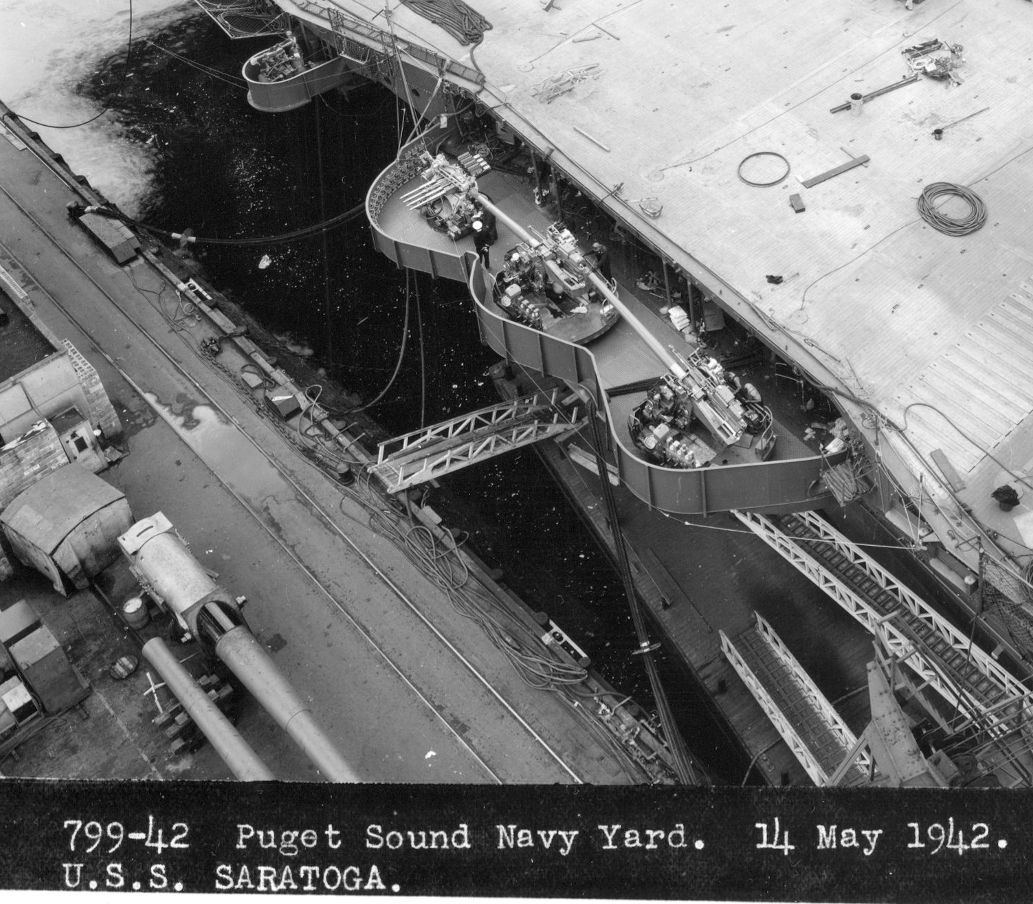

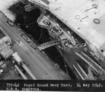

Hi all,
Can someone help me with the MK and Mod number of the 5"/38 single mounts (5"/38 MK ? Mod ? mount) installed on the Sara in 1942. Are they the same as the Essex class ships being built or the earlier Yorktown, Hornet, Enterprise, and Wasp. Or are these all the same MK and Mod for mount.
Thanks in advance.
Thanks in advance.
- Posts: 8576
I have a photo of a pair of the 5" guns during her 1942 refit at Mare Is. Once the issue with uploading photos is resolved, I'll post it here.Frank Fowler wrote: Fri May 01, 2026 4:30 pm Hi all,
Thanks in advance.

- Posts: 8576
Frank,
Here you go...
Here you go...
