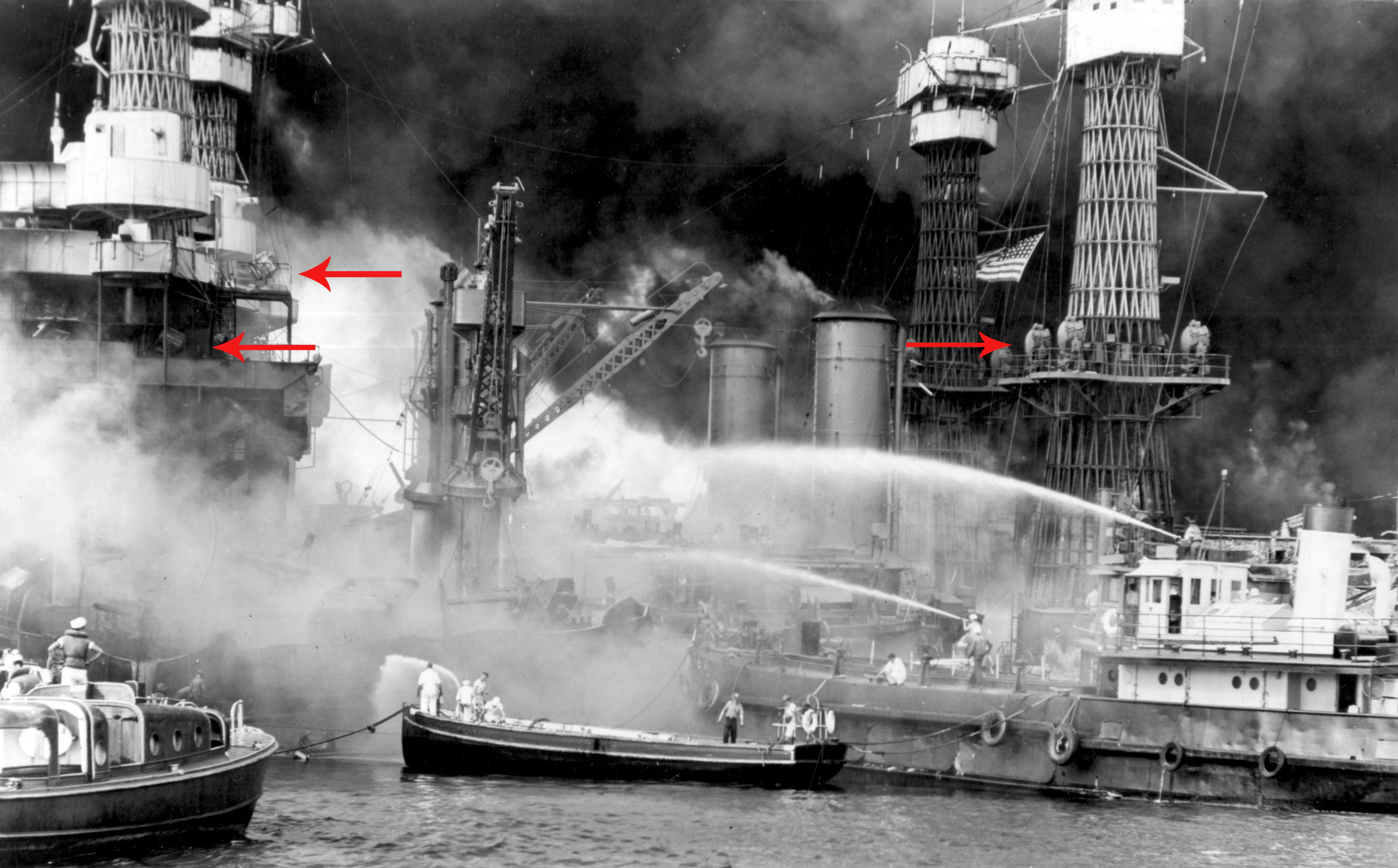

Found some additional photos, cropped them to show the forward funnel piping arrangement on BB-48. First one is from 1937, the second from 1939. Photos are from NARA II, via Roger Torgeson.
- Posts: 8555
Re: Calling all Pre-war "Big 5" (TN/CO class) fans
Comparing the picture that Jeff posted (left) to the 1937 shot I posted (right), it does seem like that pipe from the incinerator to the funnel was modified at some point.

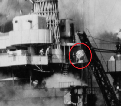

36" searchlight?
FFG-7
- Posts: 718
Re: Calling all "Big 5" Tennessee-class & Colorado-class fans
is at least a 36" when doing a size comparison with the 2 men to the left of it.
- Posts: 9063
I have to disagree. It's a 24" signal light. Compare it to the other 24" on the deck below vs. the 36" lights aft.
FFG-7
- Posts: 718
Dan, look at the size of the light compared to the 2 guys to the left of the light.
- BB62vet
- Posts: 3151
- Location: Mocksville, NC
In comparison between the photo presented and official 24" searchlight photos - details point to it being a 24" searchlight, not a 36". And also as mentioned, the size!
FFG-7
- Posts: 718
it appears I stand corrected because of this tho 1939 Wee Vee version.
- Posts: 8555
Thanks all! Appreciate the assist!

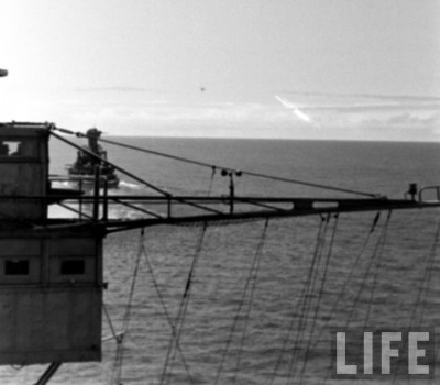

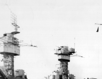

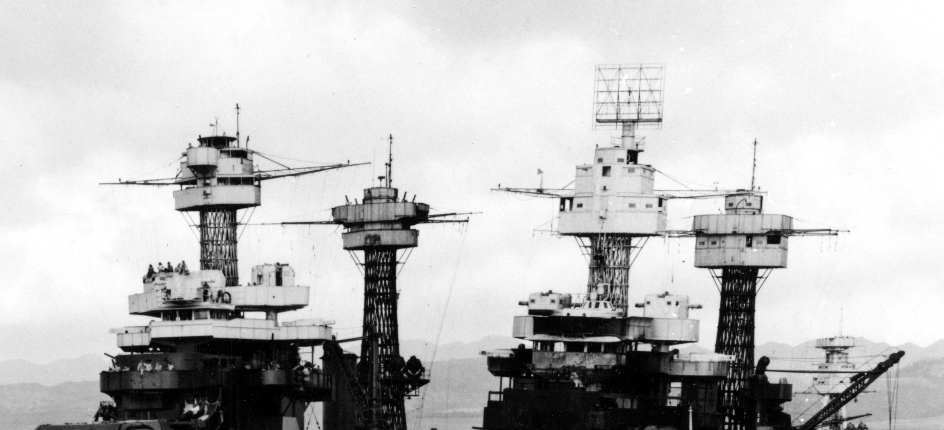

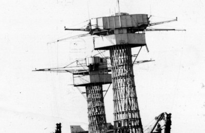

Are the yards on the forward spotting tops the same across the Big 5? I don't think the PE "lattice" included with the BWN California is correct. Before I get down a rabbit hole of using one of the other ships as template, I want to see if they are at least "similar", or similar enough to use for inspiration.
- Posts: 9063
IMHO, i do think they are the same. I find it easier to see from astern when possible. I compared WeeVee's to TN's and then to CA as best I could because I found only one good pic of hers from astern.
