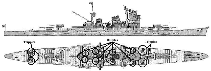

Hey you guys, the only drawing I have found of Myoko's AA gun positions is this one, and it just pixelates when I enlarge it. Do you think I am correct in the positions circled? It's basically pretty easy to up-date to a 44' and I have all the gear, but just checking!
PostPosted: Fri Oct 02, 2009 10:12 am
Posts: 8813
L & W, also the Model Art volume on IJN drawings for cruisers has good overheads. Will try to scan something over the weekend. Gonna be busy though.
PostPosted: Sun Oct 04, 2009 6:44 pm
Posts: 591
Dan, Any luck with the scan?

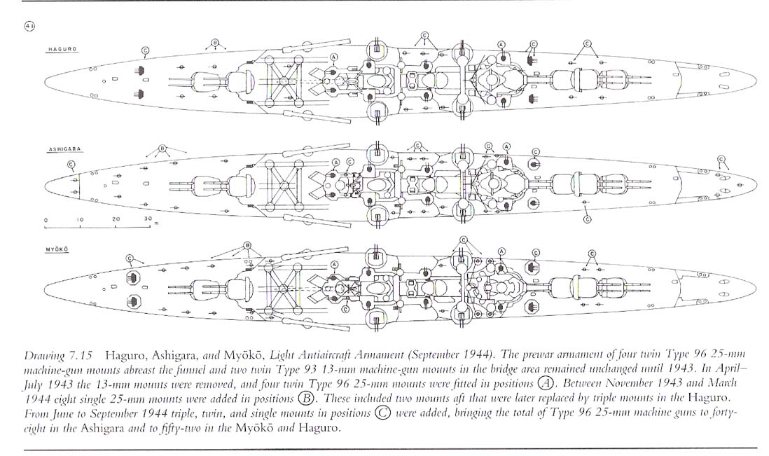

Whatever happened to patience as a virtue? From L & W. p343
PostPosted: Mon Oct 05, 2009 10:28 am
Posts: 591
Thanks Dan, great help. I keep forgetting that you guys are a day behind us.
