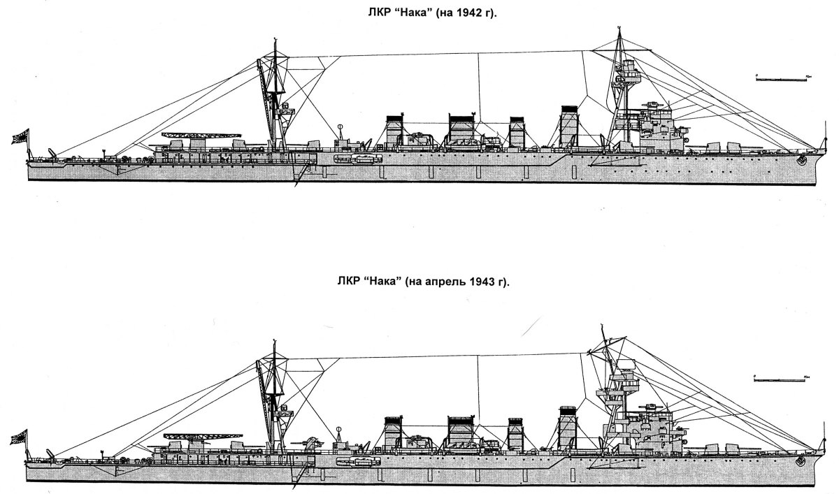

Was there much difference in Naka in 1933 and 1942? I'm looking at the Aoshima 1/700 Naka but want to do it in WW2 condition.
thanks
Mike
PostPosted: Sat Jun 12, 2010 10:14 am
Posts: 352
Location: roma, italia
from a russin book on japanese cruisers of Apalkov, and from the bible on japanese cruisers of 2ww, lacroix/wills
ciao peppe
File comment: from lacroix/wills japanese cruisers of pacific war
File comment: from a japanese source
File comment: from a russian source
File comment: from apalkov japanese cruisers 1918-1945
PostPosted: Sat Jun 12, 2010 6:15 pm
Posts: 643
Location: England
Hi
Thanks for the pics - providing the Aoshima kit of Naka is accurate for 1933, these drawings show theres more work involved than I was hoping for. Plan B I think would be to see if I can modify either Jintsu or Sendai as Naka in 1942 then.
thanks
Mike

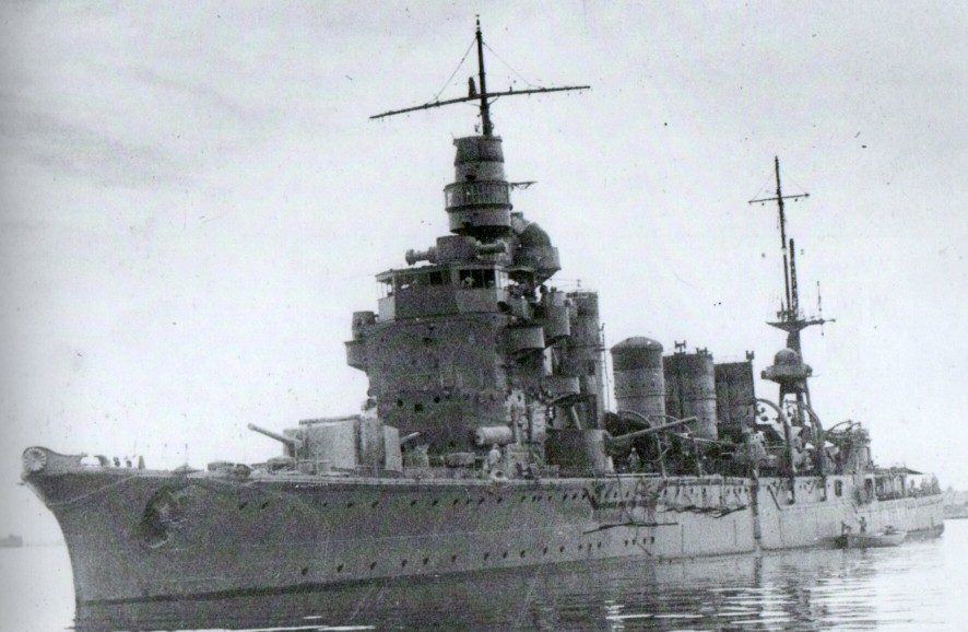

PostPosted: Sun Jun 13, 2010 4:33 pm
Posts: 8840
Naka 1942, via Fukui. One of several of her after being torpedoed. DOn;t think she changed much, aside from AA into 1943
Revised photo w/o lines
