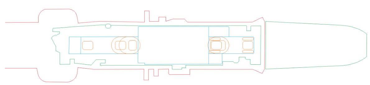

Here is the outlines I came up with for the aft portion. I am thinking that outer red area is the deck on top of the main deck superstructure, green is main deck superstructure, and blue is upper deck superstructure. though not for sure on the full shape of the blue stuff.
proflooney
- Posts: 213
- Joined: Fri Nov 12, 2010 3:19 pm
- Location: Moline Illinois
Re: Calling all USS Fletcher class (DD) fans
ok midships. it didnt show good over the plans so moved it off. the green is what I come up with for the main deck superstructure, red for the deck on top of it and the blue for next level superstructures.
if anyone sees something wrong with these pls point them out so I can adjust them properly
- Posts: 3889
The 20-mm guns are on the main deck and there is a bulwark on main deck going out to the hull edge.
BIW Engineering Drawing TIFF images 365 and 366 show the superstructure deck at 01 level.
