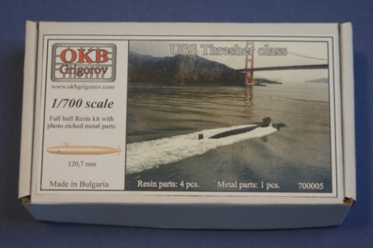

Thanks guys!
I really appreciate the information you all have provided me, online and off. I have learned more about Greenling and the Thresher/Permit Class submarines than I ever thought I would, in fact my buddy said that I knew more about it than he does.
I received the OKB Grigorov 1/700 USS Thresher class kit and it is simple, but nice.
It compares favorably in size with the 1/700 JAG WL kit I bought from D-Boy (Thanks again D-Boy!) The sail is essentially the same size and the lengths are very similar.

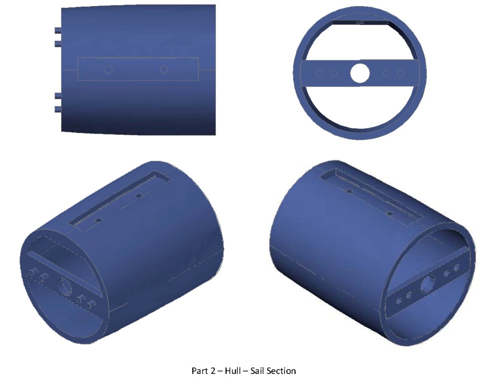

Hi Guys :wave_1:
A lot has transpired over the last week with regards to my plans for building the USS Greenling for my friend. First, I obtained a decent set of plans for USS Permit. Second, between the plans, the print and photographs of Permit class subs, I was able to derive what I think are reasonable dimensions for Greenling's sail. Third, another friend of mine told me that he has access to a stereolithography (SLA) system and said that he could use it to make the small parts for me.
The SLA method uses an ultraviolet laser that solidifies a thin liquid photopolymer resin. After one layer is solidified the SLA elevator platform is lowered 0.05 mm - 0.015 mm (0.002” – 0.006”) and the process is repeated. This continues until the whole part is completed. The advantage of this is that the parts can be generated straight from 3D AutoCad drawings, which I have recently learned to do. I therefore "built" a solid model of Greenling using AutoCad Civil3D, and it was a LOT of fun. I then dissected the model to make parts no larger than 4". And it was a LOT of fun too.
I’ve started a build log on the Subcommittee forum and at the risk of doing something improper the results are shown below as well. More detail of the process I went through is provided on the Subcommittee forum at http://s181686668.onlinehome.us/phpBB3/ ... 658#p67658. Due to the 10 pic limit per post here, Part 10, the propeller shaft, is not included. I hope you enjoy the images.
CHEERS!!!
