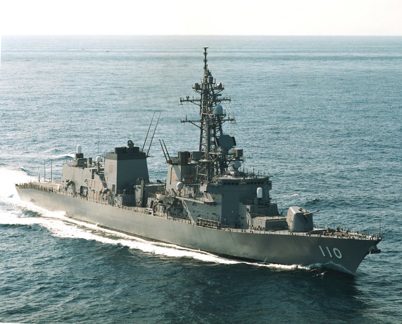

PostPosted: Tue Aug 09, 2011 10:03 am
Joined: Sun Jul 31, 2011 6:18 pm
Posts: 372
EJM wrote:
I've always been quite disappointed by the lack of offensive and defensive capability of the O.H. Perry class frigates, especially since all the Standard missile launchers have been removed from all US vessels. The poor ships right now couldn't defend a convoy of rowboats much less an aircraft carrier battle group. :( Torpedo tubes, CIWS gun, plus another smaller gun amidships, really isn't much at all.
I was thinking of the following:
Replace the Phalanx with RAM.
"Maybe" keep the OTO Melara 76mm gun amidships?
Keep the torpedo tubes.
Would it be possible to put a 5"/54 cal. Mk.45 or a 5"/62 cal. Mk.45 gun on the bows of these ships? Or what about a small 8 cell VLS for ESSM missiles?
Also, why couldn't these ships have been modernised for littoral warfare instead of the US trying to buy and build the new LCS ships?
I always felt the same about the Perry Class (and I served on one), but thought the ship was otherwise well thought out.
Given the age and condition of the hulls, it is probably better to build new ships, and frankly I think the Japanese Takanami class destroyers represent what the Perry class should have been (granted they are longer and have a greater beam):
- 5" gun
- 32 cell Mk41 VLS
- 2x MK15 Block 1B CIWS
- Anti-ship missiles
- SH-60
- Towed array sonar
- Torpedo tubes

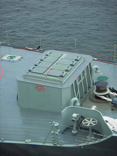

PostPosted: Sat Oct 22, 2011 1:10 pm
Joined: Wed Sep 21, 2011 8:06 am
Posts: 4
Location: New York, NY
It's a shame that the Mk13s were removed, but the SM-1s were no longer supported. It's funny how they didn't remove the G from FFG. The Australian FFG's were upgraded with an 8 cell Mk41 for ESSM forward of the Mk13 plus other upgrades in early-mid 2000's. Notice how much the VLS protrudes above the deck. This cost them $A1.5 billion for 4 ships and they retired the last 2 to help pay for it. Hopefully this and the Anzac upgrades will tie them over until the Hobarts go into service.
The hull life on the US FFGs are close to the end so upgrades are not very cost effective. Speculating on what-if's is fun but not very realistic on a 30-40 year old hull. Never liked the single screw configuration either, but she can haul-a$$ when she needed with those gas turbines cranked up. We were on a 40ft sailboat in San Diego harbor once and an FFG roared by us like a runaway freight train!

carr wrote:
.... where the Mk13 was, it would still only be possible to fit, at most, two 8-cell modules arranged fore and aft. Side by side modules won't fit.
How is that? The Mk13 had mag space for 32 missiles plus the handling gear to hold, move & load them. How come the same area can’t have more than 16 loaded in VLS?

GMG4RWF wrote:
Because the Mk13 magazine stores the missiles in concentric rings around the launcher like in a gun turret magazine, whereas VLS puts them each in their individual cells, each ready to fire. There's a significant difference between packing missiles as tightly as possible for storage versus packing them for firing with no physical preparations.

carr wrote:
Each VLS cell must have room for exhaust handling/venting, cooling, electronics status monitoring, launch door machinery, etc. I don't have the exact numbers in front of me but the spacing between missiles in the VLS works out to around four feet or so. There's a cost associated with having every missile ready to launch and that cost is room.
They both carry their missiles ready to use (as did the Mk26). The Mk13 (& 26) simply strikes them up onto the rail first, then they’re ready to fly. The exhaust system for the Mk41 is internal of the container which is about 2’ to a side, & the Mk13 holds is missiles in an elaborate Chain-link system (kind of like a sideways tank track with hooks, a similar system was used on the Mk26 but it wasn’t set as round).
The main difference in the mounts are the maintenance areas for the GMMs. The Mk13 had a cramped cubby hole in the middle, that all the maintenance had to be performed from, the Mk41 has huge gantries all around each 8-cell block (Ironic it has virtually no maintenance requirements to the actual cells). The cells themselves were much larger as well, as they were required to handle the RGM -109 Tomahawk (a missile about the size of a WWII torpedo). The Mk13 was never designed for such a large missile & couldn’t be refit for it (a whole new launcher would result from the attempt). Still the Germans fitted an 8-cell VLS forward of their Mk13 without removing it at all. As for it being round, any such refit would necessitate structural modifications to fit the new launcher (while your right that an “el-cheapo” refit would only allow 1 full rack (7’x14’), with full maintenance gantries, within the diameter (203”) of the Mk13) a proper rebuild would allow at least 3 to be fitted (that’s 24 tubes) & if the USN asked them nicely, I’m sure the manufacturer would be glad to build an independent (3 cell) loader arm which could be fitted just forward of the cells.
Having said that I still think the best fitting here would be the Mk49 RAM launcher with no reloads (21 on mount, which I believe is what’s planed). A Mk29 could also be mounted in this positions. If you place it a little forward you could also mount a pair of crossing Mk141s just ahead of the bridge (as someone previously suggested). The Mk75 cap-gun should be removed & replaced with point defense (though instead of 1-Mk15 amidships, a pair side by side (4 total) would be better).
