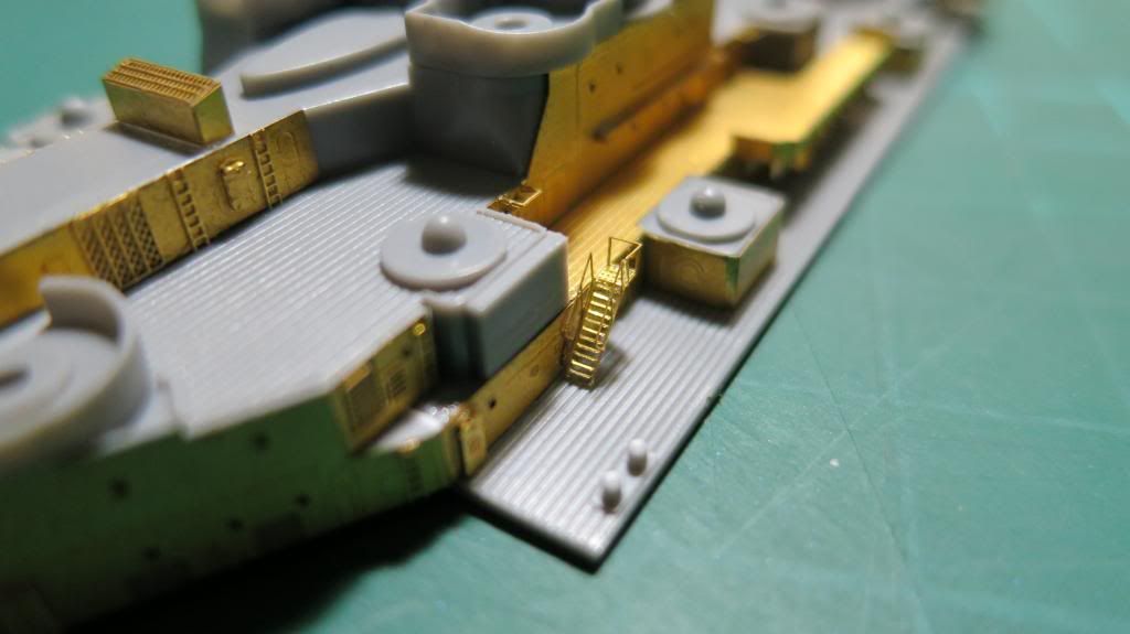

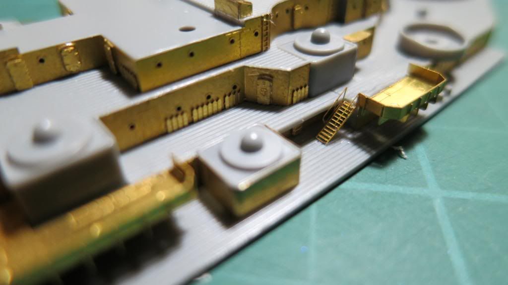

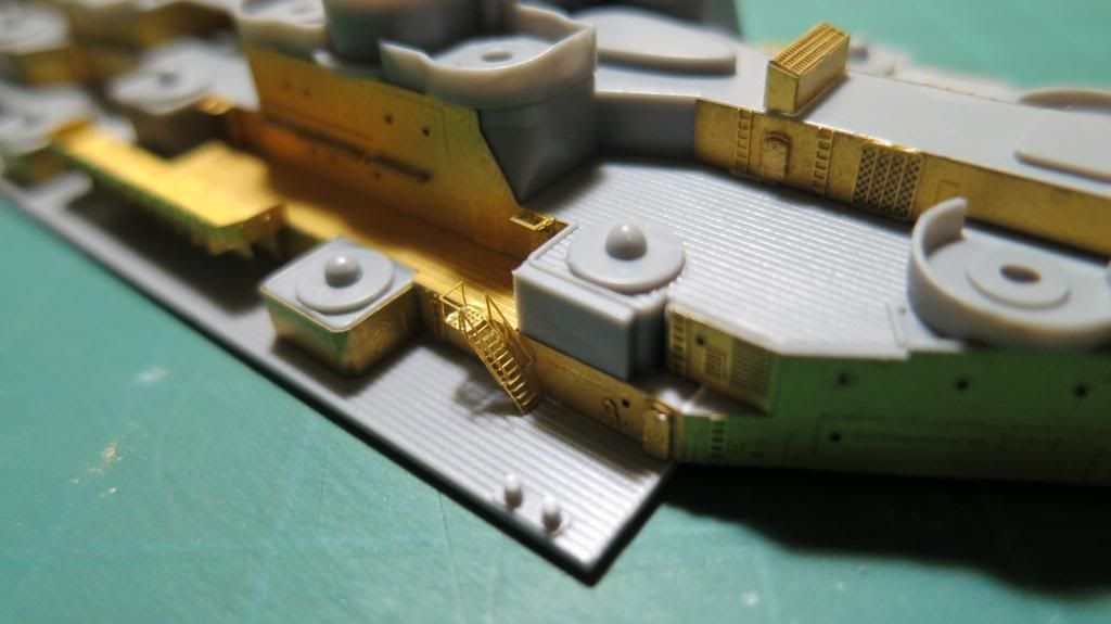

Hello, some update here, more PE work.
Not sure what it is, should be some small crane i think.

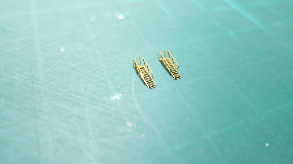

1st 2 stairs, Not sure whether i did it correctly or not, but i think is ok for 1st timer right? :big_grin:
Finally done all the stairs after hours of focus.

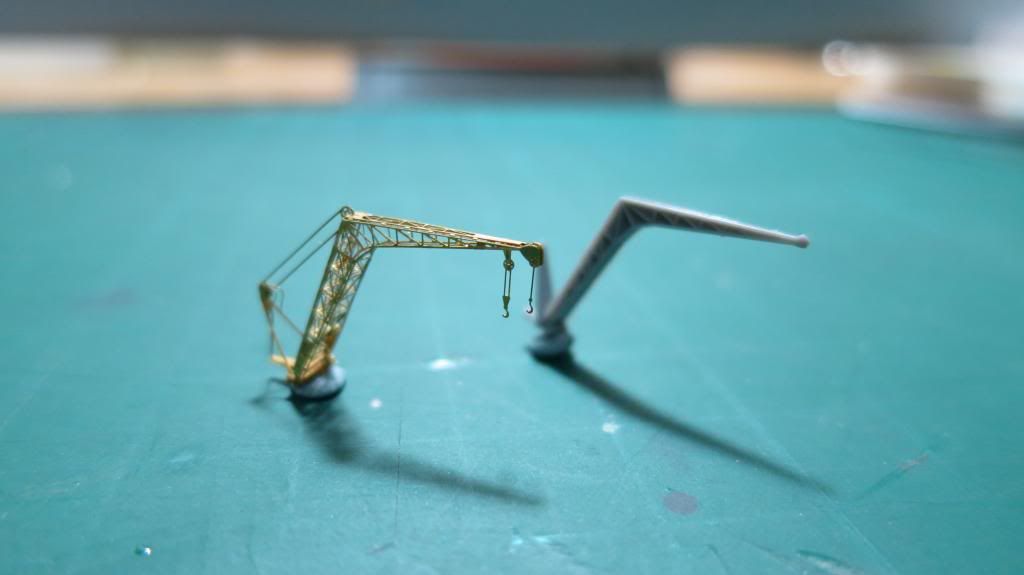

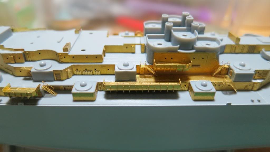

The aircraft crane. 2 hours of focus, worth the effort.

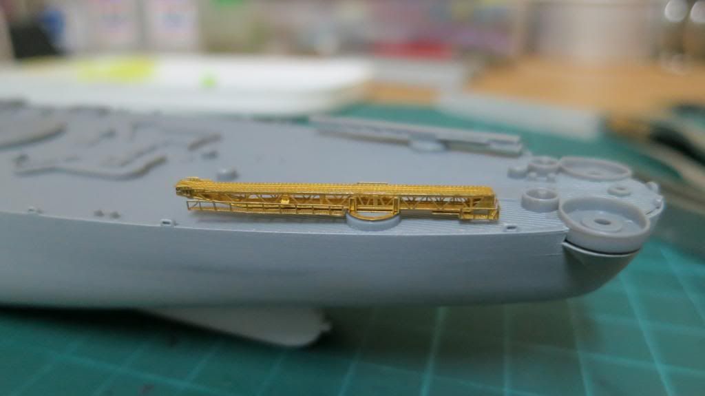

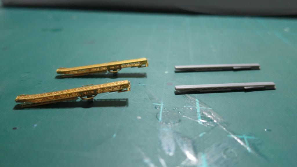

Rail that hold the aircraft, really improved the looks alot.
These PE are really awesome, worth the time and effort.
Thats all for now. all comments are welcome.

Looks sharp!
The first photo of the "small cranes" is training/practice loaders for the 5"/38 guns.
PostPosted: Mon Mar 17, 2014 7:08 am
Posts: 2588
Very nice PE-work!
The "rails that hold the aircraft" are in fact the catapults which serve to launch the aircraft from the ship, but probably you knew this. They look very good indeed!

Thanks alot for the input, honestly, I only started to have interest on Navy lately, have very little knowledge on ships and their parts and terms. Very grateful for the correction from you guys. :woo_hoo:

Enjoying this build. I have a question about the PE panels that are added to the vertical structure. Where the top edges meet the horizontal edges do you need to do any filling for a smooth transition? Same for the tops of the turrets where they meet the vertical sides. I'm wondering how you go about making a seamless transition so it doesn't look like a plate and more like it's part of the structure. Looking at the photos everything looks great to me. But I know how photos can be different than when you're the builder. I hope that made sense and looking forward to your thoughts.
Dave
PostPosted: Tue Mar 18, 2014 7:42 am
Joined: Mon Sep 02, 2013 12:57 am
Posts: 27
Dave
Hello, there is no way to avoid the the gap without any filling, what i did is when i stick the PE, i apply the superglue near the edge, then after stick on the plate, apply liquid superglue around the edge and let it sip in. But till now, cant really tell is the gap is still there without priming. Hope I answered your question. :big_grin:

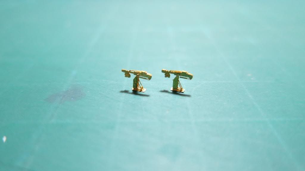

The PE single AA gun stand are flat, not like that much. I cut off the plastic AA gun and replace the gun to the plastic stand.
thats all for now. all comments are welcome. :)

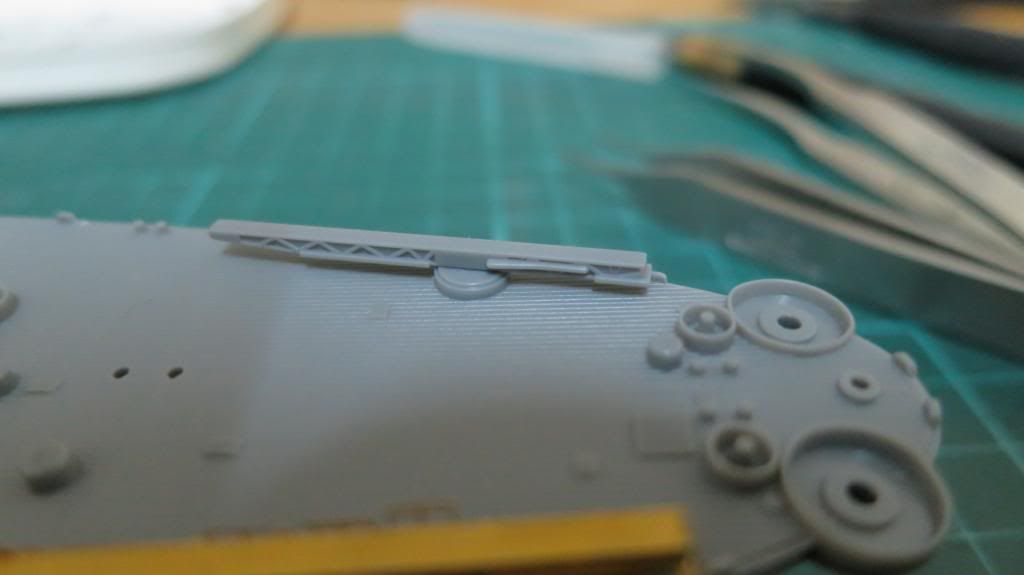

I am amazed at how you got some of the molded on detailing removed without messing up the deck detailing. How did you do that?
Gabriel
PostPosted: Tue Apr 22, 2014 7:41 am
Posts: 27
Hi, Im using this. place the blade 180 degree flat and slice it through. The blade is sharp enough to cut through without forcing too much and damage the deck. Same method i use to remove the mold in stairs. :big_grin:

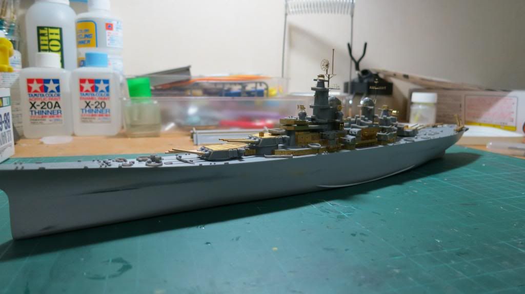

Railing PE added, superstructure primed.
Hull red on, deck and superstructure glued, railing on the deck glued.
Masked up to the waterline, AS-16 Light grey on and start masking the sexy camo.
So sorry, forgot to take photos of 2nd and 3rd stage of the hull camo process. These are the outcome.
Due to some grey sip through the masking and stained the waterline, I respray it, mask the full hull and start working on the superstructure camo. Some photos forgotten during the progress.
Camo of the superstructure done. Some touch up is needed. Finally relieved. Hopefully not too bad for this 2nd ship.
Thats all for now. Next will be the deck. Thanks for the time. All comment are welcome. Have a great day ahead. :woo_hoo:
