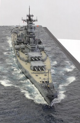

I've tweaked and changed my ocean methods quite a bit over the past couple of years. I have worked very hard to develop these strategies so that they conform to the following criteria: Cheap to make, easy to do with easily acquired materials, permanent, fast, non-threatening to the finished ship, and realistic. Here is my USS Wisconsin build that uses the walled-off oat method (below), covered with paper towel and finished with paint, airbrushing, and rayon cotton batting. While I probably wouldn't do a sea with oats these days, the basic concept of covering a textural surface with paper or paper towel to 'bridge' the texture is the key to my wavy water. Ultra calm water requires slightly different approaches. I've tried to lay everything out as best I can in the following links and tutorials.
As far as I can see, a sea has roughly three aspects to consider: The overall sculpt of the initial sea form, The surface treatment of the sea (wavelets, waves etc.), and the painted finish including wake effects. Each one of these aspects has to be convincing in order for a sea to look realistic.

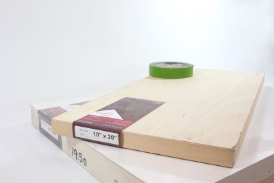

File comment: For my base, I use pre-made artist's panels. These are nicely made and cradled from the back for support. I'm not a fantastic carpenter so have tried to make this aspect of my diorama as simple as possible!

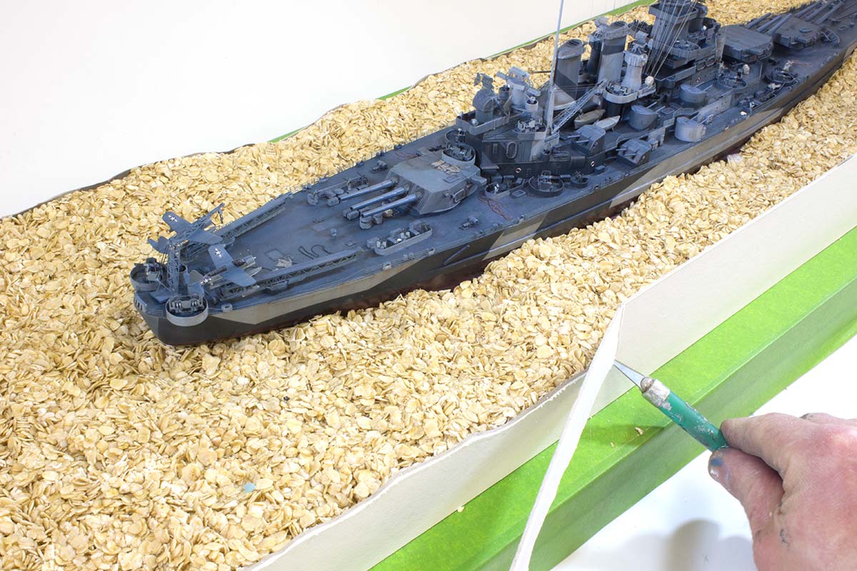

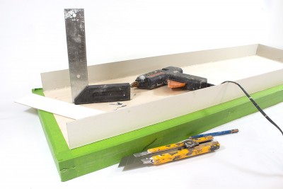

File comment: Using heavy artist's card-stock, I construct a low retaining wall around my masked off perimeter. I use a 45 degree ruler to ensure that the walls are 90 degrees square up and down.

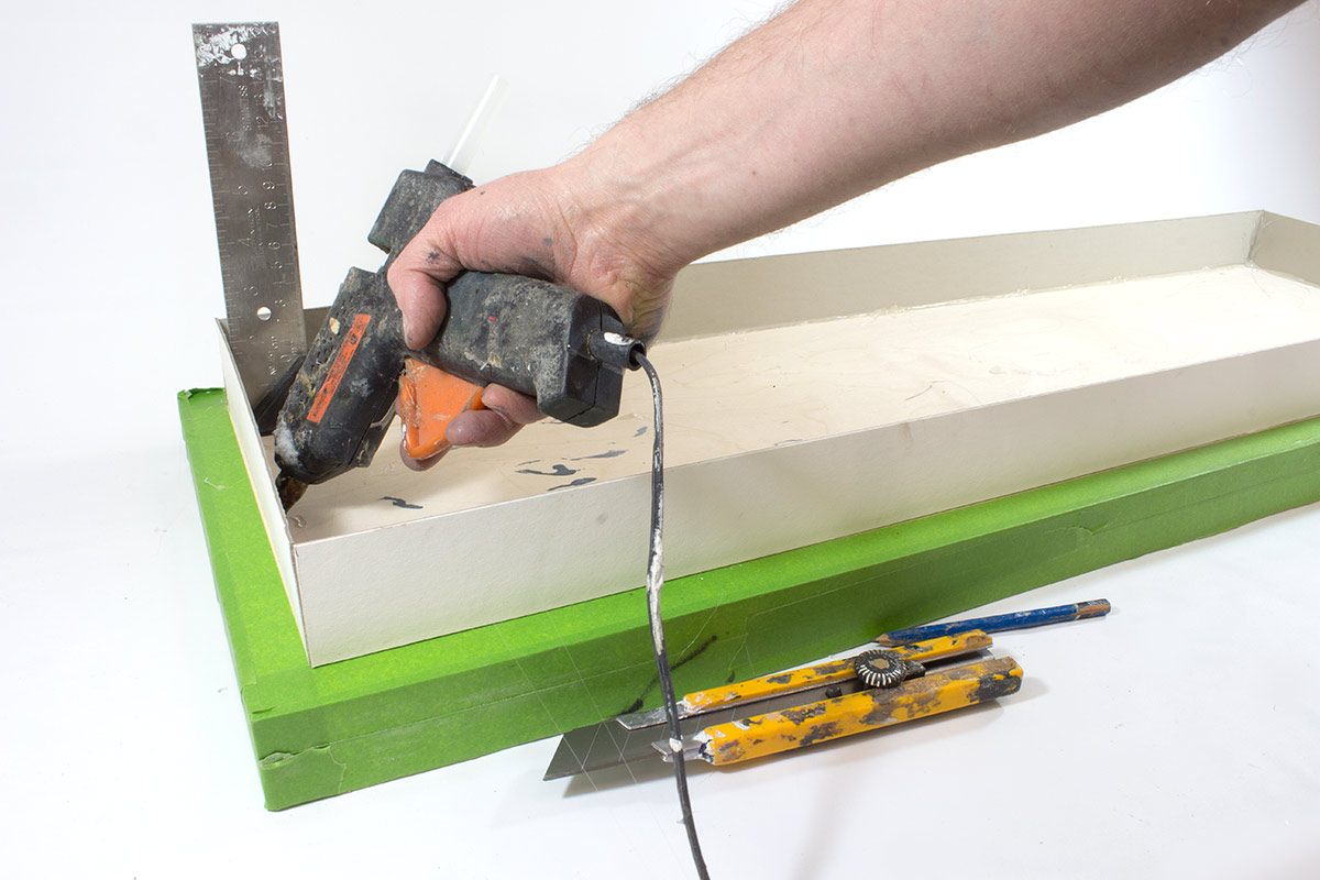

File comment: I construct the wall with a glue gun. I make sure to run a thorough bead of the hot glue around the inside perimeter to prevent any further wet materials from seeping out the bottom.
File comment: Using the hot glue gun, I attach my water-lined or un-water-lined hull to the wooden base. At 1/350, I water-line larger ships, but would keep smaller ships like a destroyer full-hull.
File comment: I dump bulk-purchased dry OAT BRAN, (not regular oats) into the walled off area. NOTE: THESE PICTURES SHOW ME USING REGULAR OATS, BUT I'M FINDING THEM TO BE A LITTLE TOO COARSE SO I NOW ONLY USE OAT BRAN. Using my hands and a flat brush as a tool, I manipulate the oats until I like the look. I love that I can do this indefinitely until I am fully satisfied.
File comment: Using a bulk amount of CA glue that I can get easily where I live for about 20 bucks, I carefully squirt the CA onto the oat surface. I am careful to get every square inch soaked. I squirt liberally along the cardboard perimeter where the oats meet as well as along the hull. I have had some minor issues with frosting from the CA. The only time I've had serious frosting was when I did this with sawdust outside on a cold day. Sawdust will produce smoke as it cures which can fog the model. Oats do not do this hardly ever for some reason. Any fogging that might occur can easily be removed with paint thinner. If you try to protect your ship, be wary of the possibility of the CA running up and into your mask and bonding the masking tape or whatever to the ship. Bad scene.
File comment: Within minutes, the CA cures and the oats will be solidly frozen in place and thoroughly bonded to the cardboard wall. Believe me when I say this is hard...like wood! The process of adding the CA doesn't disrupt your dry sculpt of the oats. It' now a simple matter to trim along the wave forms.
File comment: This HMS Howe is coarsely carved pink styrofoam that has been covered with regular paper and clear medium...sanded and then painted with many layers of gloss medium. A sanded oat surface, finished with paper would give a similar look.

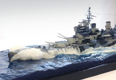

As I mentioned above, foam is my go-to process these days. For every type of sea condition where waves are present, it is possible to carve foam in such a way so that when it is covered with either paper or paper towel, the result will look convincing. Below are test examples of different foam carvings that have been covered with paper towel.
I have recently discovered that it is very easy to simply glue down one long piece of paper towel by first spraying aerosol contact cement to both surfaces, waiting for it to get tacky, then pressing the paper down. After thoroughly buffing the paper towel with your hand and fingers, it will take subsequent paint layers without wrinkling. Wrinkling should always be avoided as it a dead giveaway that can ruin the overall effect.

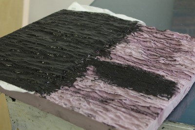

File comment: Here I have used a dremel tool with wire brush attachment to create coarse wavelets. Covered in paper towel and many layers of paint, the final effect can be quite convincing. I used spray contact aerosol to do this. One long sheet of paper towel.
