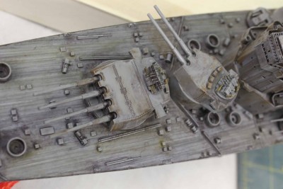

The concept is really simple: Basically, you shade the individual boards with a pencil before you spray your deck colour. The shaded boards show up through your airbrush deck colour as differentiated planks. The look is very harmonious and convincing. It's a nice approach because the pencil is sharp and easy to apply with great accuracy and control. Take things a step further and apply some kind of pin-wash to the decks BEFORE you airbrush to darken the cracks and the effect is even better.
Step 1:
Take a sharp pencil, I use an HB hardness. Directly onto the raw, unpainted plastic (or it could be primed as well) Use the pencil to shade the boards different darknesses. Your decks should be a grey colour that is similar in darkness/lightness to the desired wood colour. Shading: On Trumpeter style decks with the individual boards it's straightforward. For Tamiya style decks I run the pencil between the raised 'cracks' in about 4" lengths. Don't be afraid to make many of the boards as dark as the pencil will go. You're going to be spraying on top of this so make it punchy. Really make the boards pop...very different from each other. Some black, some grey, some the colour of the plastic. Try to make the pattern look random and balanced. I've had good luck using a white grease pencil to make some of the boards lighter than the grey. The final result will be about 50% as visible as this step. Be bold.
Step 2:
When the boards look effectively differentiated, coat the deck with a spray of Krylon matte finish to give the penciling some tooth for your airbrushing. Mix up a deck colour for your airbrush. The idea here is that you're going to lightly spray the decks until all the previous stuff is barely visible. The boards that you've shaded show through the airbrush layer and appear to be different colours/darknesses of the same wood tone. The trick here is to mix a deck colour that, when sprayed onto your base stuff lightly, will yield the colour you want. Don't overdo it with the spray!!! If you cover up all your penciling you've achieved nothing and the nice, wooden look is lost. The grey of the plastic is part of the final colour. Think 50% coverage.
Step 3:
When this light airbrush layer is dry, use paint thinner and black oil paint to lightly do a wash over the decks to make the cracks pop. I also use washes of grey and brown to affect salt stains, fading, and grime. Easy peasy!
File comment: what this process ends up looking like.
File comment: The boards done in pencil before I lightly spray them with deck tan.

Any pencil will do...just B.
If you hit your penciling with a matte finish, it will have tooth and will take your light dusting of airbrush perfectly. It works great.

Deck colour:
I don't ever use pre-made colours. I mix my colours by eye and feel. Usually my deck colour consists of an earthy colour like a tan plus white, plus something to kill i a bit like black or raw umber (dull brown). It's different for different ships. I usually mix a colour that's pretty close in darkness/lightness/tone to the grey plastic. Even if you don't do a black wash on your boards before you start, the penciling works great. Finish off with a pin wash and it's done. It usually only takes me about an hour to do my decks, but they often elicit amazement at how time consuming they must have been!
