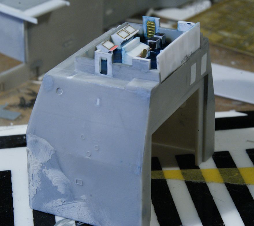

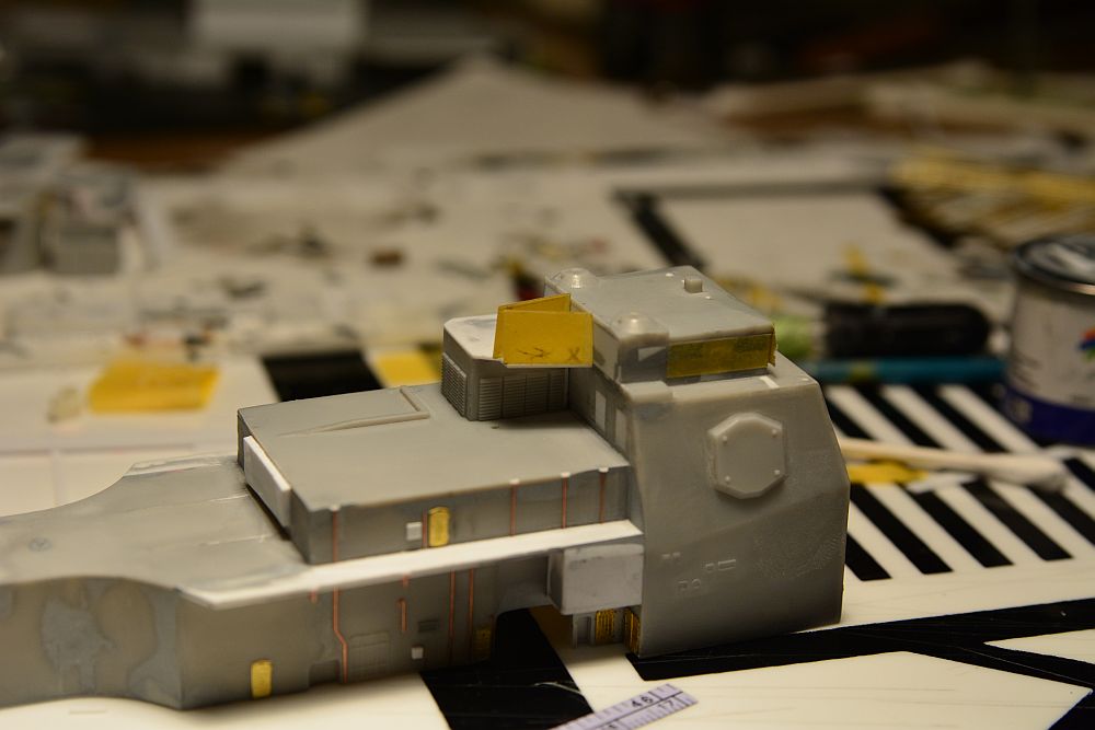

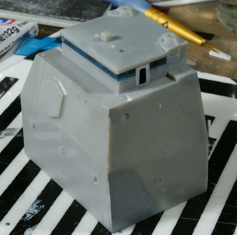

Yes, the rumors are true, I build other things than the USS Nimitz (1985-86)! I know, I need a minute to sit down too... Here is the proof that I am actually working on another ship!! Although I promised myself (and the forum members) that I won't start a thread until there is enough progress to report, a few people already asked me to post some pictures of this Vincennes. So against my better judgement,: here it is, and you will all have to excuse me for jumping all over the subject, for I do not have ANY sections completed, and I am jumping from bow to stern on this project, depending on my mood and how many Red Bulls I had.

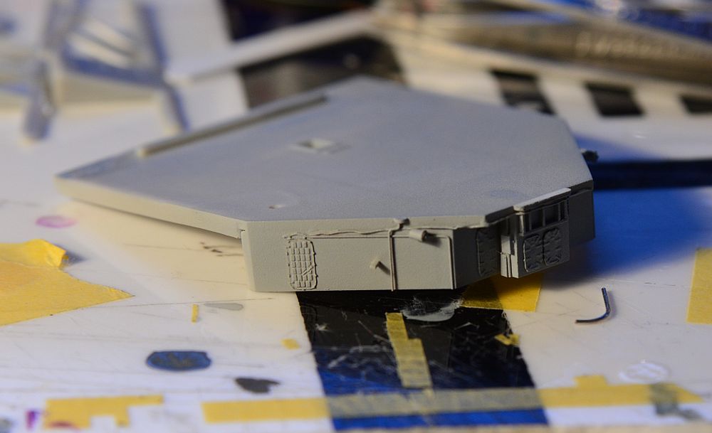

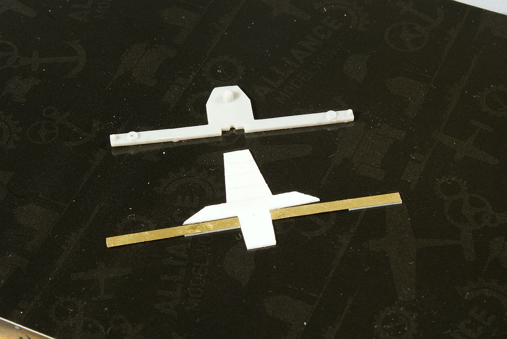

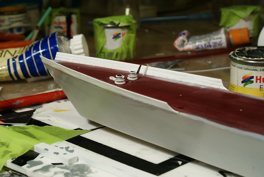

GETTING STARTED: I started on the bow bulwark, because the designing and building of this section was super challenging and fascinating! I tried to imitate the different thicknesses they use on the real ships for the vertical reinforcement plates. ( the last 5 towards the stern are bigger and thicker). Before sanding this whole area flat, I marked the location of all the details with a tiny drillbit, because -as I mentioned- all the surface detail is in the right place. Unfortunately about 70% of the details won't be installed until completion of bigger sections and the painting of the deck.
