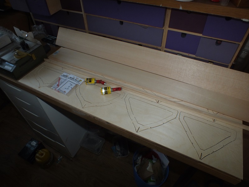

The second sheet contains the midship ribs.
This photo shows the lime sheet for skinning the hull and balsa wood block for the bow and stern sections. Also shown are the two RS385 motors that will be installed later.

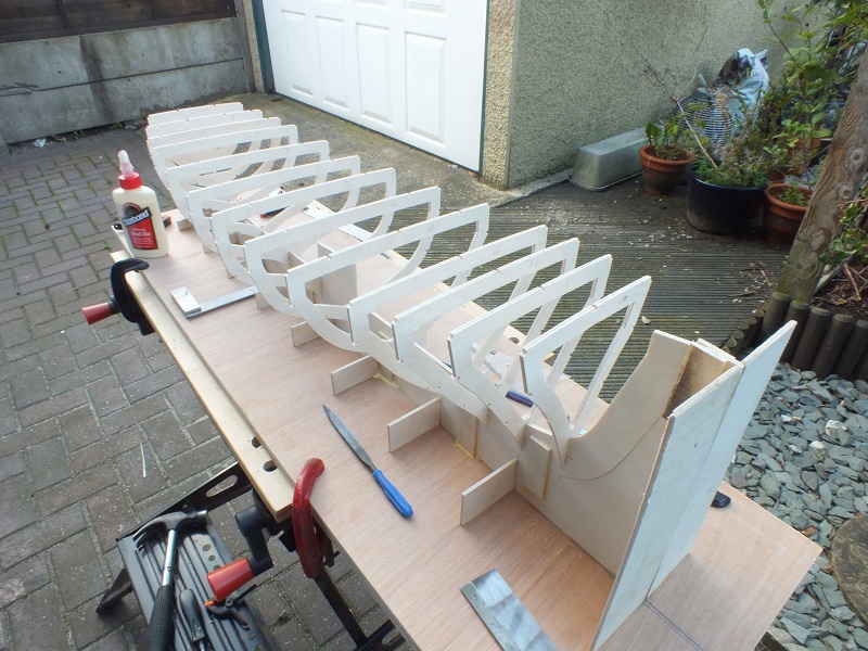

Starting with ribs four and five each one were slotted in place both side of the motor mount and checked that they were perpendicular to the building base with the engineering square. Once happy with the fitment they were removed, glued in place and checked again.
Moving out from the centre each of the remaining ribs were fitted, checked and then glued in position.
