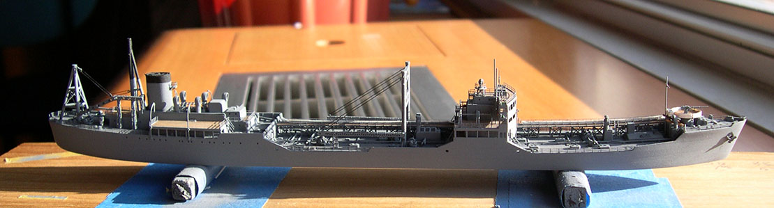

Yeah. I didn't think this project would be this complicated. More detail updates coming this week. Here's a teaser, the current state of Kyokuto Maru:
