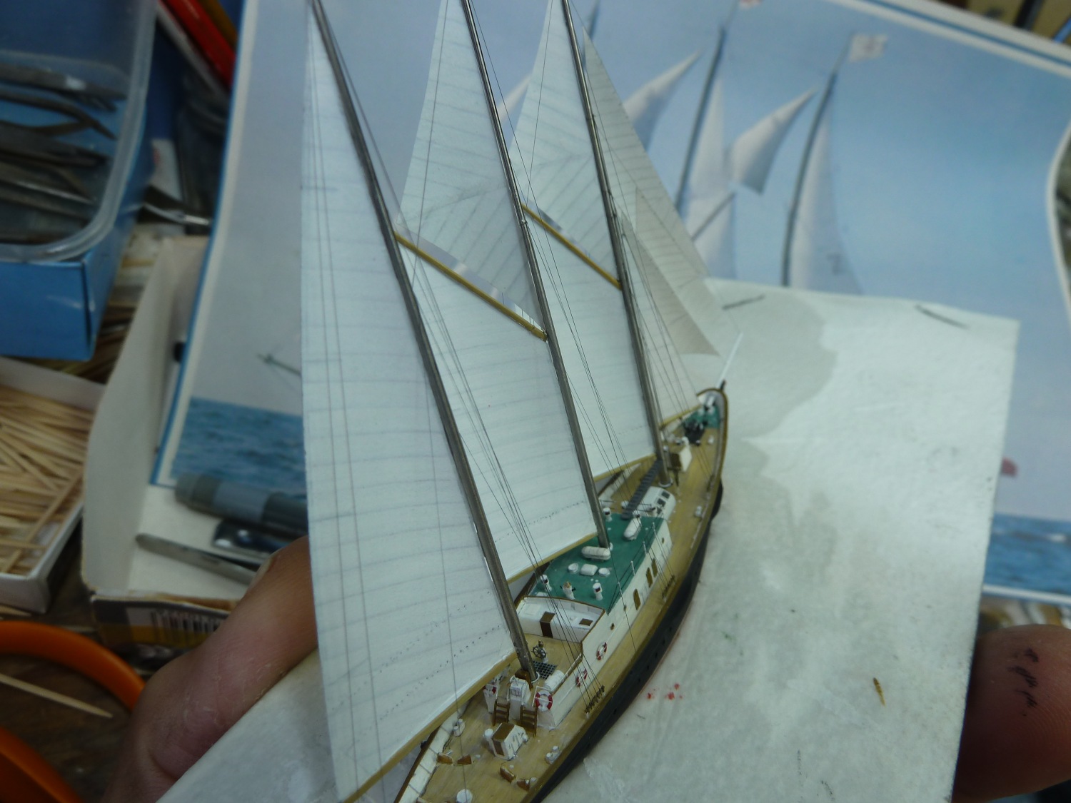

Getting the desired set and twist into the sails was carried out by using a clean cylindrical tube and pressing this onto the sails on-top of a post-it note pad , repeatedly rolling back and forth until the shape started to appear.
The biggest issue had was of getting the large number of head sails to set on their stays without sag or kink.
Wire would be the obvious material, but I was worried that if kinked once it would be irrecoverable
I used the .oo3 line from' Uschi von Rosten' for the stays, set up with some degree of tension ( thankfully my masts are made of stainless steel
( masquerading as anodised aluminium)!!! and they were up to the job and showed no sign of deflection.

The sails were tacked onto the stays using thinned white glue ( Hi-Grab) an then thin CA dabbed on at intervals.
The only problem I had was getting the sails to set at the correct angle, as the stays were free to ' rotate '
and the relative torsional loads of the weight of the sails is considerable.
Fortunately I hit upon the idea of using the slack windward sheets--if made of wire--to support the sails in their 'set' position
I plan to make the( in model-form non-load-bearing) leeward sheets and much of the non structural rigging, halyards etc
with stretched sprue a per my usual methods.

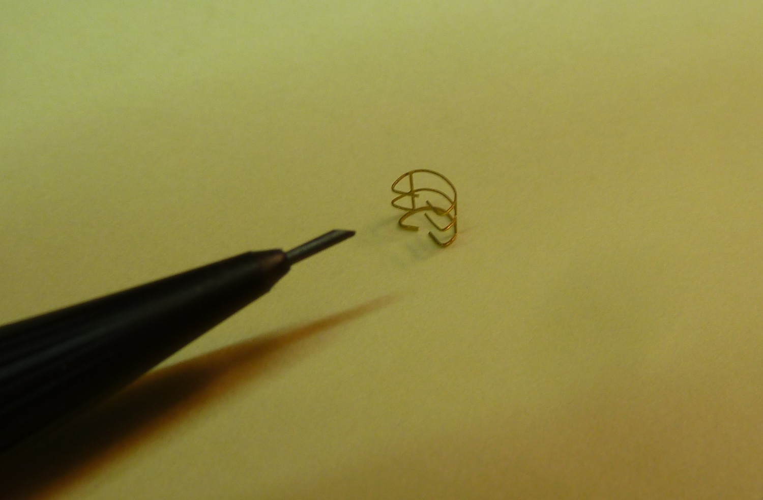

The lookout platform/ cage on the foremast
was made by carefully shaping a piece of thin-3 bar railing
This was --after test-fitting-- painted silver/aluminium
and installed without damage to halyards, though with frayed nerves!

encs a picture of todays trials and tribulations....
the running backstays -unusually had two mast take-offs-- 7/8 and 3/4 of mast height
the split again with a cascade pulley
darn tricky in small scale !!! my outer shrouds of stretched prue alas suffered quite badly due to tweezer interference... (!!!!)
(aka my clumsiness !! ) :cool_2: so more rigging of these again..!

I made these using a brass PE square ( cut from larger railing ) -backed with paper
-to which were added the larger edges aft and bottom made of strips of thin paper
These were NOT mounted to the shrouds as they would be angled upwards,
but in real life were upright and had struts supporting them off the coaming
I used some PE railing glued on from behind and then glued this to the inboard edge of the timber capping strake
The lanterns were made of brass tube, a small dollop of white glue to fill the top hole ( painted brass later )
with a very small strip of black decal to simulate the lens
the end result was not entirely displeasing.
