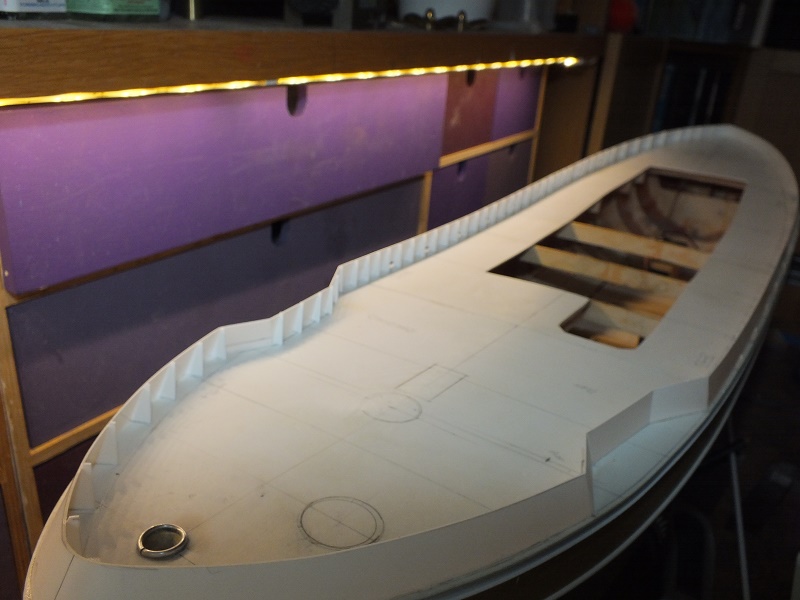

Down each side of the bulwarks are nine wash ports so the positions of these were marked onto the deck as taken from the plan. To make it easier to construct the side bulwarks I decided to divide them into three sections each containing three wash ports. More cardboard was used to get the correct curve of the deck and transferred on to the plastic sheet. This was then cut out and shaped to fit on to the deck at the correct angle. Once happy with the fit the wash port locations were marked out on the plastic and then filed to shape with a round file for the corners and finished with a flat file along the top edge. The bulwark section was then glued in place and left to set whilst working on the other side of the hull. At this moment the bulwarks are not cut to the correct height but have been marked and the excess will be removed later.

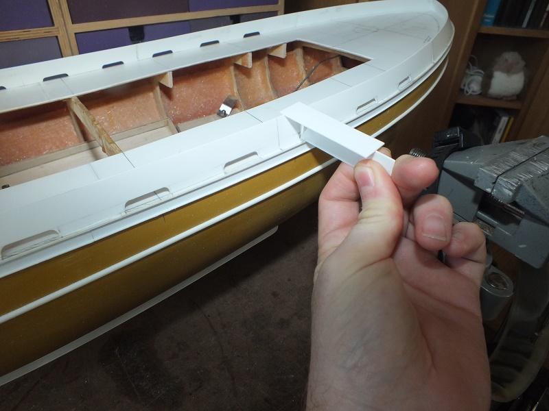

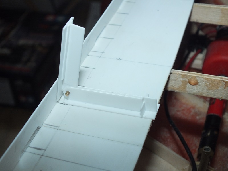

With the bulwarks now fitted the next stage was to fit the numerous stanchions on the inside. Using various reference photos the position of each was marked out on the deck. To obtain the angle of each stanchion relative to the deck a simple adjustable tool was made from plastic sheet which was placed against the upright bulwark. The tool was then transferred to a jig, also made from plastic sheet and the angle marked onto a strip of plastic. The angle was then cut and the back edge marked with a set square and also cut. The stanchion was then glued in place with liquid cement. The whole procedure was then repeated for the next one and so on.
