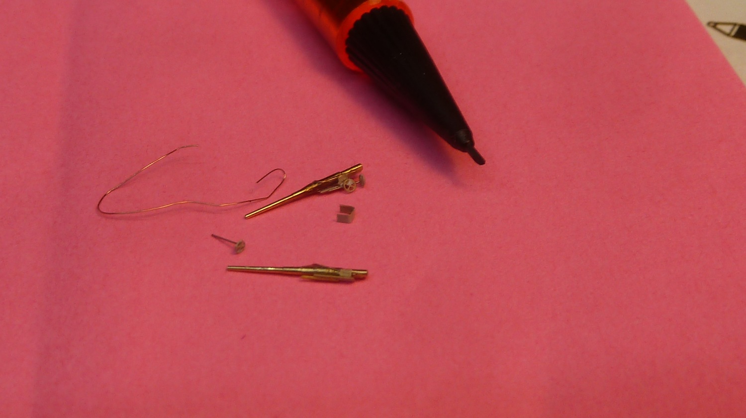

I therefore elected to try and make them -- as I interpreted the look from the photos and also from images of the builders model
I used some NNT 1/700 15 cm german gun turned barrels that I had in stock
15 cm is roughly 6 inch in 1/700 ==> ergo a quite happy 3 inches in 1/350 :cool_2:
The crux of the look was the flared ' sleeve' double around the mounting-- its swept curved shape is very distinctive
I made this of very thin brass wire as the rear outline, I then then made the 'sleeve'
simply by backing white glue up to the wire--which conveniently self-levels

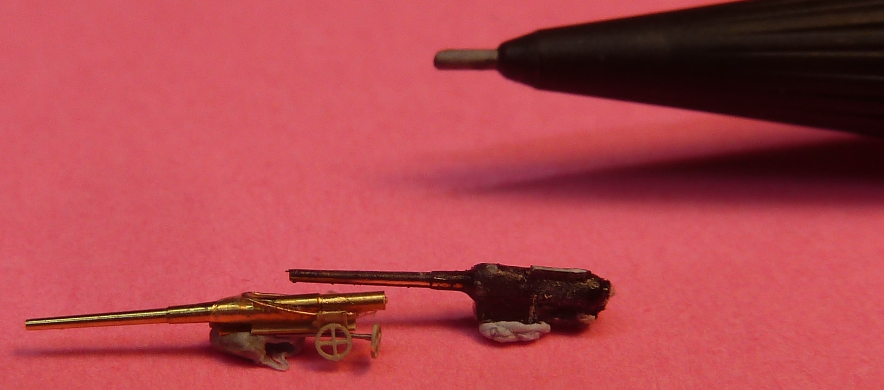

I had briefly experimented with installing a gun barrel in the kit casting-- but it was not to my liking
