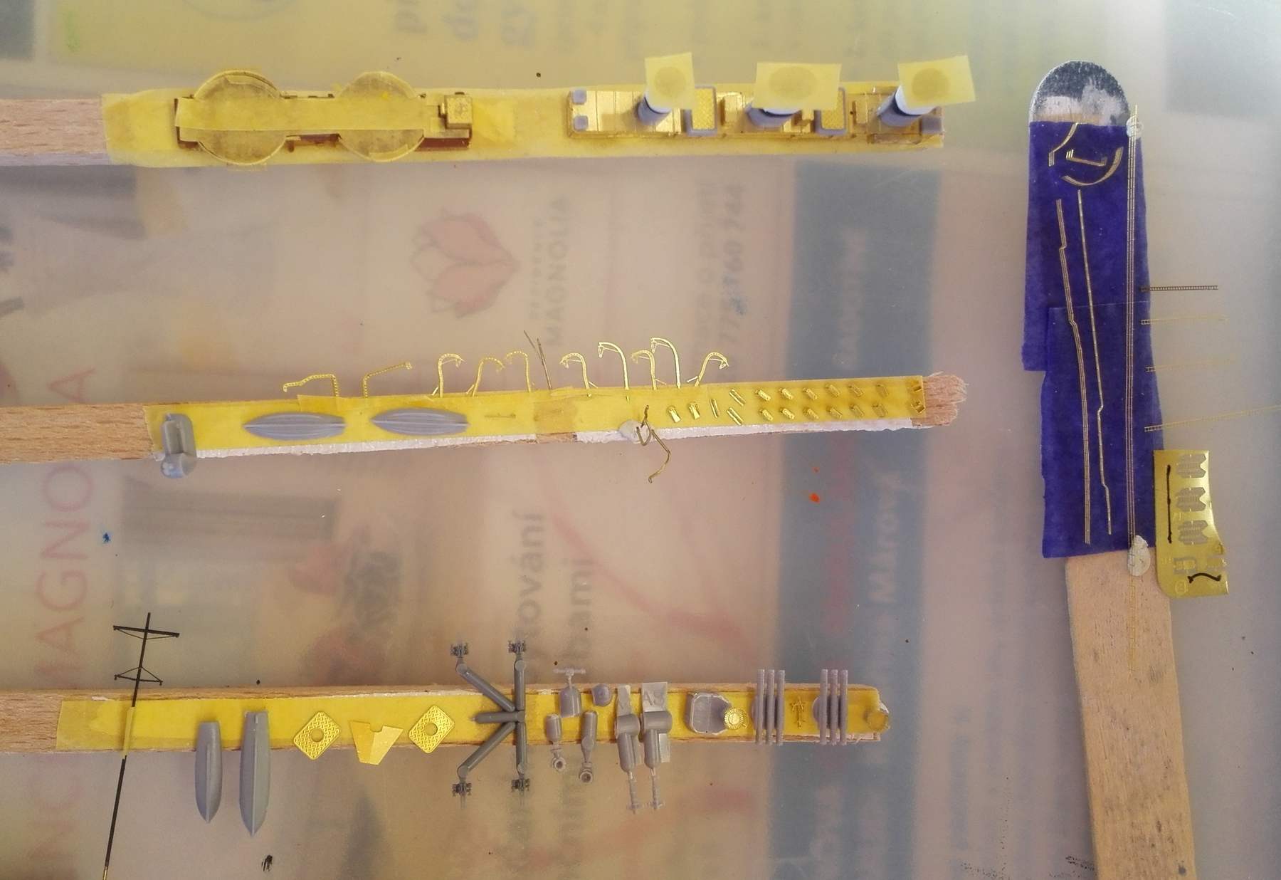

Just adding a few WIP shots here for Filip (Fivi_1241) to illustrate what I used - and what I didn´t use - of the FiveStar set.
