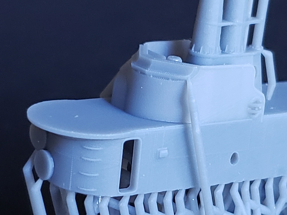

Thanks to Tom and others, two different 3D-printed Balao class fairwaters are available in several popular scales.

Right down my alley! I just have a question or two. At this time, the only other 1/72 Balao parts are from Nautilus or Iron Bottom Sound. I have only ever worked with resin, (Iron Bottom Sound specifically...). How does the 3d printed material hold up in detail versus the previously mentioned companies, and is it harder to work with than resin? Thanks

Best modelers who have one in hand answer the question regarding detail. Here's a post by modeler Walt Haynes: viewtopic.php?p=704266#p704266
And from David Waples: viewtopic.php?p=704395#p704395
3D-printed parts are a bit of a different animal than resin with respect to finishing, but in some ways better (no casting block to remove, no casting bubbles, no voids to fill, no warping). See: viewtopic.php?f=4&t=161086
