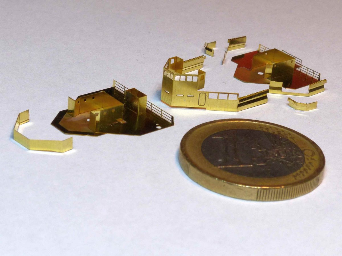

SO ..... I´m back here again after a long silence. Apart from being busy at work the reason was also that I wanted to improve bridges and some other parts of my Chicago. Not being particularly good in scratchbuilding I decided to try designing these parts in PE. I omitted more general parts that I have already got from various manufacturers (like catapults, railings, cranes) and concentrated rather on parts specific to my build and also some other parts that I lacked in the past (like parts for the SOC-3s). I ended with a full 145x95 mm PE sheet plus SOC-3 replacement wings on an extra piece as they did not fit into the large sheet. I am not fond of messing with chemicals so I had it produced professionally by Hauler. I think my first attempt looks quite good - with the exception of one part that I failed to attach properly to the sprue so it was lost during production.

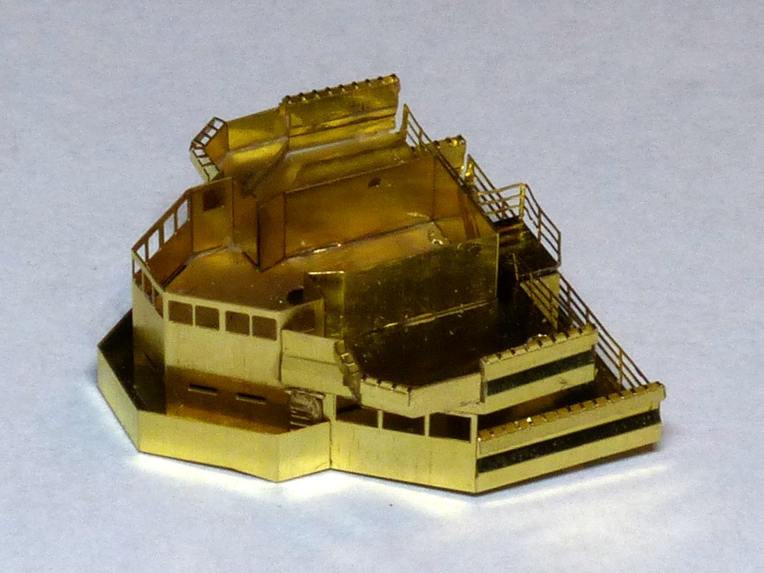

Now it´s time for some testing :) I started with the bridge yesterday. Not 100% perfect yet, there´s an unpleasant error in holes for the aft two parts of the tripod mast (not seen here) but I think it´s not bad for a first attempt.

Finally a dry fit on the hull:
To be continued (hopefully soon) ;)
