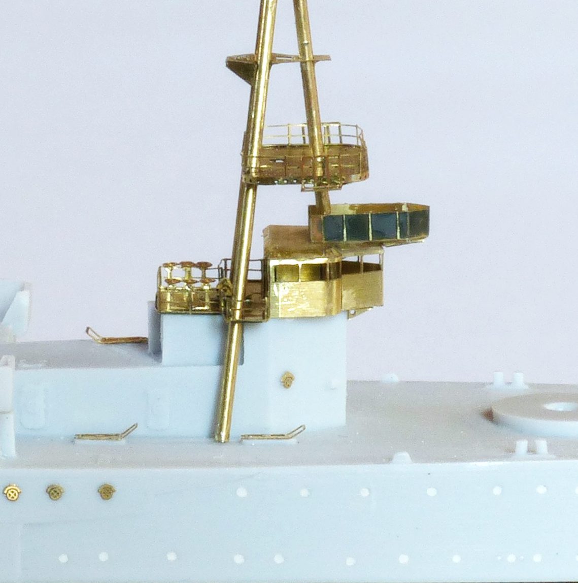

PostPosted: Tue Feb 26, 2019 2:35 pm
Online
Posts: 770
Location: Czech Republic
Continued on testing the superstructure. Two more levels of the forward bridge came out as expected.
The roof of the aft bridge ended up a bit smaller than needed so it will have to be slightly enlarged for the next attemp. Other than that seems to be ok :)
I wonder what the two triads of turning wheels seen on the aft bridge platform were for. These appear once again on the 5in platform above the hangar. Does anybody know?

PostPosted: Tue Feb 26, 2019 3:01 pm
Posts: 1611
Location: The beautiful PNW
Great work! The wheels control the cranes. The ones you have there are for the boat crane and the hangar ones for the plane crane.

PostPosted: Tue Feb 26, 2019 3:27 pm
Online
Posts: 770
Sounds logical, they are really close to the crane. I don´t know why I haven´t thought of that!
Thanks!

PostPosted: Wed Apr 17, 2019 9:37 pm
Posts: 577
Location: Peach State
I don't know how this is affected by your brass, but the reason for the height of the catapult pedestals is due to the catapults themselves. They were designed to allow for etched catapults that were available at the time on the resin base, and how either end of the catapults related to the forward superstructure and the hangar platform.
Regarding the two sets of hand wheels. Just on speculation and since there are two sets, I'm guessing they control the rotation of the catapults and not the crane.
Nice work with your etch so far. I hope you don't get too far ahead of yourself so you have trouble painting inside the compartments.
Mike, I think the cat pedestals worked just fine with the original resin catapult train rings. With PE (0.1mm thin in my case) their height should match the forward superstructure (less that small recess), that´s why I had to increase them.
I don´t think this was the case as these wheels were definitely present also near the boat crane aft:
19420201 USS Northampton firing 8in against Wotje NH 50944.jpeg [ 278.04 KiB | Viewed 1451 times ]
Interestingly enough, the 1942 LIFE photos of Northampton show the wheels present near the aircraft crane:
19420300 USS Northampton bridge looking aft from Life via FB Radio.WW2.jpg [ 179.68 KiB | Viewed 1451 times ]
... in case of Chicago they were definitely missing there in 1942, see below:
19420722 USS Chicago underway to Guadalcanal-Tulagi NARA 80-G-13462 crop.jpg
19420722 USS Chicago underway to Guadalcanal-Tulagi NARA 80-G-13462 crop.jpg [ 230.38 KiB | Viewed 1451 times ]
Perhaps they were removed when this crane was refitted? The aircraft crane on Chicago in 1942 appears different than on pre-war photos. On the other hand, I can´t see them on pre-war photos of Chicago either (haven´t checked Northampton pre-war though).
