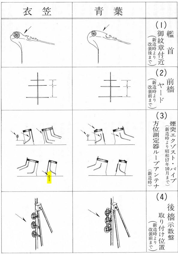

As I am now getting ready to do the piping on funnels that distinguished Kinugasa from Aoba, I noticed the following other differentiator that I overlooked previously (marked yellow):
Drawing Kinugasa (left) vs Aoba (rt), Maru Special #38.jpg [ 71.64 KiB | Viewed 1882 times ]

Here that feature looks to me like a detachable chute, not attached permanently to the hull side. I consulted this with Dan K and finally decided to omit this in my build at all for lack of better resources. If detachable, it would presumably not be there in wartime conditions (as I intend to depict Kinugasa at sea in the middle of the Savo Island battle) anyway. I still don´t know what that item shown in the Maru special sketch was but I´ve probably got no way to find out exactly.
Your ideas welcome!

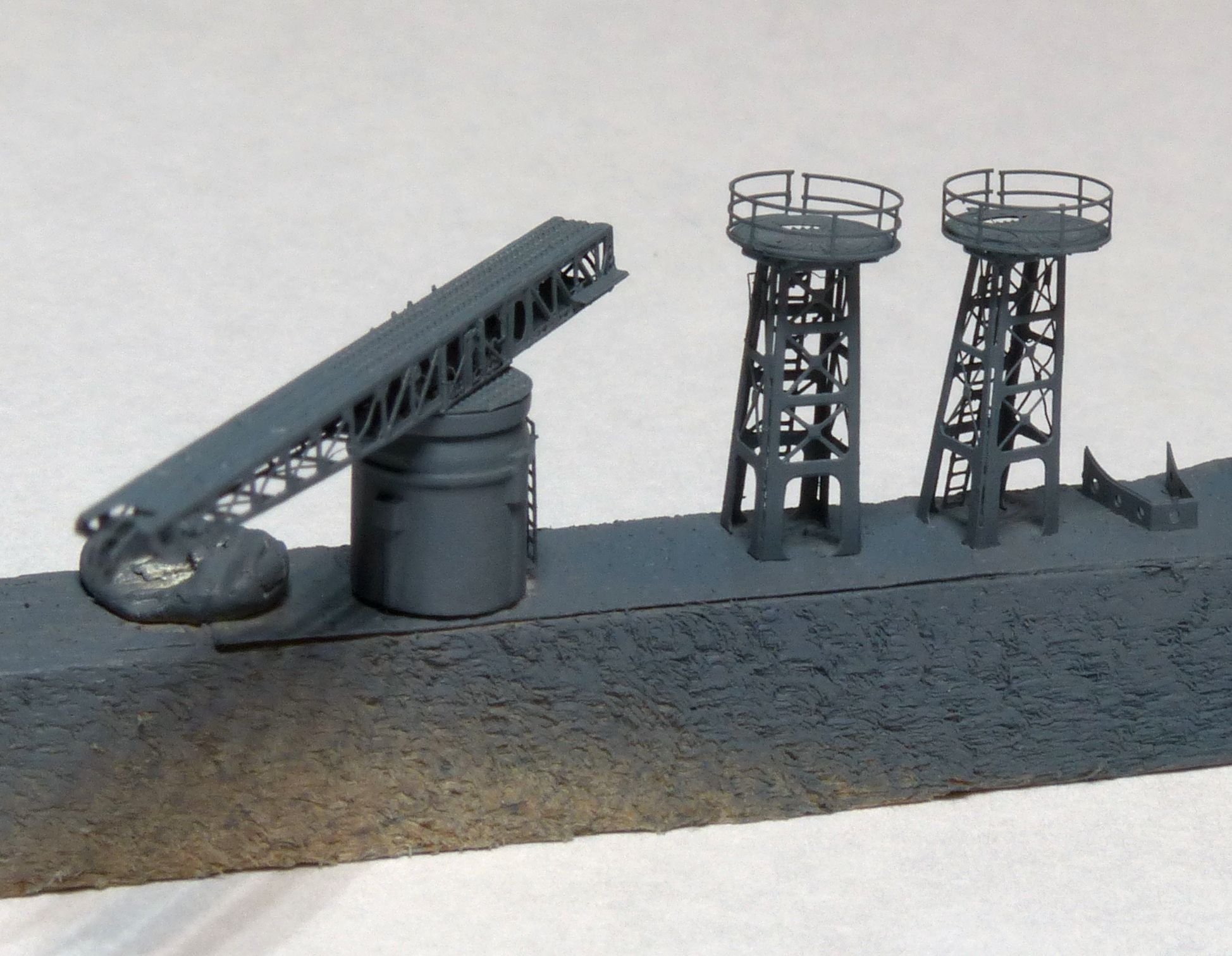

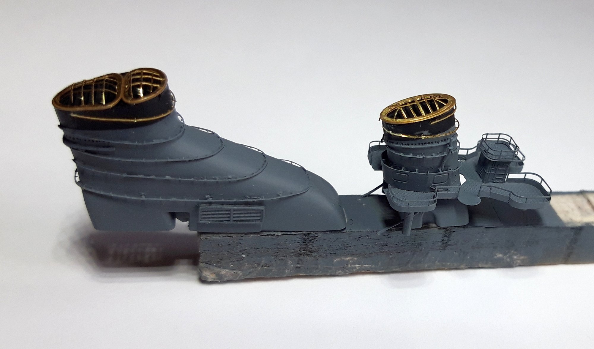

My take on the searchlight towers is that these were rectangular in cross-section on Kinugasa - as opposed to the Furutaka class, where these were triangular. My assumption is based on the photo below, I think triangular would appear different on such a close-up photo.
