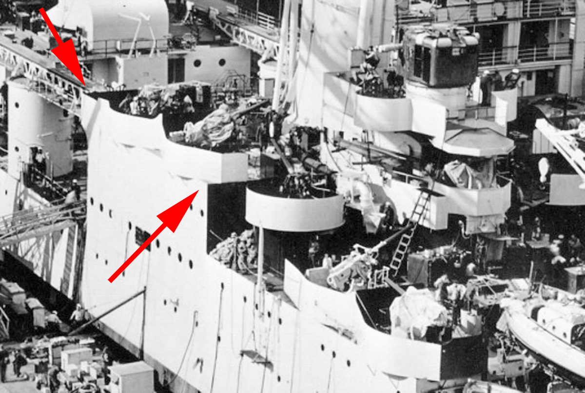

For the matter of documentation of earlier steps: I realized the original kit part for the upper 5in deck was not really correct. Photos show the arrangement of splinter shields at this level was clearly different than in the kit both on Chicago and Houston, see photos before and after amendment below. They came out not exactly as intended (it would have been better to remove the shields entirely and replace them with brass stripes) but they are still better than before.
Also the tubs for 1.1 in quad guns were actually not located at the exactly same level as the upper 5in deck, so I had to separate them from the 5in gun deck and decrease the height of their underlying superstructure parts. It is not eaxctly clear to me yet how exactly the situation looked like at the back of these tubs, but apparently their back was open and there was a ladder that connected them to the lower 5in platform below and the other one above. There were slight differences between individual Northampton class members and I have not find any clear picture showing the situation on Chicago, so an educated guess will have to be used here.
19400910 USS Chicago Mare Island navsource 0402909_cr.jpg [ 315.87 KiB | Viewed 1352 times ]
