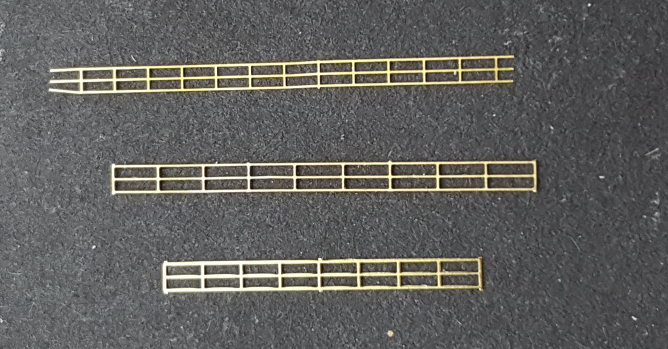

OTOH, the Fujimi PE railings are a very pleasant surprise. My personal standard for 1/700 IJN railings continues to be the Gold Medal Models IJN Ultrafine set. At 0.03” thickness, it’s as close to scale as seems possible for a PE railing in 1/700.
The Fujimi set is 0.055” thick, but they have used this width to provide strength while minimizing the height of the individual bars. So, from a horizontal perspective, the overall appearance is very close to that of the GMM Ultrafine rails. Conversely, the Artist Hobby railings are 0.04” wide, but formed in the more typical way, appearing thicker on the height of each rail. A comparison is shown below.
