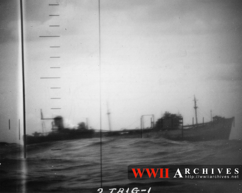

There was one more variant of this type, built by Mitsubishi, Yokohama for Showa Shipping. This was the Nissho Maru (sometimes spelled Nissyo). While based on the same dimensional hull, she was more aerodynamically shaped, resulting in a very aesthetically pleasing superstructure. Many considered her the "prettiest" of the tankers.
While not apparent from her TROM, it appears she was equipped for UNREP capability. She was sunk by submarine attack in early 1944.
Interestingly, a 1/700 assembled version of her in pre-war livery has just been released. The model seems a little crude, but it could probably be improved with a little work. Model photo courtesy of HobbySearch Japan. See this link and click on "List All Images" for better views: http://www.1999.co.jp/eng/10446886

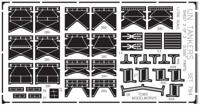

First look at the new PE, with two quick component build-ups from Rich. It's an impressive set. Instructions not yet completed.

Rich Harden is tweaking a couple of things, but the set has been placed up on the Tom's website.
I spent a little less than two hours yesterday assembling one of the new PE bridges for kicks. I used one of the 16C faces. I can't believe how nice it came out, or what an improvement it is over the kit.
The engineering is fantastic. Using 0.005" brass for the bridge faces was a very smart decision. My only error is that I left too much of a dip in the deck for the compass bridge deck roof. If I had been in less of a hurry, it would have worked out better. Still it can be disguised with the railing that needs to be put in place. I recommend taking your time and conducting several test fitting before gluing the various PE decks in place.
I temporarily placed it on my Shinkoku Maru for demo purposes. I made one tweak in the kit part not covered in the instructions, as exemplified in Photo A, removing some plastic to allow another set of the windows on the bridge face to open up. Nor did I remove a piece of the ship's side as recommended by the instructions (see Photo H) which would allow installation of a piece that includes support posts for a bridg edeck. DOing so would also open up more of the side windows in the PE part.

Looks like a vast improvement, Dan. How difficult do you think it will be to mate the forward catwalk with this assembly? Would it be easier to install the forward catwalk and then install the forward superstructure assembly? Were the catwalks designed with extra material on the ends to make adjustments to the lengths of the catwalk runs easier?
I hope you're not sick of these tankers yet. Your input will really make a difference on this fret. Do you think anything was missed?
PostPosted: Sun Jul 08, 2018 9:47 am
Posts: 8835
I think the superstructure has to go in first.
Yes, there is 1.5-2mm extra material at either end, so adjustments are possible.
Well, I am a little burned out on these but, as you can see, I've started puttering again on Shinkoku Maru for now. I don't think Rich missed anything of consequence. He made a couple of smart decisions upfront about what he wanted to see in the set, parameters were set, then he/we set about fitting as much as possible into the three frets. When a sixth bridge face option turned out to be superfluous, that opened up the space for the fender bases, which I thought a very inspired choice on Rich's part. (You won't find those anywhere else.) Also using thicker brass for the bridge faces makes a very big difference in term of handling, construction, etc.
Some minor things didn't make it, like a canopy framework that goes above the engine skylights in front of the funnel. Also a large intake grill at the back of the "deck house" in front of those skylights, though one would have to scratch-build a frame for that. However, these are very minor tweaks. The idea was to work with the kit as is as much as possible. There are some recommendations within the instructions about how to improve upon some of the kit parts if the modeler wants to make the best use of the PE parts. For instance, increasing the size of the kingposts.
The set design and execution by Third Floor Annex was also very impressive.
