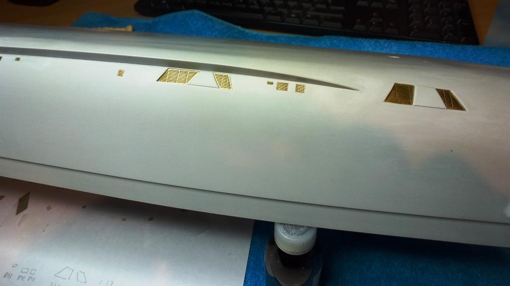

The hull:
Pictures are showing different modifications made to the hull. Water in/outlets in the lower hull (PE-kit) as well as small spill water outlets along the waterline (made from brass tubing).
The reason for all these “holes” in the side (and not the bottom) of the ship seems to come from the fact that the ship has only marginally less depth than the Nord-Ostsee-Kanal, the strategic channel between the Baltic and the North Sea. To avoid sucking rubble and sand into the cooling systems most openings are on the side of the hull.
is this modification worth the effort: Well, very little of this is seen when the hull is finished.
Small outlets for spill-water etc are found along the both sides just above the boot-topping. 0,6mm tubing were inserted in drilled-out holes in the plastic.
All portholes are drilled out in 90 degrees to the hull sides. Since all portholes are made 90 degrees to the horizontal, some are not round at all. Portholes are of course 90 degrees to the ships sides, so do fill those original holes that are inaccurate with putty and drill new ones!
Then, use white glue into the holes and let dry, after all painting is done, of course: and there you have your glassed portholes.
File comment: Ready for launch: Note position of crane and it's rollers (turned forward and down to clear catapult for the Arado
