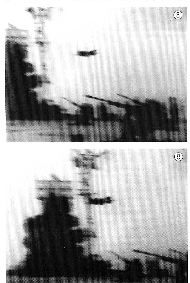

A video shot of the bow by one of the starting airplanes of Zuikaku.

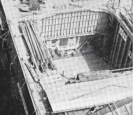

FWIW, I did a great deal of research for my Taiho and Hiryu wells. The documentation is a little sparse, and there is some variation betweeen types, but I feel that what I have created for my 1/350 Hiryu remains a fairly accurate representation of the wells themselves.
Even this diagram for Junyo doesn't match 100% the reality. There are large support pillars beyond the guide rails at each corner that seem to help anchor the whole shaft where it meets the hangar decks.

For my Amagi, I also had to construct part of the elevator wells. In addition to the Junyo pic, I found these 2 pics of Kasagi useful too:
And zooming in on the last pic:
Steven, the verticals you have constructed are the guide-rails for the counterweights (the rectangular blocks in between them in the first pic). To their left and right (towards bow and stern), there were support pillars to anchor the elevators at their 4 corners as Dan explained.
The other photo shows that the exact location of these varied, even in one ship, as did the finishing towards the flight deck. I think this was at least partly because of the varying shapes of the elevators: the counterweight guide rails and support pillars can only be located where the elevators are at maximal width.
Anyway, great work on the elevator wells so far Steven! :thumbs_up_1: :thumbs_up_1: :thumbs_up_1:
But one more thing: as you see on the pics, you will need to add a solid wall behind the mechanism too, and counterweights between their rails. When the elevators were down, these counterweights were up and thus visible. They were attached at the top with cables.

Some quick comments, though not about the camo (yet):
I would caution against placing too much reliance on the appearance of the elevator wells from the CVLs. They were typically placed at the far ends of the hangar (also like Taiho) deck, with one end running up against a bulkhead. So, for some reason, as often as not, there is a certain assymmetry to the underlying support structures. See the Shoho pics below. The CVs had one or more elevators that opened onto a hangar deck on either side, necessitating a stronger supportive structure where the hangar and flight decks interfaced with the well.
The diagram above is from the Gran Prix Shuppan volume on the IJN CVs, and is is definitely for Junyo.
Shoho elevator well during conversion, 10-41, SOTW V248, p23.jpg [ 99.44 KiB | Viewed 5229 times ]

Regarding the mast shadow in that overhead pic:
I believe it is a shadow, given that Zuikaku's island throws a shadow in the same direction. Note that Zuikaku's yardarms had been re-arranged after a bomb hit damaged the mast at the Phillipine Sea. Where as the yardarms had originaly been horizontal and perpendicular to the axis of the ship, they were subsequently angled back and slightly upward, in the same manner as that of the Unryus. This would account for the dogleg shadow, along with a flag. and the Type 13 radar up there.
