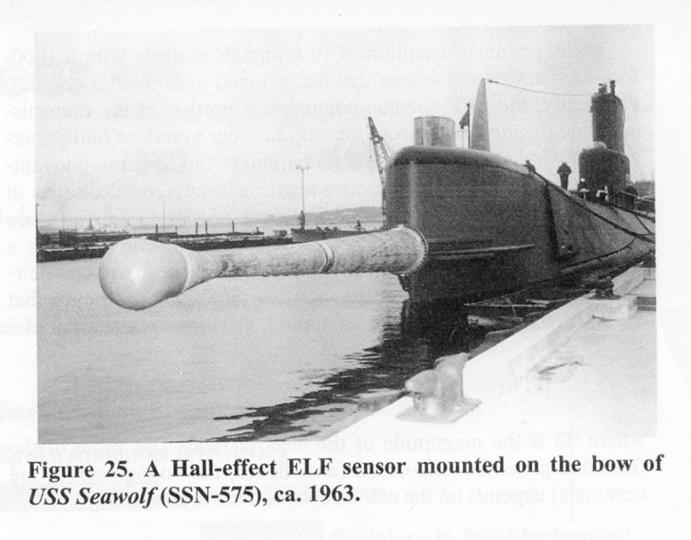

Jacob,
Unless you were a Submarine Sonar Technician, don't believe everything you read online; the majority of the information is inaccurate or just plain false (fas.org and Janes --especially where sonar suites are concerned). The same holds true of the wacky, wonderful world of CNO Special Projects platforms. I was fortunate to be involved with both of these subjects, so I speak from (decades of) experience. I guess that makes me a living fossil. . . or a witness to history - which sounds a lot more palatable. For authoritative sources, Polmar is hard to beat. I've seen him make very few errors where sonar is concerned. Submarine sonar is a tough subject to get right, owing to many systems spread over many classes of boats, and scarce documentation in the unclassified realm.
Moving on, the BQR-2 used a circular array of hydrophone in 48 staves. There was an experiment to mount an array on the back of a submarine sail with mixed results due to high flow noise. The BQR-2 and BQR-7 were the primary passive submarine sonars throughout the late 50' to early 70's for a number of boat classes - the "S" girls that followed the Seawolf, and all of the 41 boomers until back-fitted with the BQR-21 (with the exception noted above). As a circular array it was always mounted low - inside a chin mount on boats that had them, and below the torpedo tubes on boats that didn't. The BQR-4 (and BQR-7) were conformal arrays. That is, they conformed to the shape of the hull, and were placed higher (basically U-shaped, so the baffle areas were large.)
The BQS-4 I pointed out above, (as opposed to the SQS-4 you mentioned) was the primary active search sonar when the Nautilus was decommissioned. And that IS the BQS-4 console in the photo - I sat in front of one longer than I care to admit, hoping to see something. (I rarely ever did.)
The ultimate forward arrays were Spherical, (AN/BQQ-2 sonar suite in the 60's, followed by the BQQ-5 in the 70's and BQQ-6 in the 80s.) These allowed for D/E (depression elevation) determination (up/down) so a target signal could be detected using it's bottom bounce angle. (You can do a lot with that kind of acoustic information.)
Towed arrays were a major game-changer and have evolved continuously since the BQR-15.
And you are correct - the BQR-3 was installed topside on the Nautilus/Seawolf in the early days. The Wolf did a lot of experimental testing in the 60's. (See the attached pic.) The Parche didn't carry the BQR-2, but had a BQR-21 topside/aft, as I mentioned. She left service with a BQQ-5 suite, which replaced her obsolete BQQ-2 system. The Q-5 was an awesome system. The Q-6 integrated every sonar, (Underwater Telephone/ Acoustic Emission Intercept / Bathythermograph and Towed Arrays) in a common system to a greater degree, but did not have transducers in the spherical array, just hydrophones. (Boomers aren't in the business of pinging.) The Q-6 sensor integration experience was highly useful for the systems that followed.
There has NEVER been an accurate model of the Seawolf portrayed anywhere in her Projects configuration that is accurate beneath the waterline. In drydock, a curtain that conformed to the hull was lowered as the drydock was emptied, protecting her modesty. An armed guard (MINSY PD) was posted outside the underbody curtain. Even they weren't cleared to look behind the curtain. Anything you see online or read in a book is pure speculation, fantasy or garden-variety BS. The same rings true for other projects boats. As long as inaccurate info is available, the truth will always remain protected. As it should be.
If the Navy ever declassifies the physical characteristics of the multiple Projects boats that have come and gone over many decades, I'll likely be the first to create and post accurate 3D depictions online. (I've posted a few submarine renders in the Virtual Ship Modeling section.) But until that day appears, myself and all who were/are involved swore and signed an oath to STFU, and for the most part, everyone has. A few stories have emerged, but the level of detail is astonishingly weak due to their minor involvement and limited "Big Picture" access. I can promise you, that there will be a lot of discredited so-called "experts" who will be most embarrassed when the real stories emerge - if ever. And the real stories are the stuff of movies, starring ordinary people, placed in extraordinary circumstances, backed up by a cast of hundreds of unacknowledged patriots.
Until then, keep in mind that those who know, --don't talk; and those who talk, --don't know.
CCC
