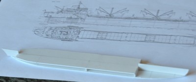

I have some very good general arrangement drawings to work from and shipspotting can help me out if I am missing things. So I started by using the drawings and pictures to work out some basic sections.
And the first plastic has been cut. More tomorrow.

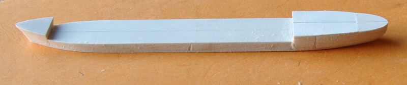

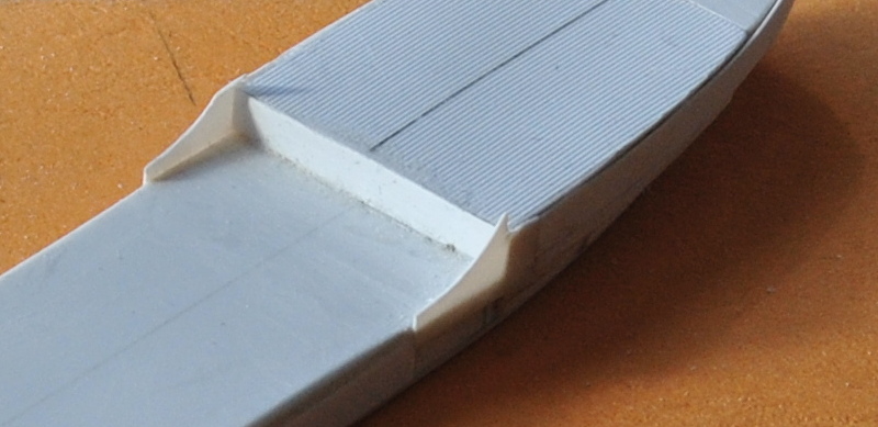

Next step, filling in the sections with balsa wood and adding the decks. As usual I am using .5mm styrene for the steel decks and evergreen 2020 for the planked decks but on this build the main deck is somewhat heavier at 1 mm as I will be working in the round edges of this deck later.
And some cutting, filing and sanding later it looks like this. I try not to use any filler in this phase of the build.

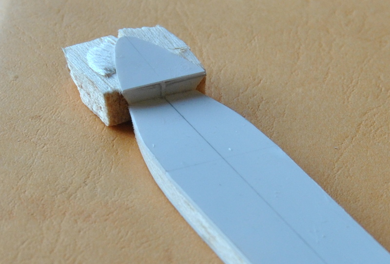

This week I have started the hull plating. Most of the hull was done with one 4mm wide styrene strip which was carefully sanded to confirm with the round deck edge. And i managed to damage the first parts of the poop plating almost as soon as I had added the parts. Oh well.

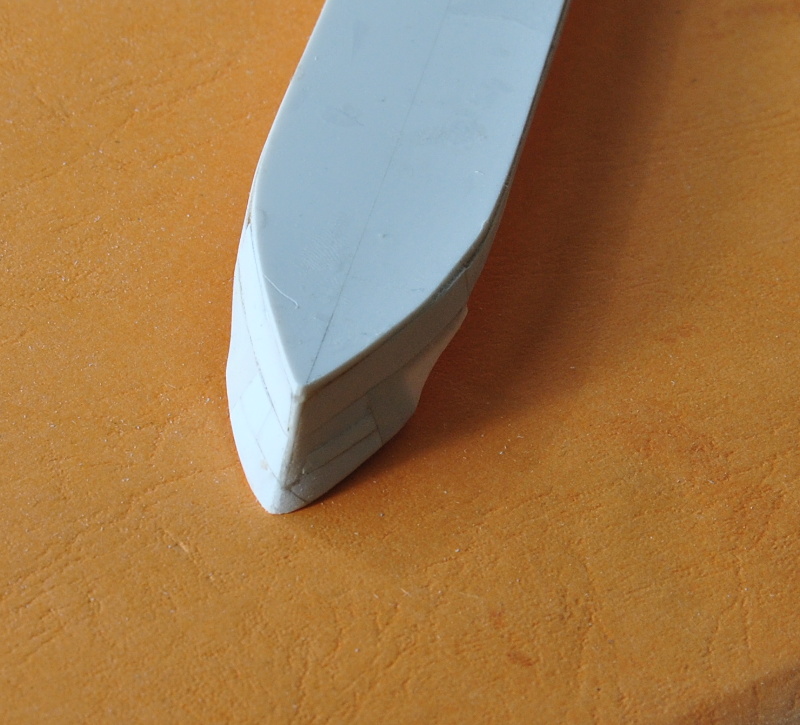

Most of the week was taken up by the stem though. A rolled plate stem is always tricky to get right so I tried something new. I folded the styrene strip diagonally across the stem.
And after that it was filling, sanding and filling again. Will need some more work. I'm getting close to the original shape though.

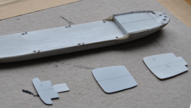

Up next were the bulwarks and their supports. All that beautiful 1960s streamline meant no jigs as no bulwark support has the same length or is placed at the same angle. But the result does look nice I think.
PostPosted: Tue Oct 20, 2020 6:20 am
Posts: 1554
Irish Cedar had some rather prominent fairleads on the main deck. After adding these the hull was ready and it is set aside for priming. I did a little parts count for the hull. 178 parts so far.
I have cut my first styrene for the superstructure.
And the other superstructures. Five big McGregor hatches which means five rather complex multi part machines which have to look exactly the same. I have an Amati chopper which I will use a lot this week I think.

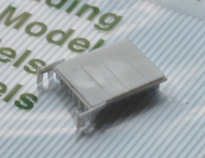

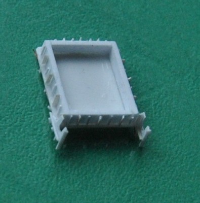

And so, after finishing 5 of these creatures at 56 parts each...
I went to the local hobby shop and discovered that Evergreen makes some really nice metal siding for railroad models that would have saved me more than half the work.
Anyway, the hatches are now ready for a coat of primer and at a parts count of 458 I have started working on the superstructure. Owners'cabin first.
