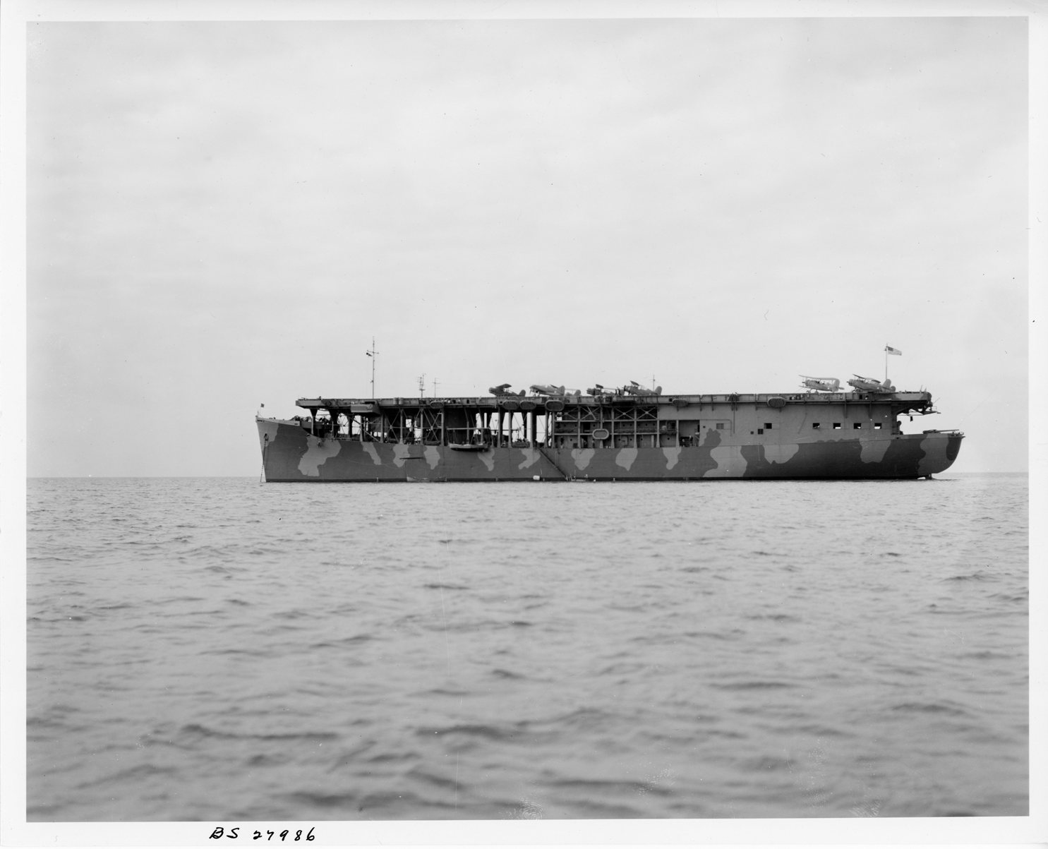

PostPosted: Thu Oct 25, 2018 3:51 pm
Posts: 8342
USS Long Island, October 1942
PostPosted: Sat Oct 27, 2018 10:18 am
Joined: Tue Jan 06, 2015 5:28 pm
Posts: 101
Thanks for sharing these. I'd like to know what those two box like structures under the fwd flight deck are.

PostPosted: Sat Oct 27, 2018 10:50 am
Posts: 238
Location: SE Michigan
she had bridge wings for the pilot house near the forward end of the flight deck on each side. The rest of her superstructure was amid ships with the flight deck built over it.

PostPosted: Sat Dec 08, 2018 10:10 pm
Joined: Sun Oct 14, 2007 11:18 pm
Posts: 35
Location: Lone Star State
Martin,
Great pic you posted. Not sure if you have it inany higher resolution but would love to know what side code on the F2A-3 is. I believe that the date is probably Oct 1941 as Long Island was pretty much an aircraft transport by Oct 1942 and her air group ashore.
BW
Brandon S. Wood
PostPosted: Mon Dec 10, 2018 7:01 am
Posts: 10569
Location: EG48
Most of those aircraft are SOCs, which wouldn't have been part of a carrier air group anyway. It's very likely she was doing transport in the picture above.
PostPosted: Mon Dec 10, 2018 7:51 am
Joined: Tue Nov 08, 2016 6:08 pm
Posts: 249
Location: Yorktown, Indiana, USA
The SOCs were assigned to VS-201, which was embarked. Long Island carried SOCs into 1942.
https://inchhighguy.wordpress.com/
PostPosted: Mon Dec 10, 2018 3:25 pm
Posts: 435
The Navsource photos of LONG ISLAND (http://www.navsource.org/archives/03/001.htm) include a couple showing a USMC F2A-3 aircraft of VMF211 coded MF-5 after a landing accident, as well as several showing SOC-3A aircraft of VS-201.

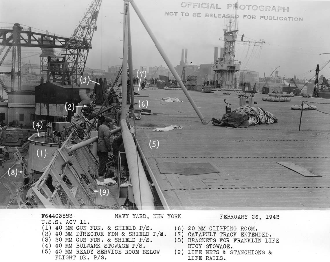

PostPosted: Tue Aug 20, 2019 8:16 am
Posts: 10569
Location: EG48
I'd say more like 60 degrees. Not all sections either, the corners on at least some were vertical and the catwalk under the aft flight deck had vertical railings since it was hanging from the overhead. I haven't done a study yet to see if this was an evolving feature.
