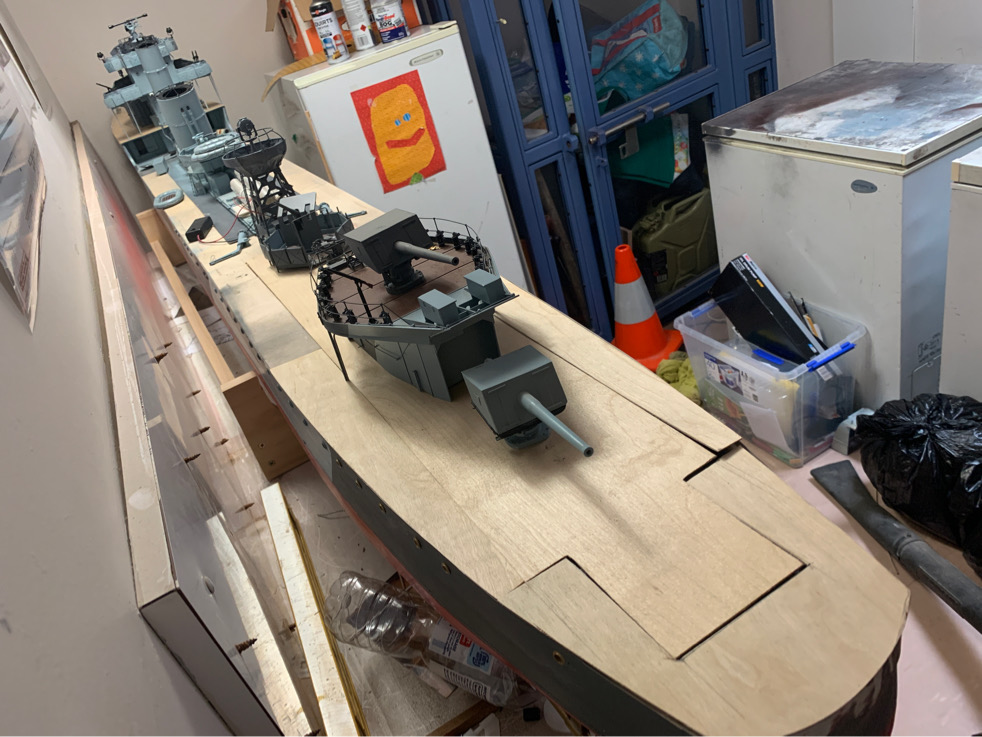

Hello all, I am still picking away at my ship when I can. I am now going to fibreglass the interior of the hull, put some steel bracing in and add some ballast. A local museum owner, Rick, who is a genius with metal very kindly cast twenty lead ingots for me to install as ballast. Total weight of them is 20kg, so I will cut them to fit at the lowest level, right next to the keel, and seal them in with fibre glass resin. I will obviously have to float the hull and get the weight right and so she sits level. I was worried what I was going to do and Rick provided the answer for me. It will add a lot of weight and I am toying with installing half, leaving other half able to be removed; adding steel rods along the keel etc. All the deck bits are stting on the charge room desk asking to be knocked off by one of my many children....If anyone has any advice with the photos attached please do so!
Cheers Will

I built a 4.5m long type 42 destroyer in 1/32nd for a successful attempt on the Guinness world record for distance travelled in 24 hours in 2002 as seen here with my main helpers. The model weighed over 300lbs when ballasted down on the water but I did not fix any ballast in it permanently, preferring to use 6 pint milk containers filled with gravel which fitted neatly in the spaces between the internal plywood keel and bulkheads. I would strongly advise against permantely fixing any of the ballast in the hull as it will make it more difficult to move the model around and substantially increase the risk of causing damage to the model or the surroundings. Keep in mind also that there will eventually be a lot of delicate fittings like guard railings on the finished model that can easily be knocked off if the model is too unwieldy when putting it in the water etc. The second photo shows how I cut hand holds in some of the bulkheads so that there was no need to hold the outside of the model when lifting it from its trailer and taking it into the water.
I would also suggest that you would be best to get all of the practicalities of fitting the RC gear sorted and working before doing much more to the inside of the hull as coming back to it later on may need you to undo much of your good work so far. Have you sorted what motors you are going to use and how they will be mounted and where you will put batteries and Speed controllers? Similarly for the rudder and steering servo and also the receiver. Sorting these now while you have as much access to the interior as possible will avoid any problems later.

Many thanks for the sound advice. I loose fitted some of the ballast that would be needed and my goodness it was extremely heavy and yes I would definitely damage it trying to move it. I live in a remote rural area with no real water nearby and it will spend 99.9% of its time out of the water so I will definitely not fix any ballast permanently. Its for that reason too that I havent really done much to install any of the radio gear and just been enjoying the detailing. But you are right and I need to address the running gear. I will fibre glass the entire interior, and install the rudder servo and motors, and work out what batteries I can put in and then ballast. The motors I have were recommended by someone sailing a similar sized vessel and he said they do just fine. The lead ballast should be really good as its low as you can go in the hull and there is alot of weight up top.
Cheers, Will
